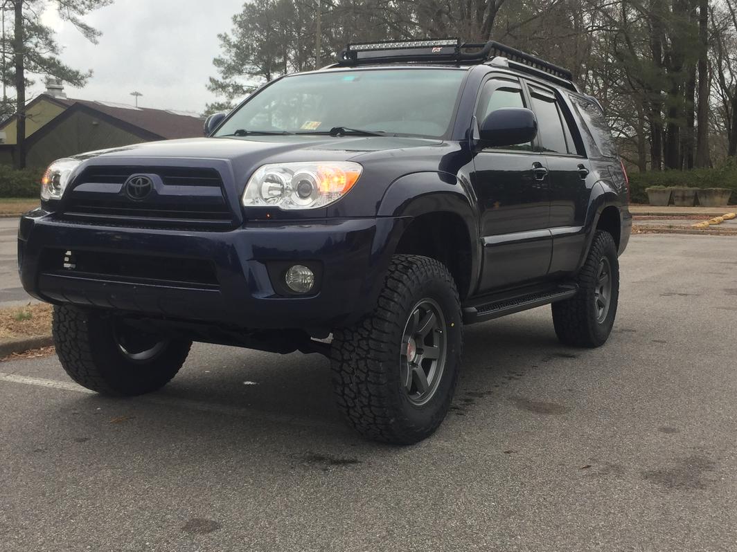

do you have rubbing issues? i have the same wheels and want these tires, but all i have for lift is the daystar 2.5/1.5 spacer lift. not sure what kind of rubbing issues i'll have
Sorry for the delay in response. I had to push the front wheel liner forward. trim a little of the front plastic fender, and remove the front mud flaps. All minor changes but afterwards I didn't have any rubbing and its not noticeable.

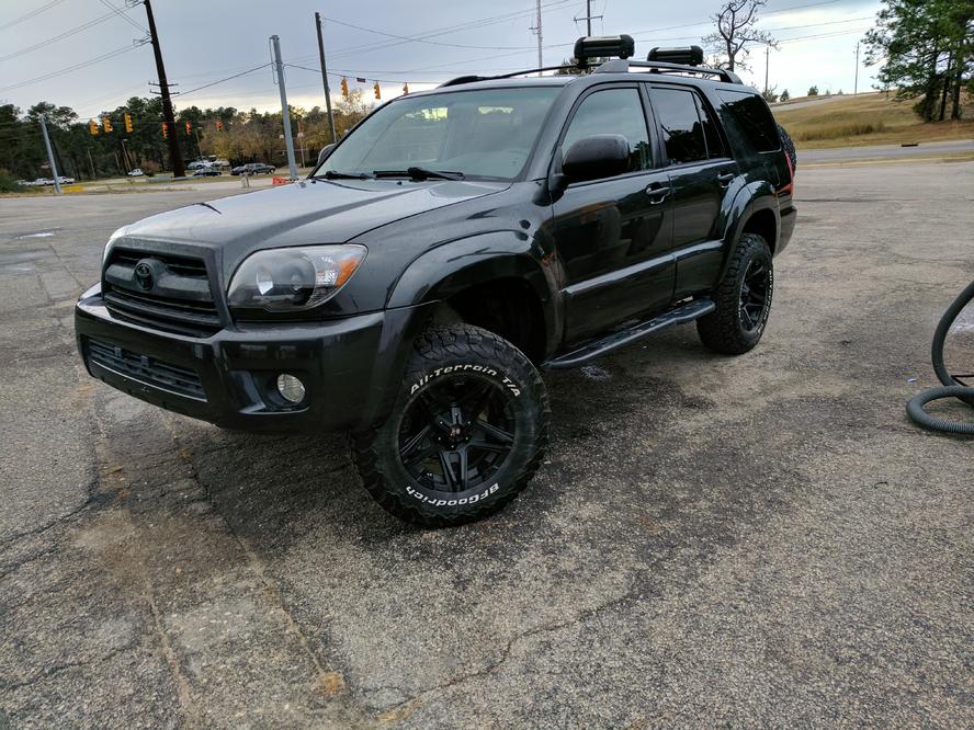

New wheels
Finally got my American Outlaw on.

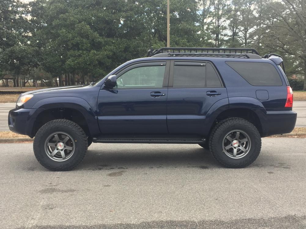

Ome 884 with spacer and 895e. Running 285/70/17 with a 0 offset. No rubbing to the body mounts. Had to take the front mud flaps and have to push the fender liner forward. Haven't decide if I should take the front spacer out yet .

Looking to see if I can run 275/70R18's on my 07 V8 Limited. Bilsteins Front and rear. Front is set to max 2.5, Moog 81088 coils (had a hard time getting my hands on Front OEM FJ springs) spc uca, Rear Springs from a FJ + air lift 1000 and 1.5'' Daystar spacer. Currently running stock 265/60r18's. Current dimensions: Front- ground to fender 36 5/8'', top of tire to fender 7 1/2". Rear- 37 3/8 ground to fender, 8" top of tire to the fender. Would any modifications need to be done to fit 275/70's and if so which ones?

YOu should be able to. I ran this size for a year, and only had to adjust the front inner fender line forward.
