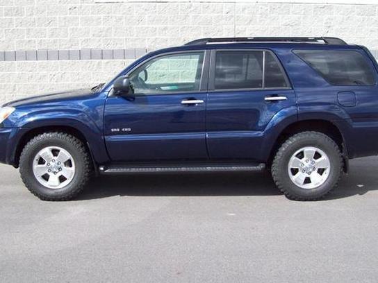

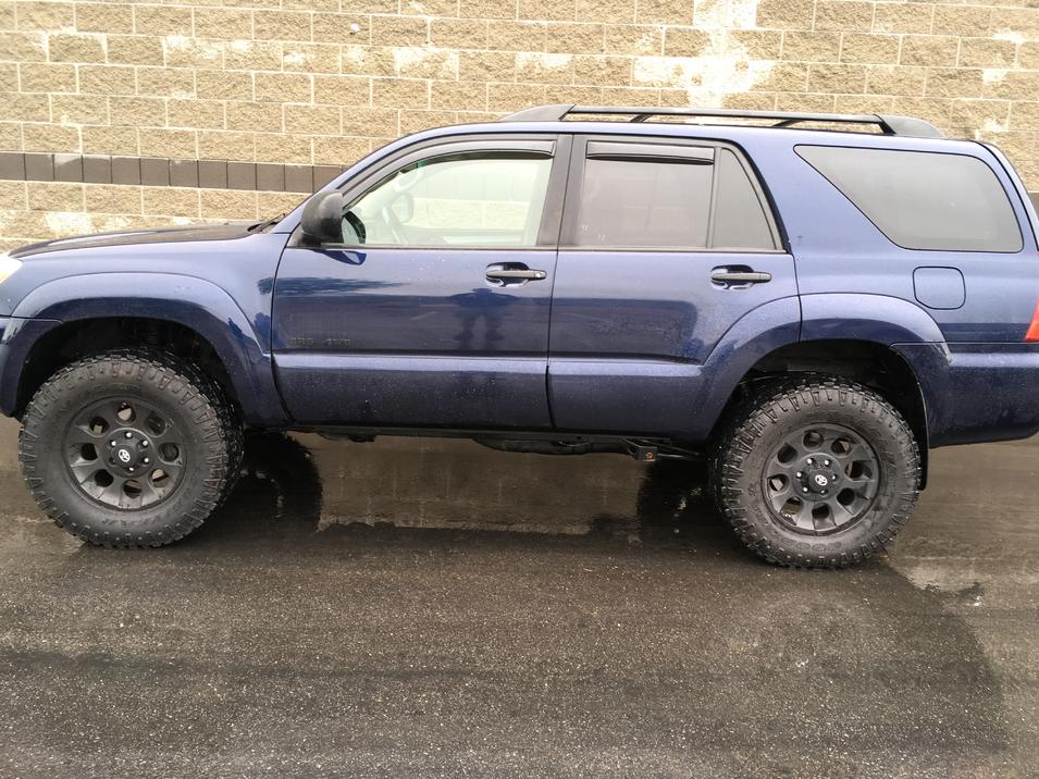

Finally got some new sneakers for my 4th gen! I went with Mastercraft Courser CXT 255-80-17,(33.1-10-17)on stock wheels and no spacers. Running a full OME suspension, using their medium springs front and rear. They just kiss the frame and the front wheel well liner at full lock. Just need to get a different offset wheel and I'll have zero rub. Tire noise isn't bad at all and they ride great for an LT tire.

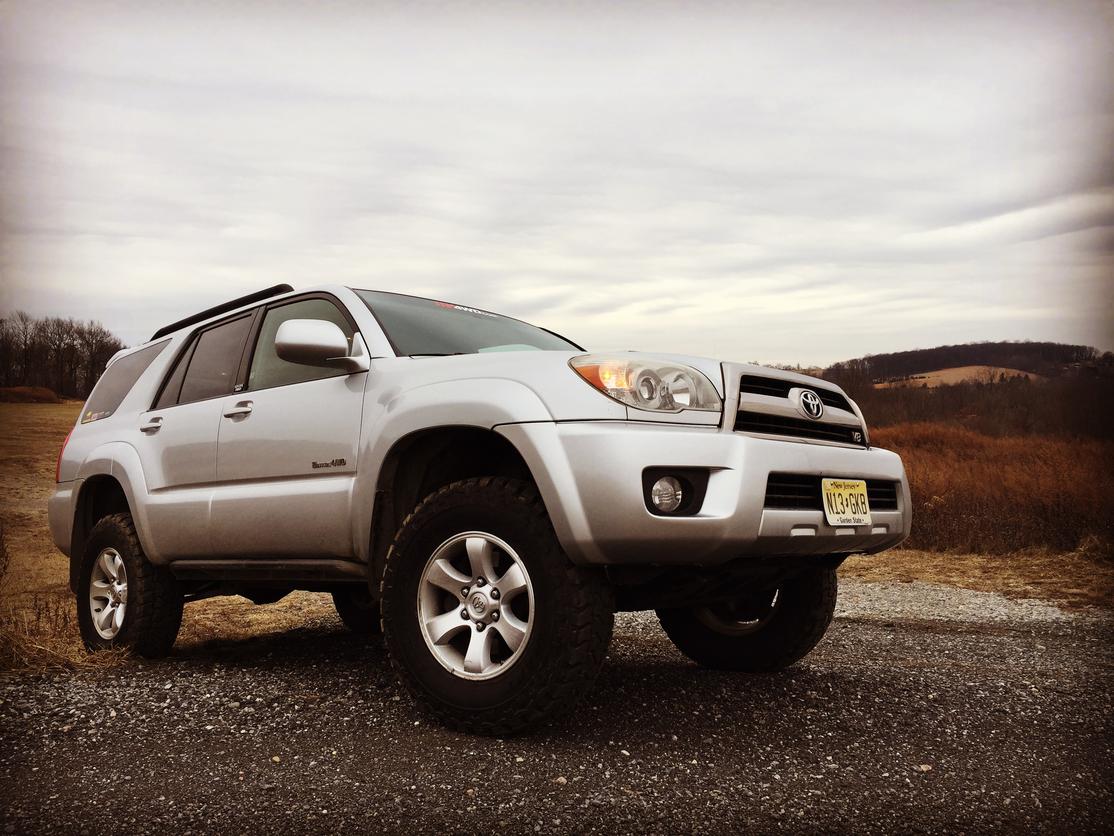

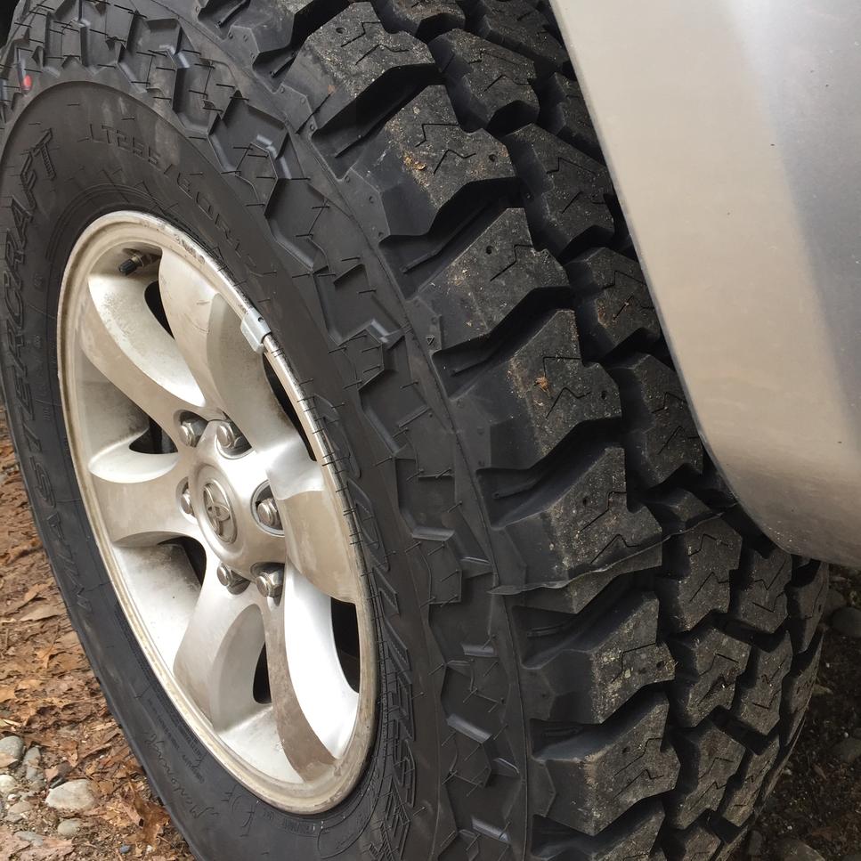

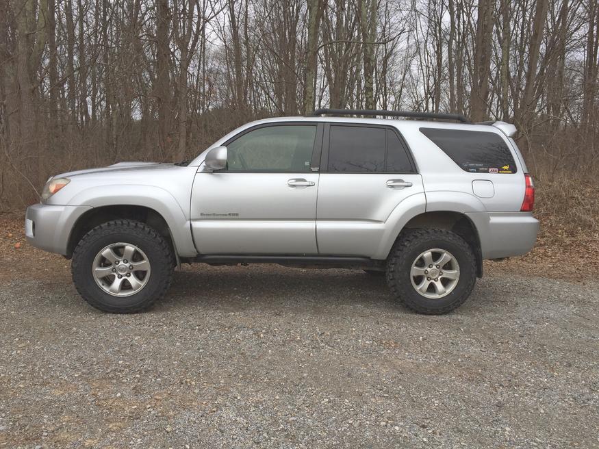

Better pics of the lift.
Front OME 885 w/ Light Racing UCA
Rear Toytec Superflex HD
Rear1.5" driver's side spacer
285/70/17 KO2
-6 offset rims
Sent from my SM-G386T using Tapatalk
Front: bilstein 6112 set at 2" of lift
Rear: OME 895e coils with toytec BOSS shocks
Wheels: method standards matte black
Tires: 265/70/17 Goodyear duratracs

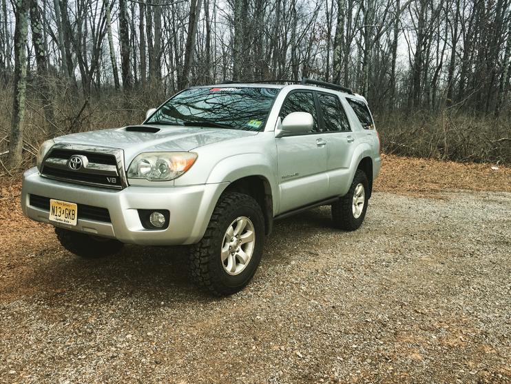

Before
After
245 ko2
