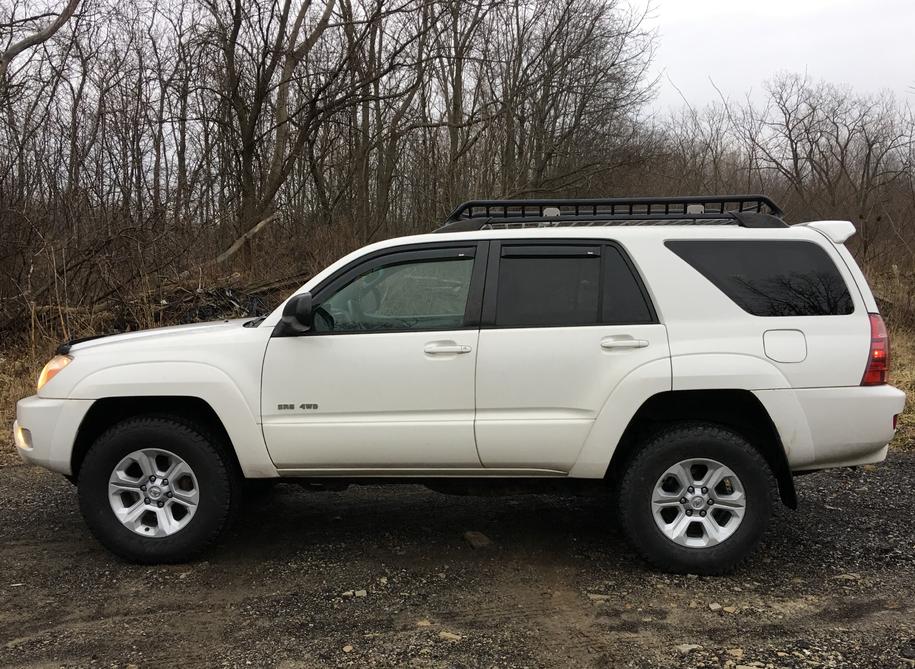

ICON Stage 1 Lift, F(x) Pro Wheels, 275/70/17 KO2, and Doug Thorley Headers

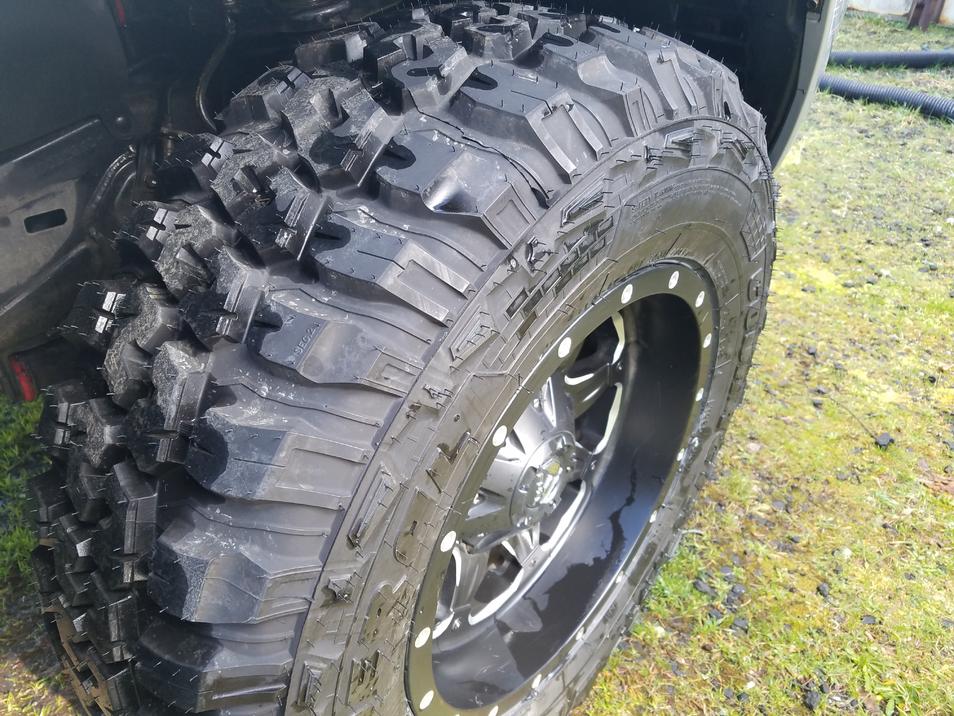

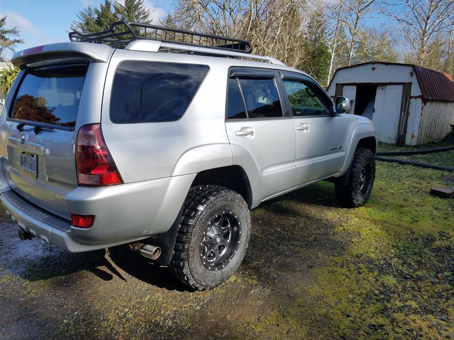

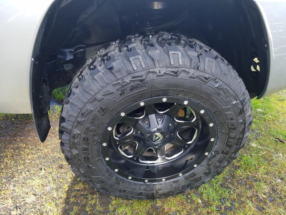

Got my new tires and wheels mounted up finally and finished my rack! 265/70/17 federal couragia mud terrains on 17x9 fuel boost deep lip wheels. The rack was a freebie but was real short so I lengthened it out "12.25 and painted with bedliner. bilstien 5100s all around going on next week. real happy with the look and for the price I couldn't be happier!

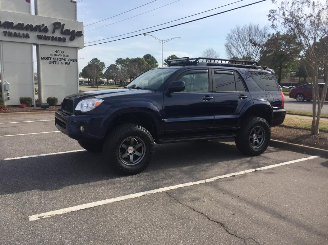

I added ome spacers in the rear it help with my driver side lean and raise the rear. My 4Runner is now level out:rockon:

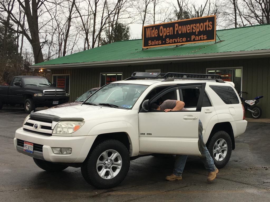

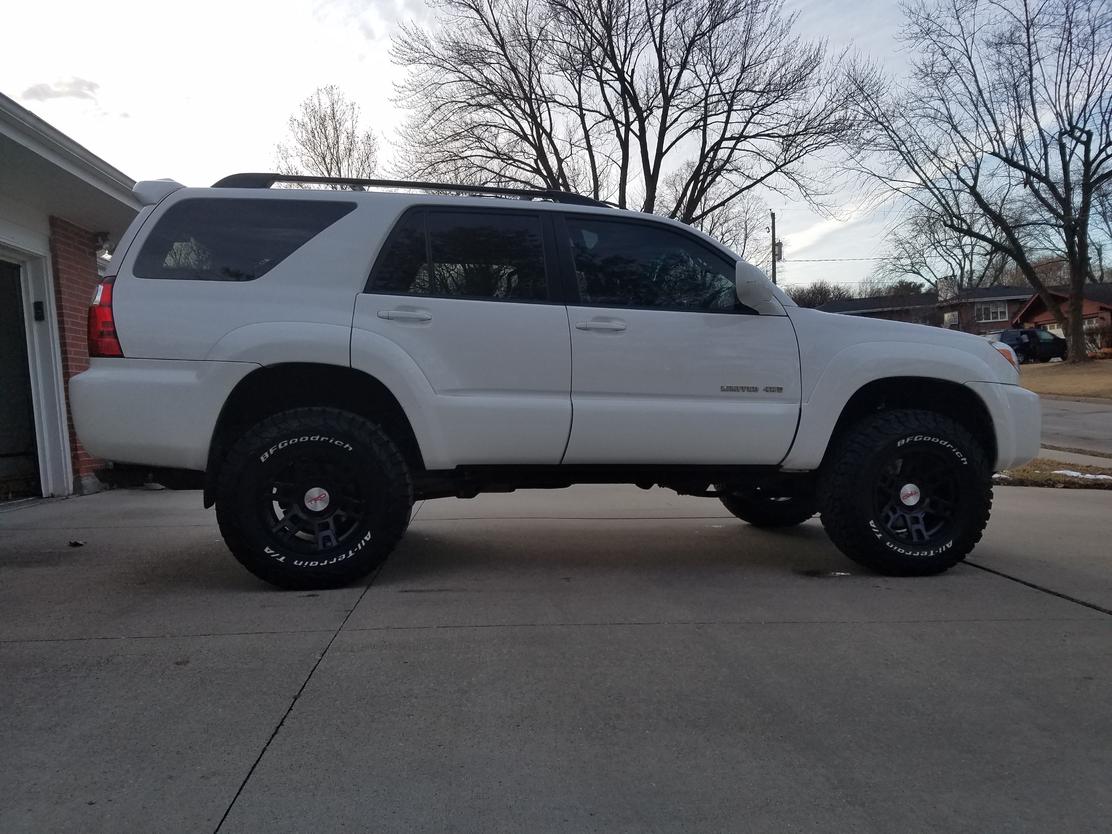

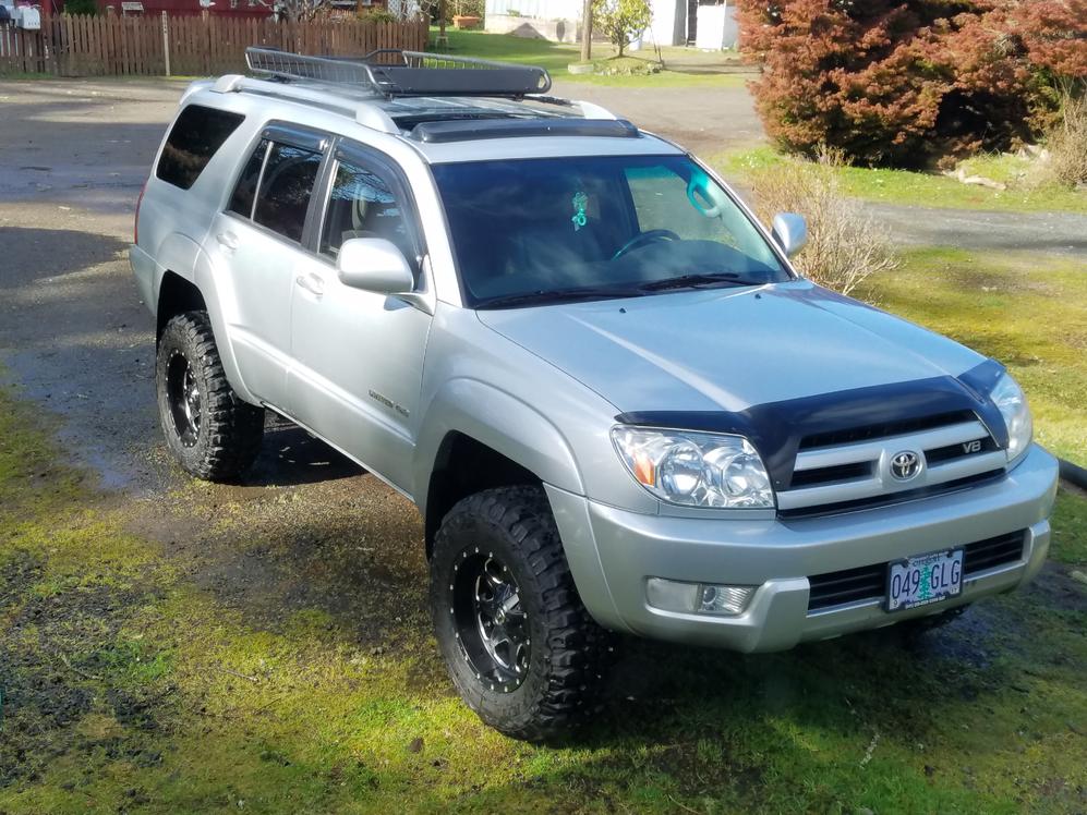

I'm not sure I've seen anyone do this combo.
Daystar 1" top out spacer on the front (nets 2") and a 1.5" daystar spacer on the back. My total "lift" was sub $90, and installation took 1.5 hours.
This combo fits 265/70/17 tires perfectly.
I wanted to keep some of the factory rake to level it when I tow my mini camper.

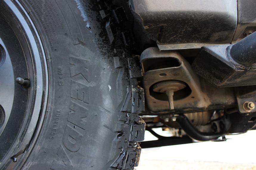

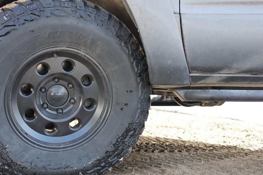

This is 2.5" front, stuffed, 285/75/16r with -16 offset wheel, almost 5* castor (part of the problem) Wheelers Superbumps and swaybars...rubs...trim...rubs...trim...rubs....
Can see in the first pic where I cut the fender so far, has actually cut the tire I was noticing.
Also I beat the body seam down (in the wheel well) and split it open a little...DOH!
Some one just posted they used a adj wrench to start to fold then beat it with a hammer, probably a better idea.

Looks like a body mount chop is in your future.

Wide tires and big offset wheels seem To make you need to do a lot of trimming. I'm running 255-80-17 33.1"x10.0x17 on a 2.5" lift and stock wheels. They only hit the front fenderliner backing up.
You can cut slits every 1" or so in the seam then smack the seam with a hammer. That'll bend them back real easy. Just make sure to hit it with some undercoating so the cuts in the seam won't rust.

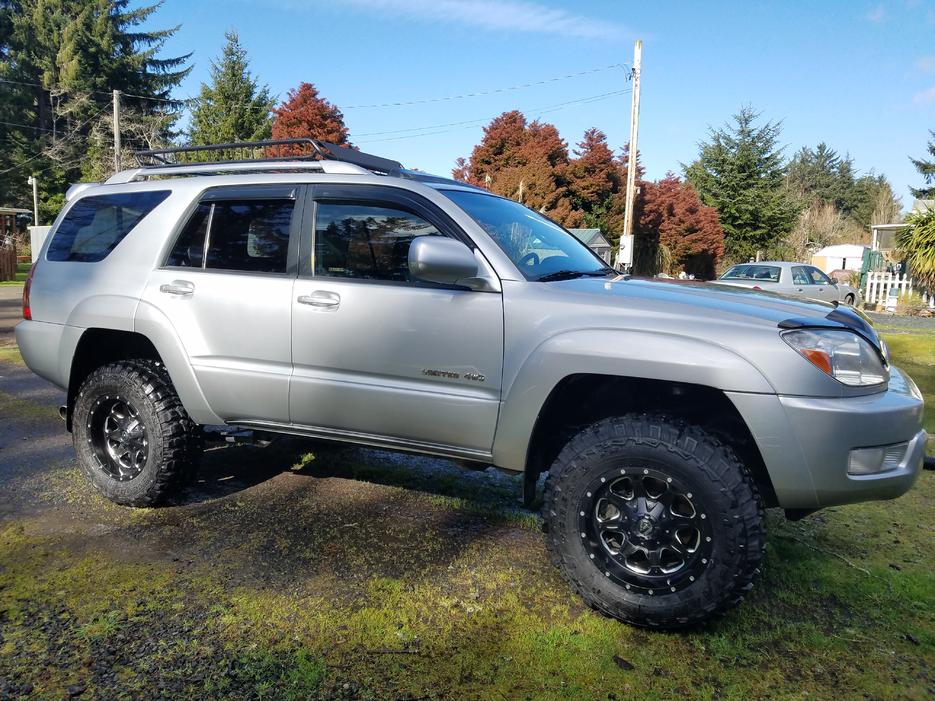

On one of the face book groups a dude just put them on. I believe he has a 3"suspension and a 1 1/2 body lift. It looks really sweet! Although I'm not sure what mods he had to do. Might have just been the fender liners?

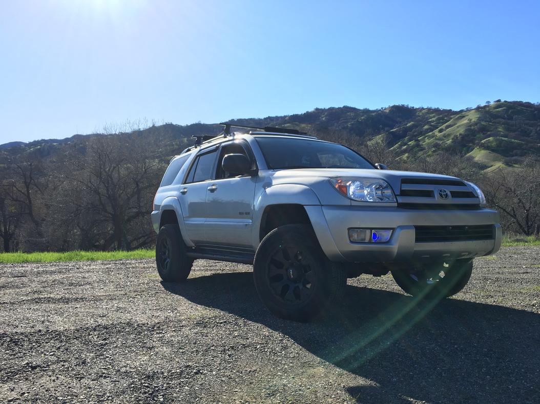

2004 sr5 V6
Had my 2004 sr5 v6 for about 6 months...http://www.toyota-4runner.org/attachment.php?attachmentid=239416&stc=1&d=1487221163
130,000 miles
3"F/2"R spacer lift
1.5" wheels spacers
Helo 17x9.5 -12mm offset wheels
Custom magnaflow cat-back w/ Magnapack muffler
Cold air intake w/ throttle body spacer
HID low/high beam
Blue LED 12000k fog lights
Full Jl audio speakers w/ kenwood head unit
