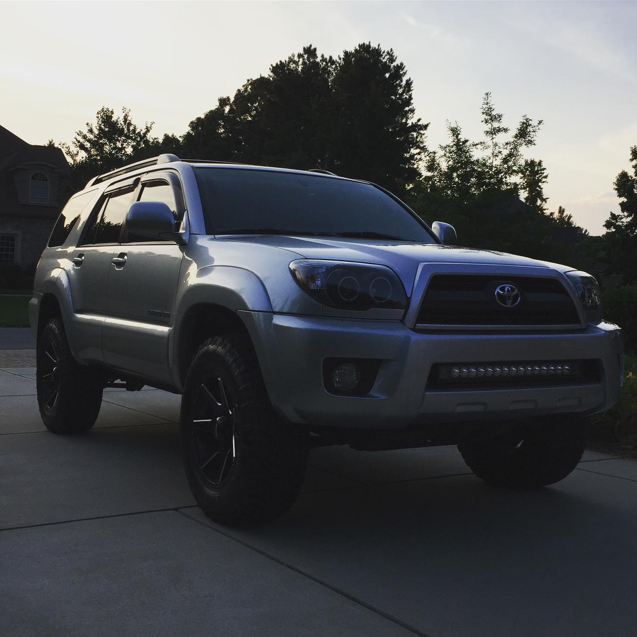

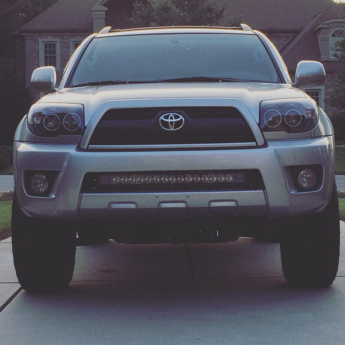

3" Lift on 33s
Finally got some new things...
3" ReadyLift
33" Nitto Terra Grapplers G2
Rigid Industries 30" Radiance White Back-Light lightbar
Aftermarket trailer hitch
Pretty happy with the results, would love some suggestions on what I should do next! :)

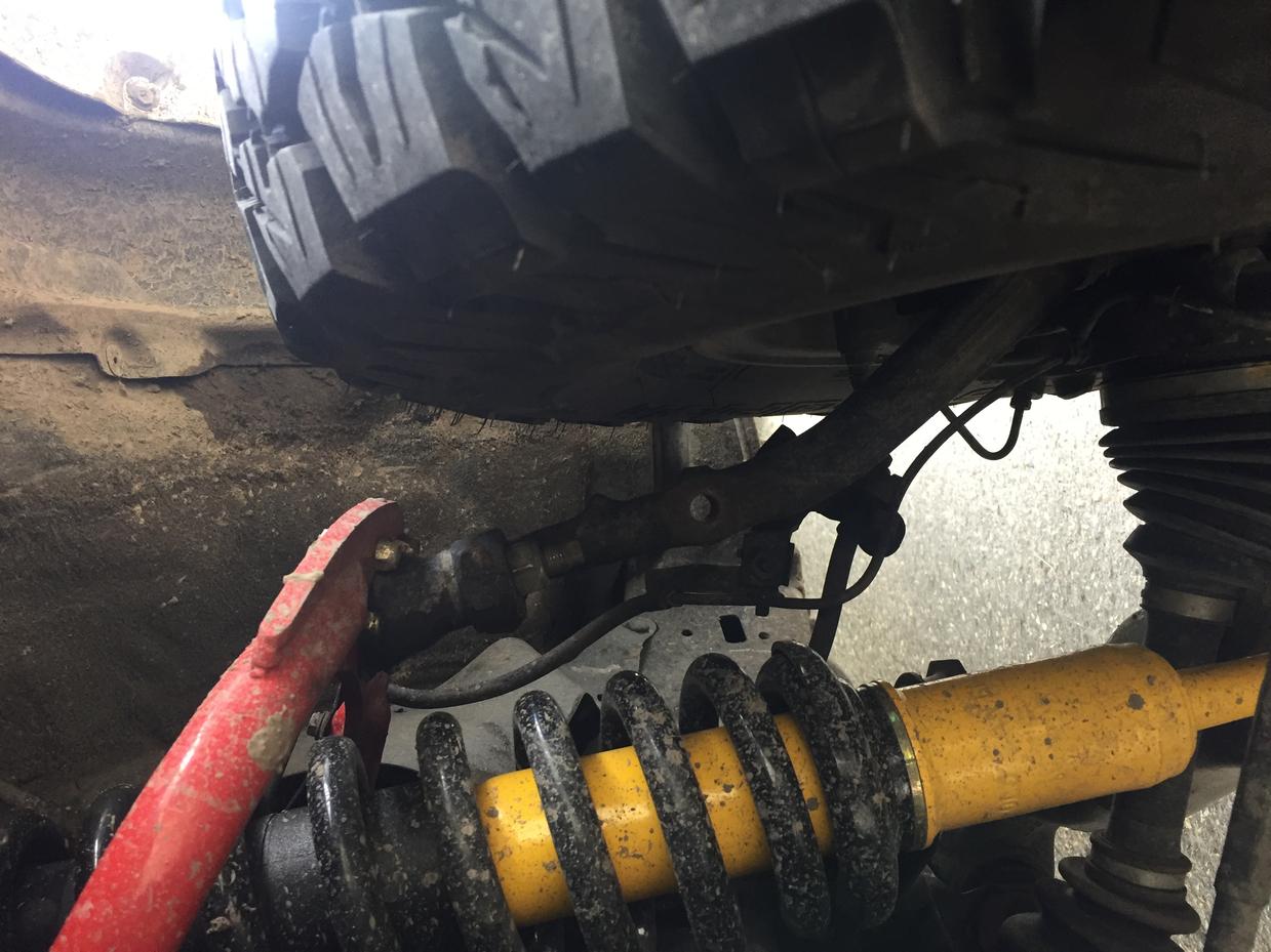

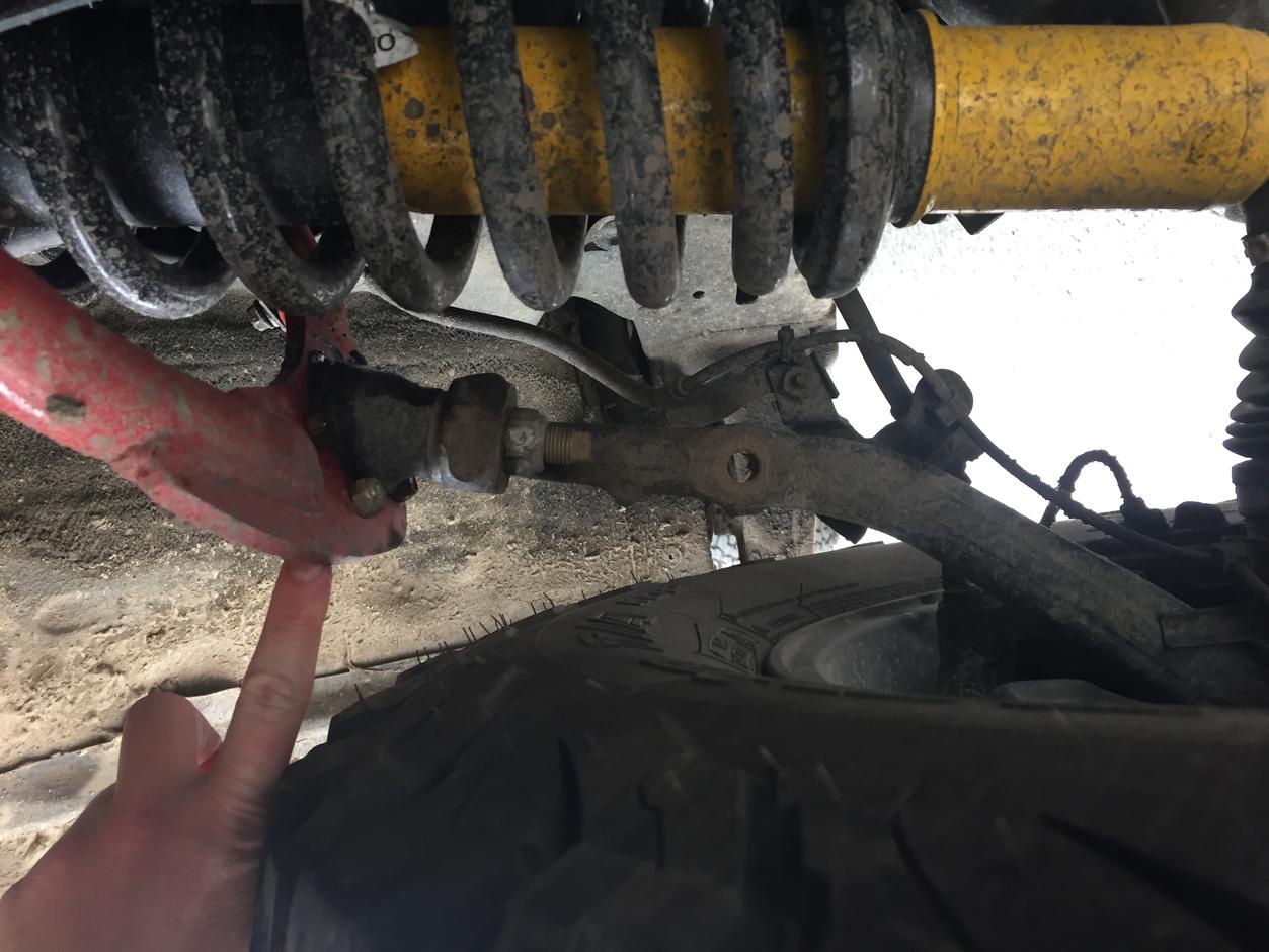

Installed my new suspension:
JBA standard high castor UCA's
Front: OME 885 with top out spacers/OME nitrocharger 90021
Rear: toytec superflex 2" coils with fox performance series 2.0 shocks
Tires: BFG All terrain KO2 255/75R17
height from ground to fender:
DF/PF- 38 3/8" 38 1/2"
DR/PR- 39 7/8" 39 1/2"

How's the clearance between your jba UCA's and the tire?? Looks great!
