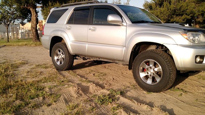

matched with 5100s. 255/75/17s and 5th gen wheels ie: less offset.. Best advice i can give you is if you go the OME route pair their coils with their struts/shocks so that the damping is better paired and the ride is alot better. Also chances are youll need UCAs if you go that route..i did.

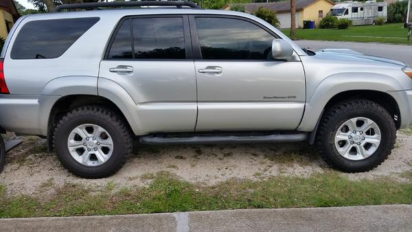

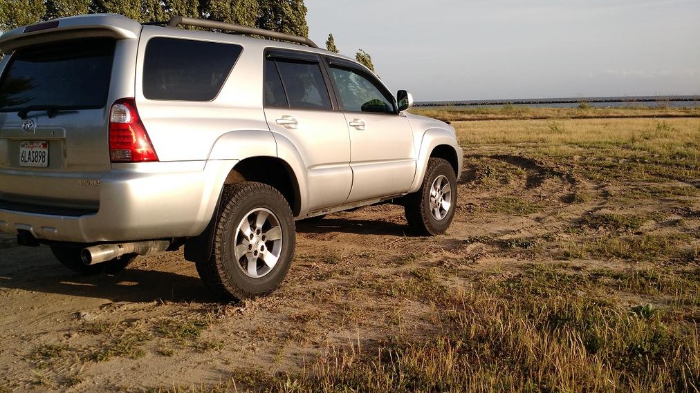

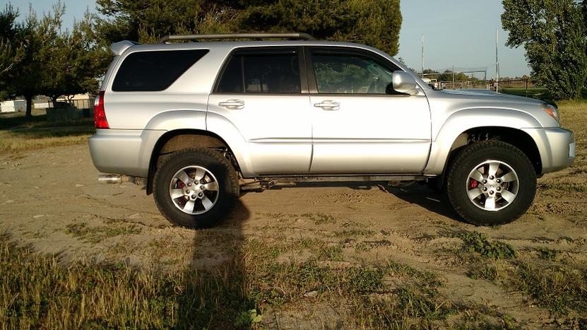

Finally got my 5100s and FJ springs installed this weekend. Went with the 1.75" setting + 1" Cornfed rear spacer. I was hoping this would net a <1" rake, but the front didn't lift as much as expected. I am weighing my options and hoping for a little advice on what I think are my best options:
  1. Adjust the 5100s up to 2.5": pros: no parts required, cons: requires dis-assembling the strut - I have no tools to do so, so would require finding a shop to do the work and a fair amount of $$$ to have it done
  2. Have been looking into top spacers to get ~1" in the front with minimal hassle. Something like in the link below. pros: cheap, may not have to dis-assemble the strut? cons: worse for ride?
  3. Get over it and enjoy the lift as-is... maybe the rear settles??
Top spacer: [SR] 1" Front Leveling Spacer Lift Kit 03-09 Toyota 4Runner & Tacoma 4WD & 2WD | eBay
With these options mind, a couple questions. Adding a small top spacer like this, would the existing bolts be long enough to bolt right on, or would I still need to dis-assemble the struts in order to swap in longer bolts? Any other pros and cons to consider? Any other ideas on how to do this simply?
Bonus points if anyone in the bay area has the equipment and wants to help...!
Before/after below:

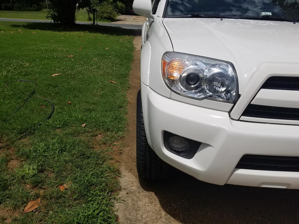

Running 255/80r17 Cooper ST Maxx tires with Old Man Emu 884/Toytec Superflex standard rear springs and sport shocks all around. Suspension still has enough lift even with full skids and sliders, 50 pounds on the roof, and a full size matching spare. Smooth enough for daily driving and enough stiffness for loaded down expeditions in the mountains and desert without the rear end sagging.
Also running LR UCAs to get everything aligned properly. Much better handling after getting caster back compared to the stock UCAs

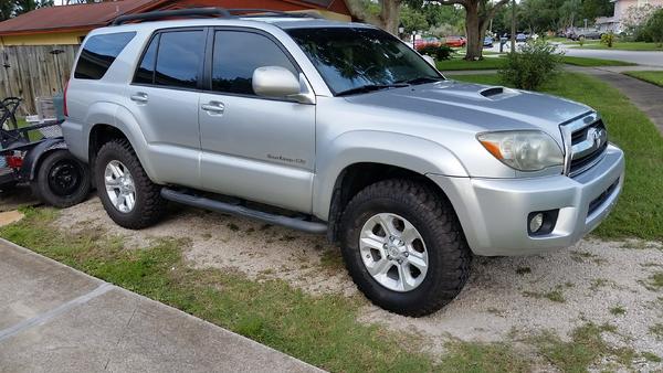

Link to current lift: Imgur: The most awesome images on the Internet
Dissasemble struts the no spring compressor method and move to 2.5. Easy peasy.

I would just leave it, it looks good to me. As soon as you put a load in the back it will eliminate most if not all of that rake.

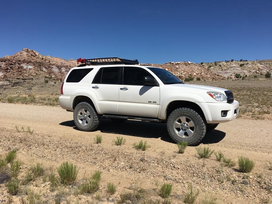

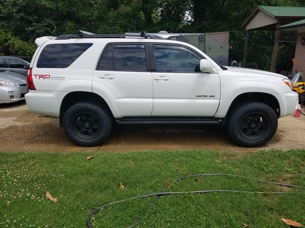

Finely lifted my 07 limited V8 4runner with 40k miles today. Bilstein coilover lift with 285 nitto ridge grapplers on 285/70r17. Wheels are 17 inch 5th gen trail/FJ wheels that were powder coated. Very little rubbing with these wheels and we only had to move the front fender lineres and remove front flaps. Now there's no rubbing at all. The tires drive amazing and are super quiet but still look really aggressive. The pictures don't do it justice how good it looks in person now. I have a little front rake so may do some adjustments once everything settles.
Sent from my SM-G928V using Tapatalk

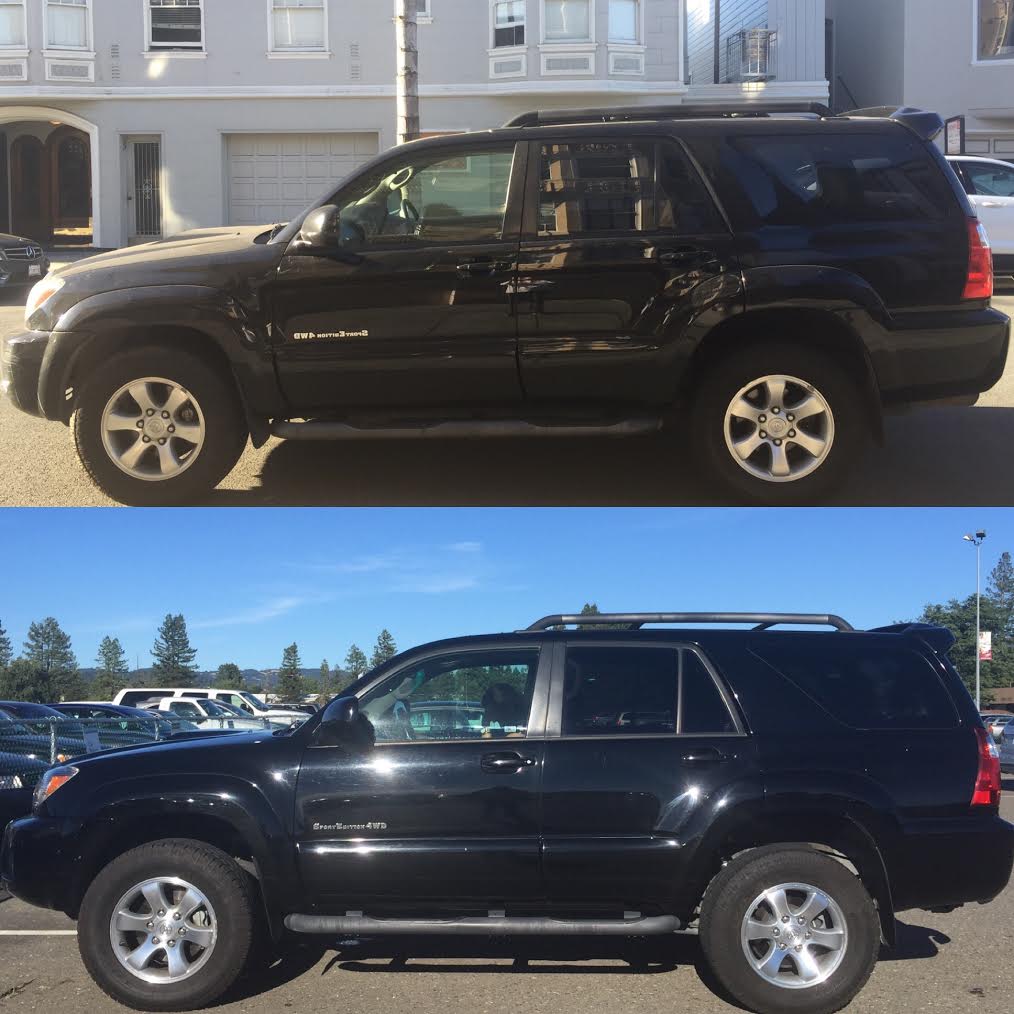

I bit the bullet and ordered the RC 6" lift for the FJ, some Dirt King boxed UCAs, and some NFAB nerf bars. Some background...the before shot is with 5100s at 2.5, FJ springs, and a rear daystar 1.5" spacer for an extra 3" and it's sitting on the same 285/70/17 BFG KO2s and MB Wheels.
Post 6" kit install, I had to bring the front 5100's down to the second to lowest setting (.85?) to get the CV and steering angles even close to ok. It's 4WD and I intended to keep using it, so that's an important part of my changing the settings on the 5100s.
I also had to remove the rear daystar spacers as they would no longer fit around or seat the new RC springs that came with the kit. It's got a bit of a bro lift currently, though I think the front will settle because the 5100s and FJ coils that are there are older than this new kit. At any rate, I'll have to find a spacer kit for the rear that will fit if the bro lift doesn't settle to my liking.
Alright, so the first shot is before....the other 3 are after.....enjoy!
4runner1_zpsn7d4bfwl.jpg~original
