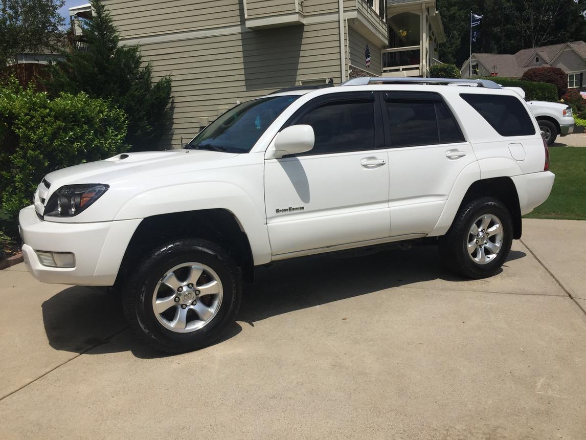

Origionally had the XREAS suspension on my 03 4Runner and wanted to get a beefy look so I swapped them with 5100s and FJ shocks and love how it turned out. 2.5 in the front and 2.0 in the rear. Right now there is 265/65/17 on it but plan on getting 275/70/17 bfg ko2 this week. I'm stoked. Ride is great. First time poster here but long time reader. Stay tuned for more

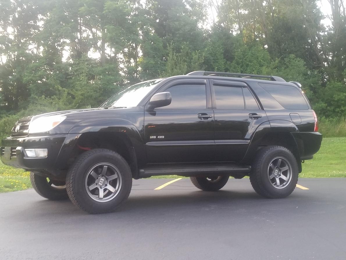

Just recently started following this forum and I'm glad I finally get to share some pictures of my own beauty!
2006 SR5
-Bilstein 5100s in front set to 1.5"
-4" Maxtrac spindle lift
-3" rear spring lift
-1.5" wheel spacers
-Anthem Off-road wheels 17x9
-Nitto Terra Grappler G2s 265/70/17 [for now ;) ]
-N-Fab stepbars
-2" rear pods

Sweet 4runner, like the.mods so far. Where do you have your rear pods mounted?
Nice, I've actually considered doing the same, was the wiring pretty easy?
Super easy! If you have a common voltmeter around, simply put your emergency brake on and put your car in reverse so that the stock reverse lights come on. Pop out one of your tail lights and see which wire has voltage running to it ONLY when you're in reverse. Then just tap into that wire and run it to your pod. Also, just a piece of advice if you're going to do your pods like mine, have a blowtorch handy so that you can heat up the bumper from the inside. The reason I say this is because the bumpers are naturally a round surface, so you'll have to flatten out the area that the pod is going into before you do a final install. I probably should've made a YouTube video for the rest of you guys haha
I hope that all made sense though.
