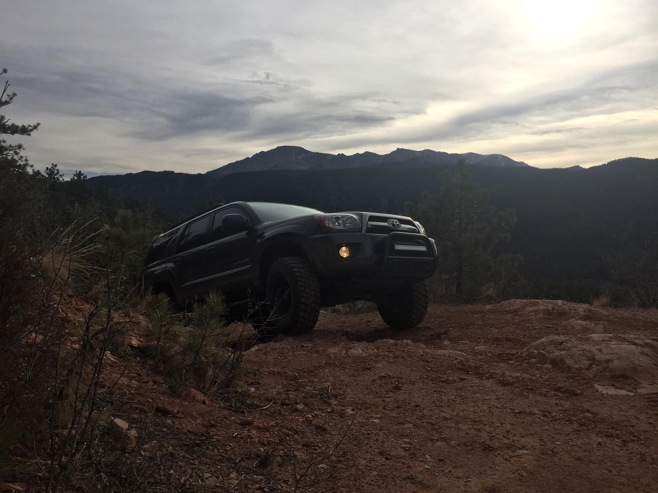

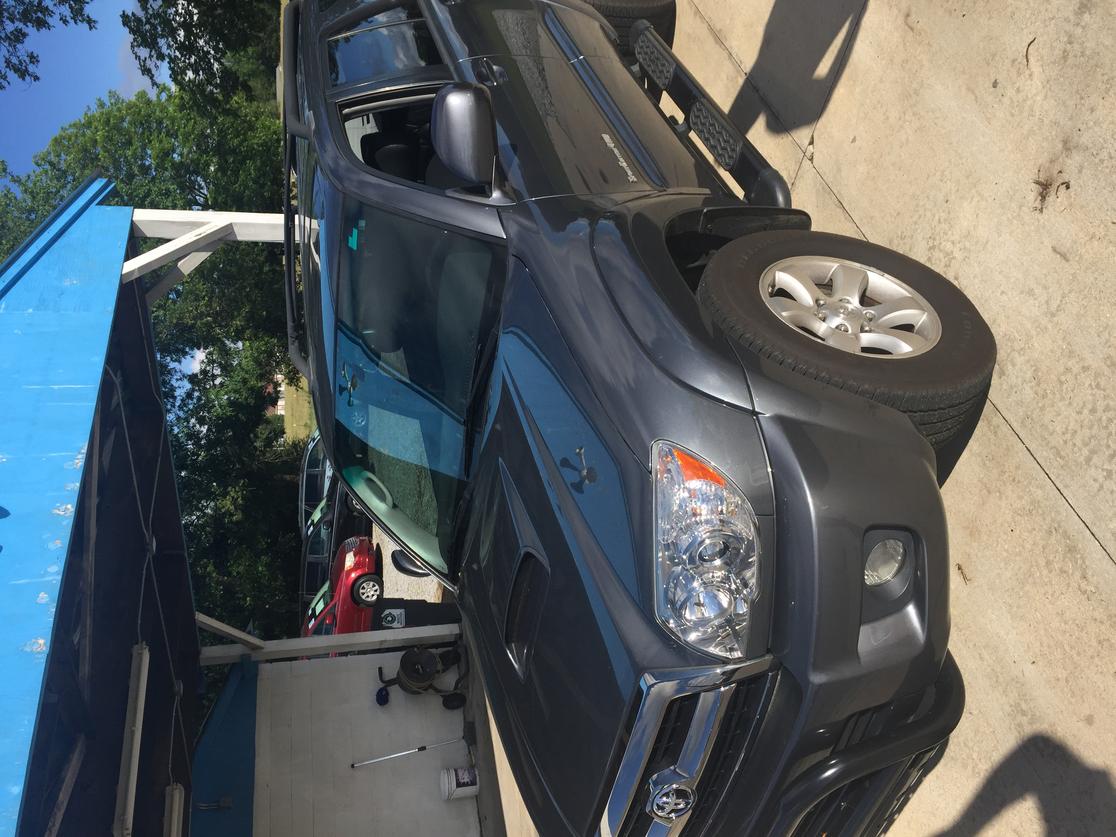

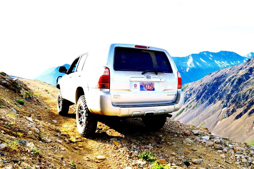

New here. 5th Toyota build but first time on T4R. Had an 07' Tundra I thought I wanted after I totaled my 03' 4runner. Decided to go back and found me another. So far, I ripped out the X-REAS, replaced with Bilstein 5100's and Toytec (Eibach) springs up front and RCC 2.0HD springs and Rancho 9000 adjustable shocks in the rear. Put some ProComp 16x8 7069's wrapped with KM2's. Haven't really touched anything else. Probably have to wait until I move to CO to finish up.

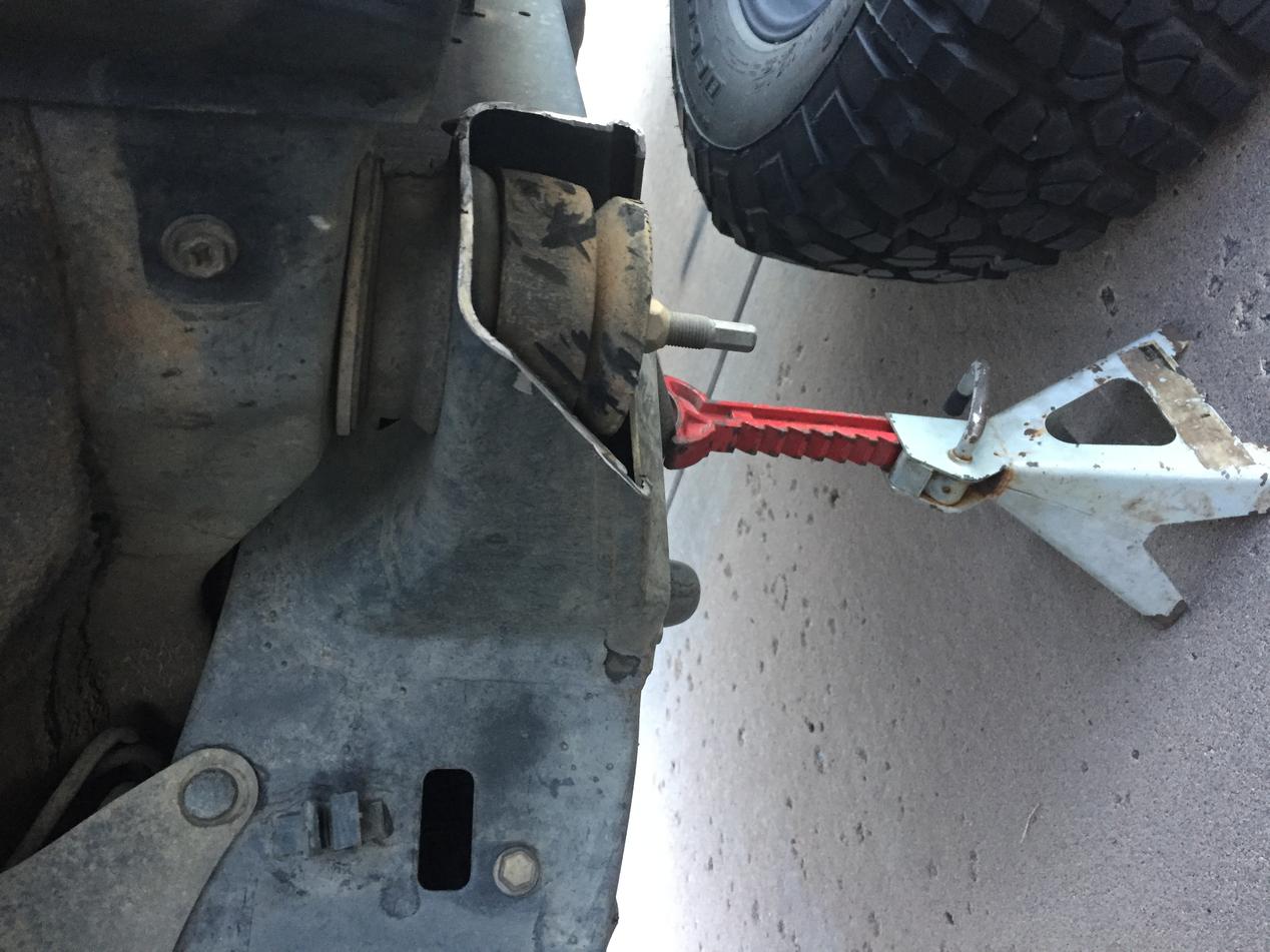

Well, got moved. Having a hard time finding anything around Colorado Springs that’s not posted as private property or that’s not much more than a dirt road. Maybe I’m just not looking in the right areas. Anyways, haven’t been able to do much more. I have a 1” body lift waiting for me to put it on. It’s just been sitting in the garage. I did manage to chop the body mount up front. Tires were rubbing almost every time I turned the wheel.

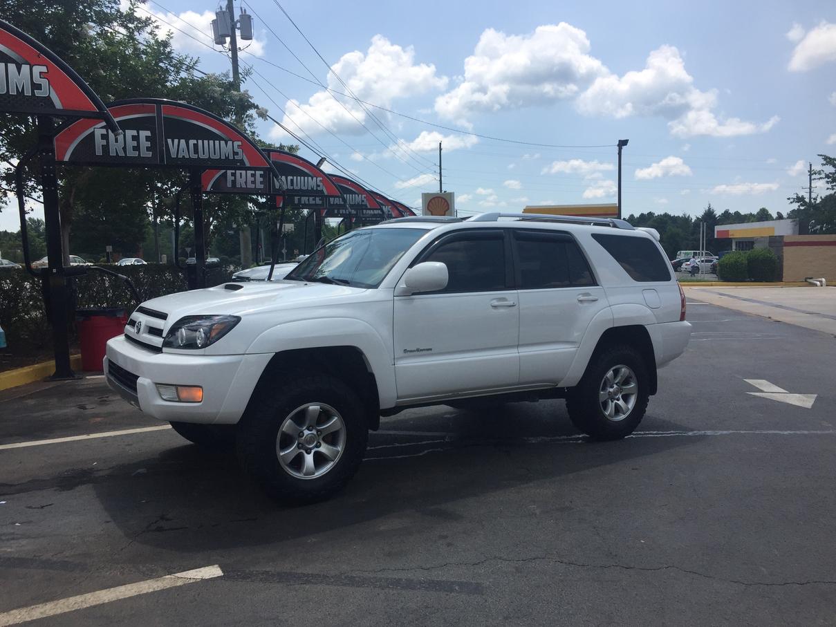

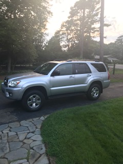

I just installed Rancho quick lift on the front 2006 SR5 V8. I was at 32.5" on front wheel well and 36" in back and I hated it. 119K with original strut/springs so instead of spacers i decided to change those out. Rancho recommends a 1" spacer in back but I skipped that for now. I am now 36 1/2" Front and 36" rear. Waiting a few hundred miles to see if they settle before deciding on the rear 1" Spacer. I think I am all in at $650. new tie rod ends and an alignment too.

265/65 cooper Discoverer

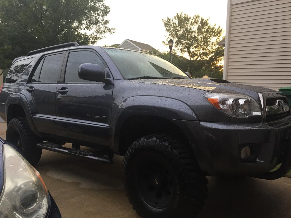

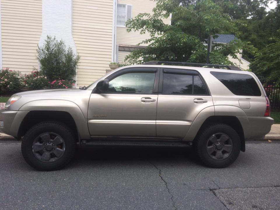

Loving my new setup I just got yesterday! No rubbing or any issues, fit over the brakes just fine. Fits perfectly flush with the fender flares.
Wheels: Pro Comp Series 32 Flat Black 16x8, 0 offset, 4.5 inch backspace
Tires: 265/70R16 Michelin Defender LTX M/S

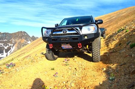

OME 885 with top out spacer, toytec superflex rear.
JBA UCA's
BFG KM2's in a 255/80R17 size (33's)

Looks like it might be a Tacoma swap with a spacer on top in front with Toytec Superflex coils in the rear. I'm sure someone with more knowledge on the OEM suspensions can clarify.
Are the UCAs OEM with a greasable joint added?

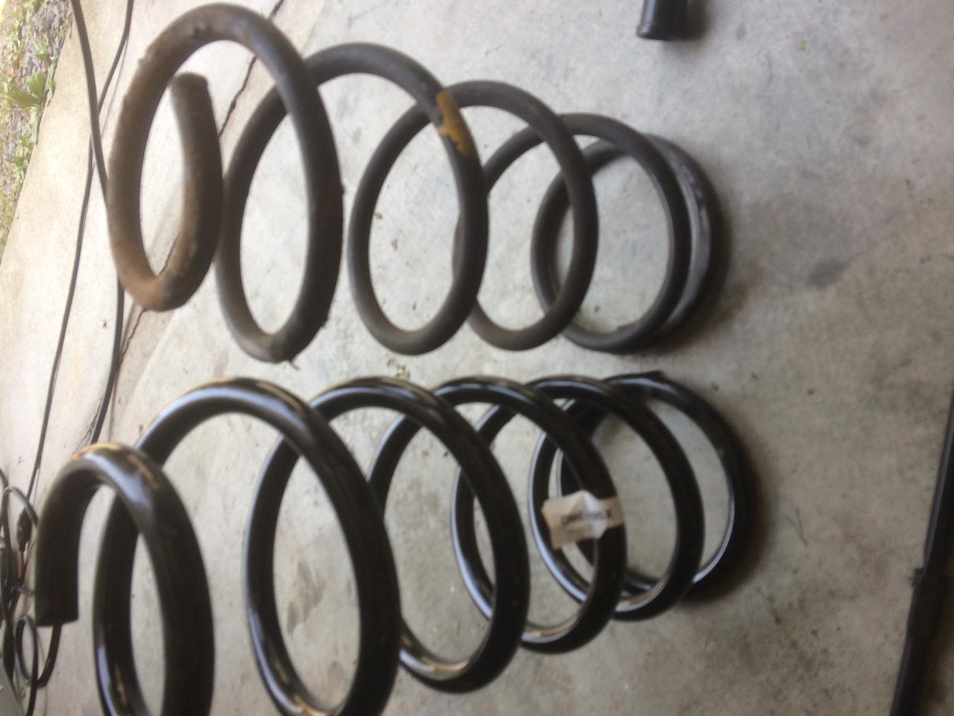

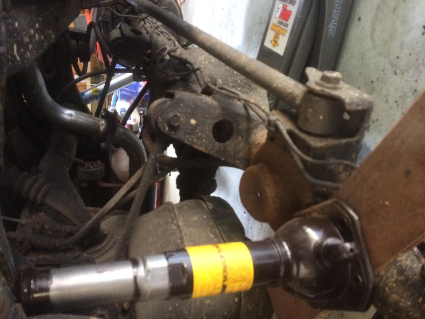

Picked up a 4th gen with relatively low miles. Up front I put in Bilstein 5100 shock with OME 885's thinking it would level the vehicle by putting the 5100's on the rear and keeping stock springs. Turns out the old springs were sagging quite a bit which threw my measurements off. Now I'm running the Cali squat. Tried to install Old Man Emu 895E's on the rear yesterday. I got the old springs out but couldn't get enough separation to get new springs in. I put a jack on the axle to open up space for the new spring and must have caused a leak in my tranny fluid line (today's project). Kumho Road Venture A/T 265/70R17's not a bad tire for $500.
