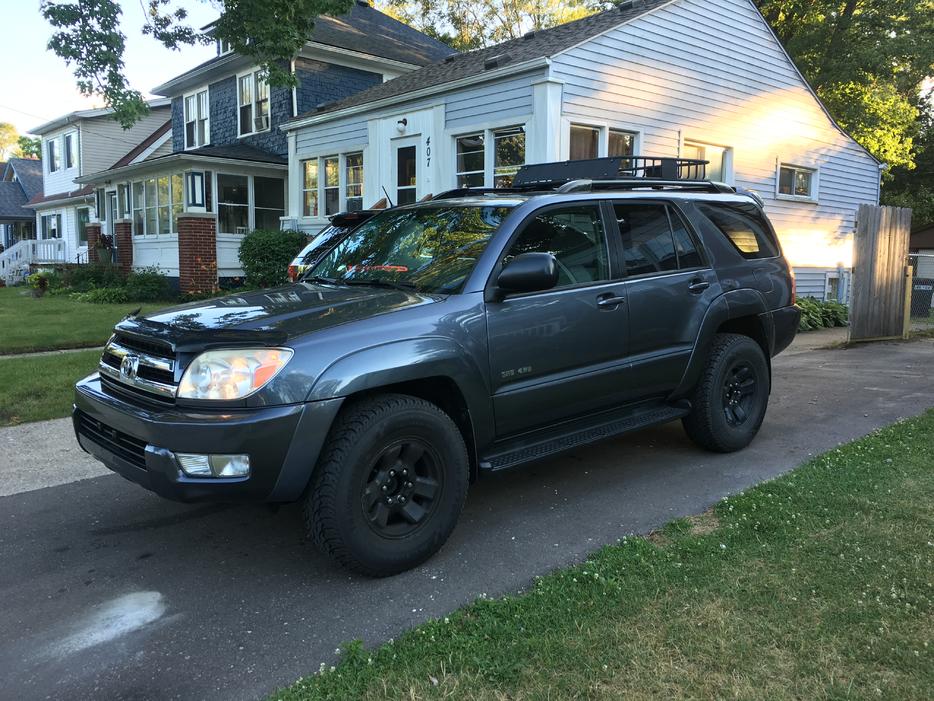

I bit the bullet and ordered the RC 6" lift for the FJ, some Dirt King boxed UCAs, and some NFAB nerf bars. Some background...the before shot is with 5100s at 2.5, FJ springs, and a rear daystar 1.5" spacer for an extra 3" and it's sitting on the same 285/70/17 BFG KO2s and MB Wheels.
Post 6" kit install, I had to bring the front 5100's down to the second to lowest setting (.85?) to get the CV and steering angles even close to ok. It's 4WD and I intended to keep using it, so that's an important part of my changing the settings on the 5100s.
I also had to remove the rear daystar spacers as they would no longer fit around or seat the new RC springs that came with the kit. It's got a bit of a bro lift currently, though I think the front will settle because the 5100s and FJ coils that are there are older than this new kit. At any rate, I'll have to find a spacer kit for the rear that will fit if the bro lift doesn't settle to my liking.
Alright, so the first shot is before....the other 3 are after.....enjoy!
4runner1_zpsn7d4bfwl.jpg~original
Looks good! How's the ride and how are those CV's holding up at that angle? Any signs of binding?

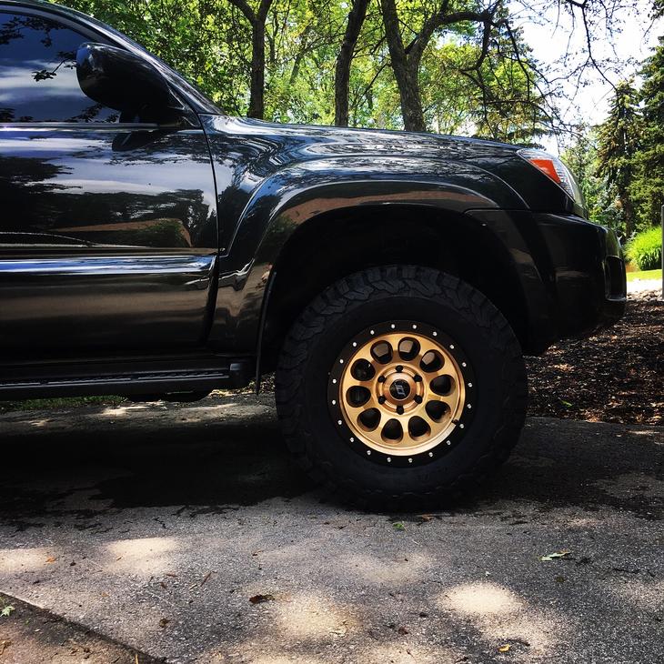

SCS Ray 10 brushed gold. 275/70/17 big ko2.
Had to do a good amount of trimming to front bumper and pushed my fender liners in. Mud flaps have to be trimmed or removed too. And I have a body lift...

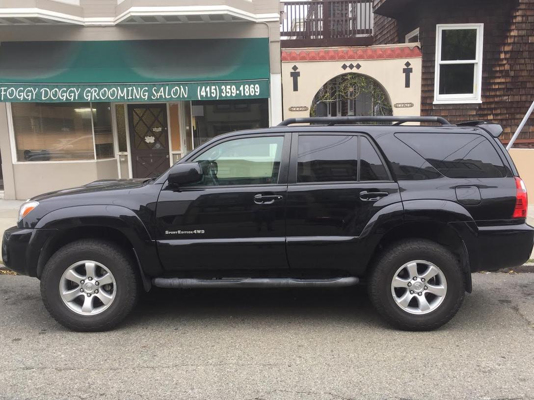

265/75/16 on 3rd gen sr5 wheels, 1.25" spacers, no lift (next week)
Slight rubbing on front inner liner when at extremes, the lift should help with that

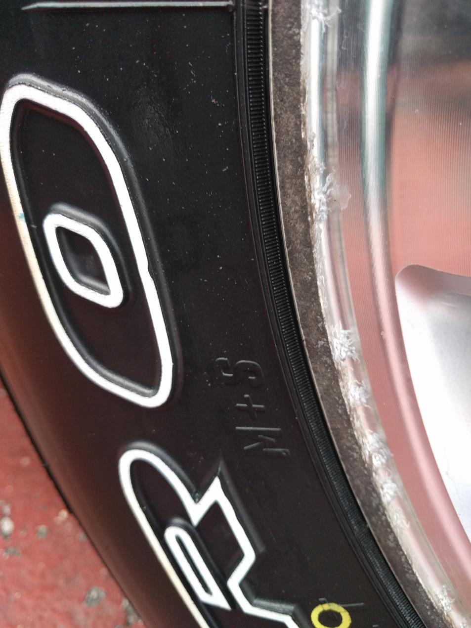

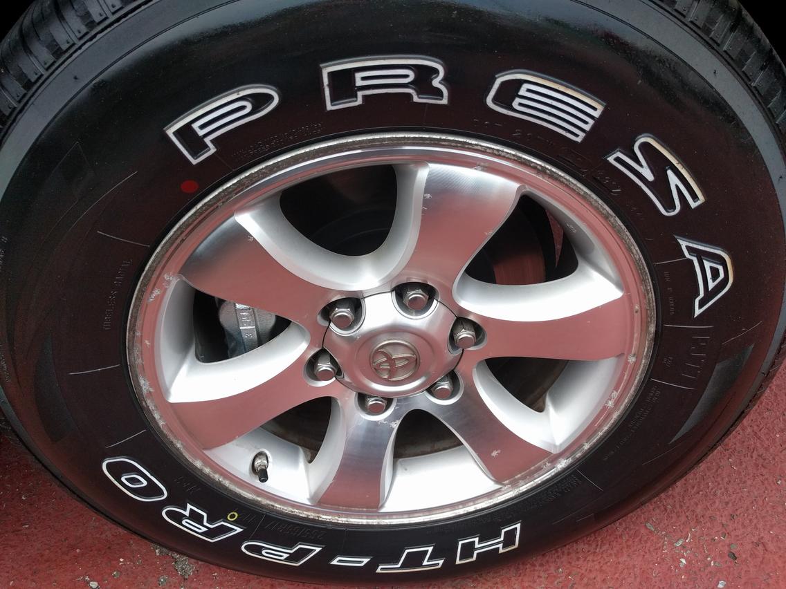

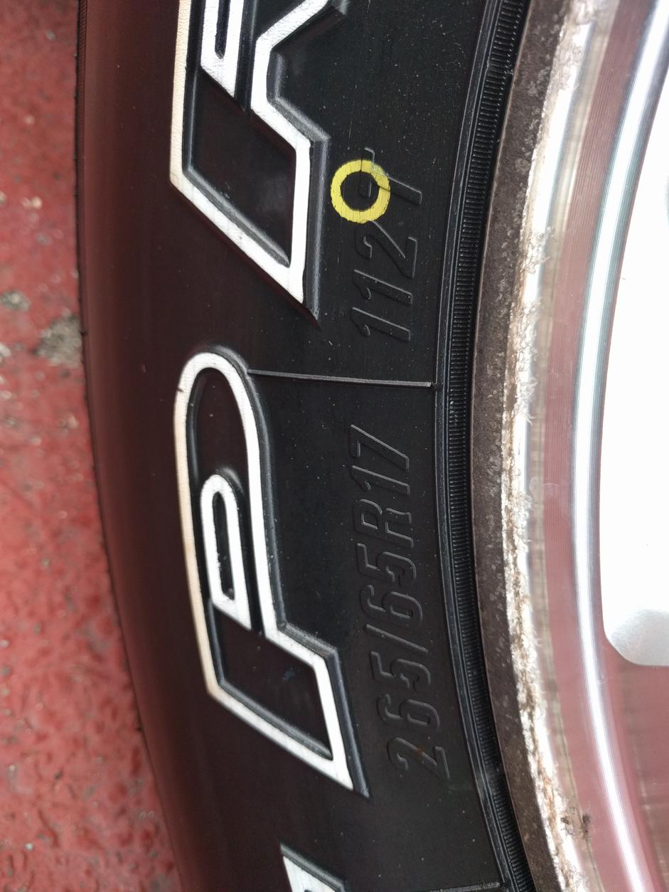

Does anyone recognize these tires? They come on a 4runner I'm possibly going to buy in the morning. I've never heard of Presa brand tires
