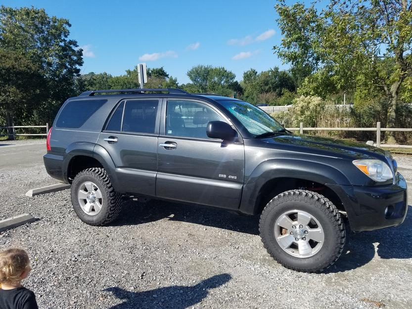

It has been a long time coming and I have been a lurker in this forum. I love looking at everyone’s rigs for future inspiration. So I finally got a lift and here she is.
Toytec OME lift with 884 front coils, and Toytec Superflex rear coils, and top plate spacers for gas tank lean. Wheels and tires coming soon.

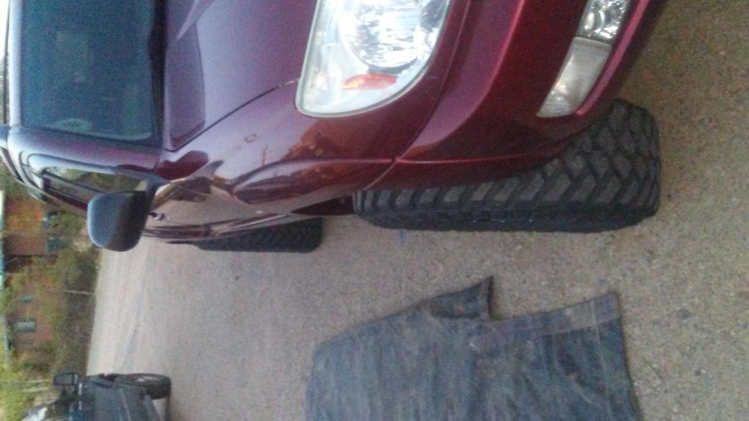

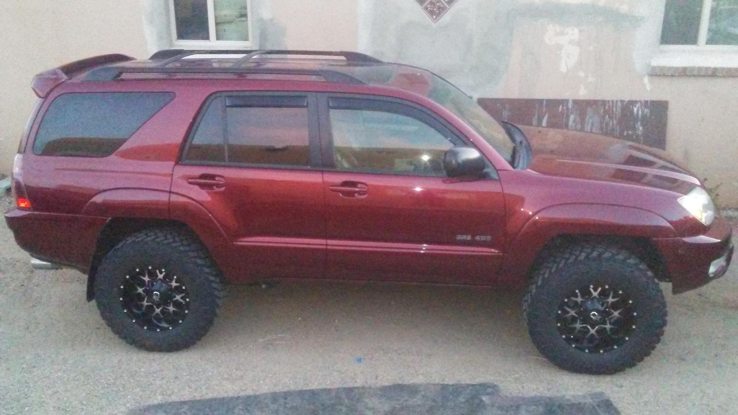

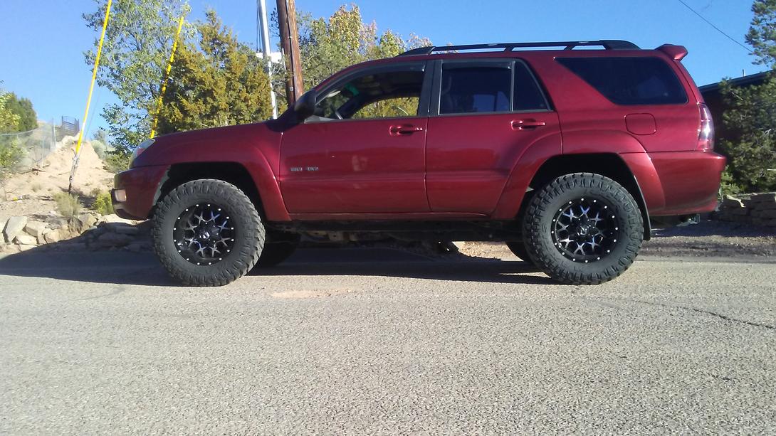

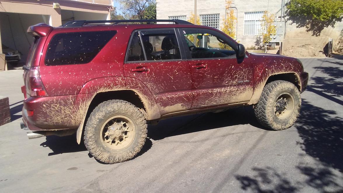

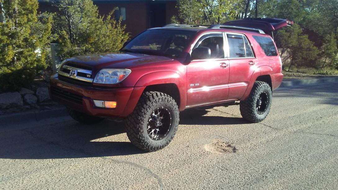

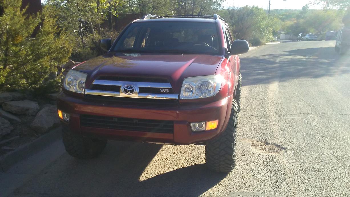

Here's my 05 V8 with 63,xxx miles.
Lift: Supreme Suspensions 3/2 spacer lift
Tires: Maxxis Razr M/T 285/70R17
Wheels: Dropstar 645MB 17x9 -12 offset
I really like how it looks and rides. It's a very smooth ride even with the load range E tires. I just wish it was a little higher. When its time to replace shocks I will probably be going with coilovers and also installing a body lift so I can fit 35's.

How much lift did you end up getting overall and what condition were your stock springs in?

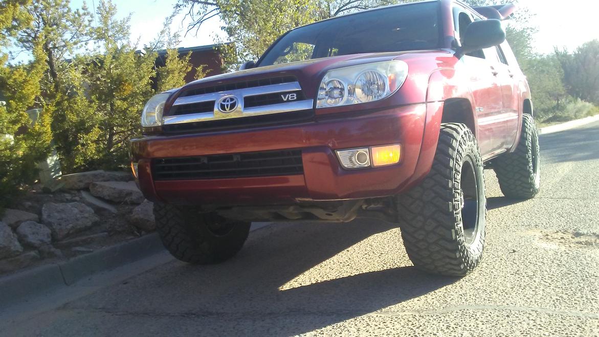

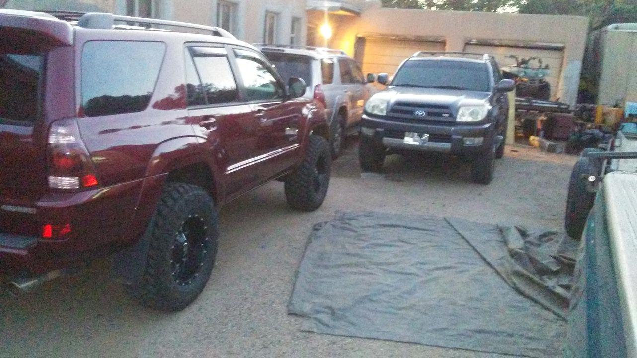

To be honest I don't know how much lift I got. I didn't take any before or after measurements. I suspect around 4 or 4 1/2 inches with the spacers and the tires combined. My stock shocks and springs are in great condition. The vehicle only has 63,xxx miles and the first owner was an older man so I doubt he ever took it off road. Here's a few more pics.

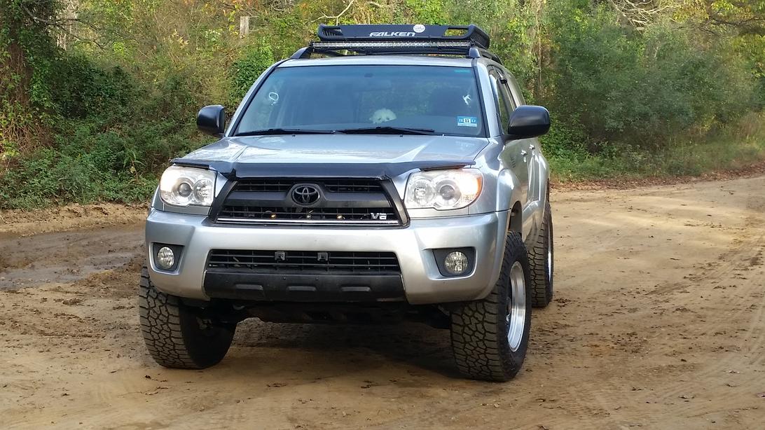

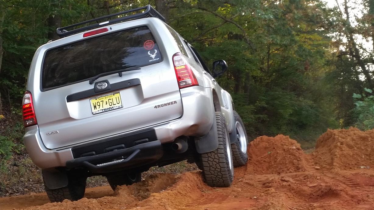

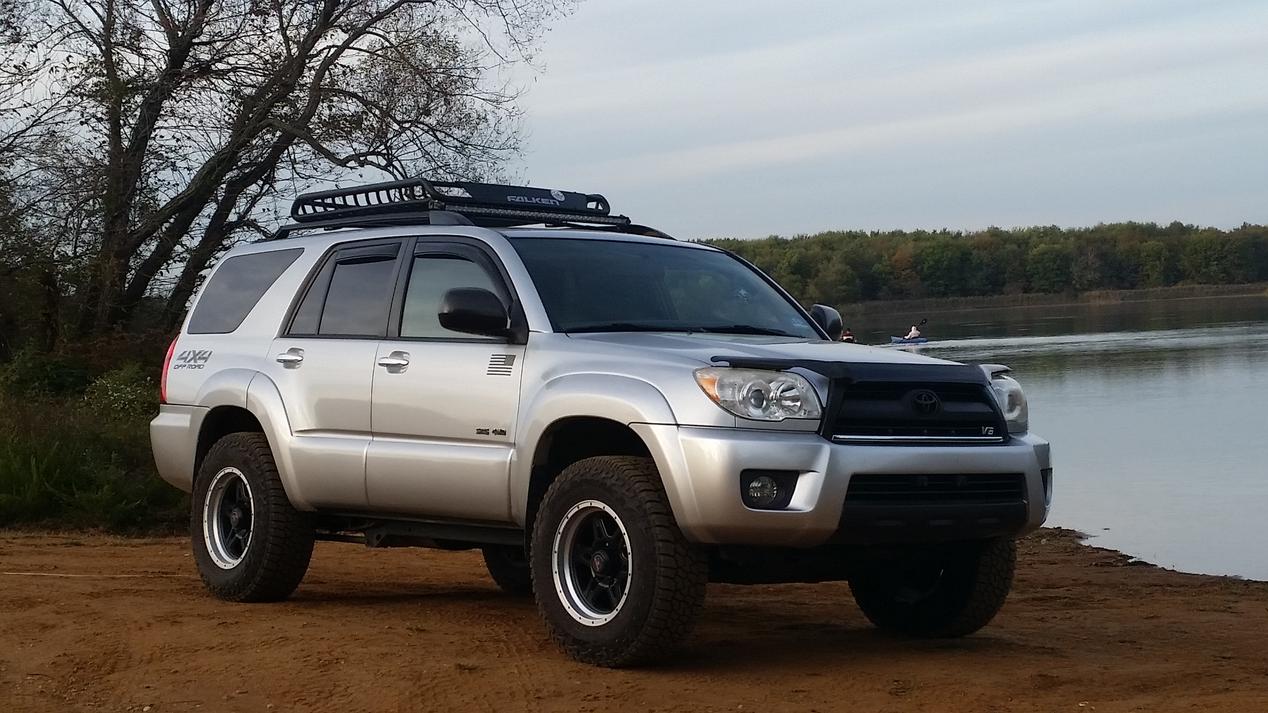

A couple hours before my rear window exploded :P
Bilstein 6112/5160 with Icon 2.0 rear springs
JBA hi-caster UCA's
Gen 5 rotors and calipers upfront with ss lines
BFG Mud Terrain KM 255/75/17

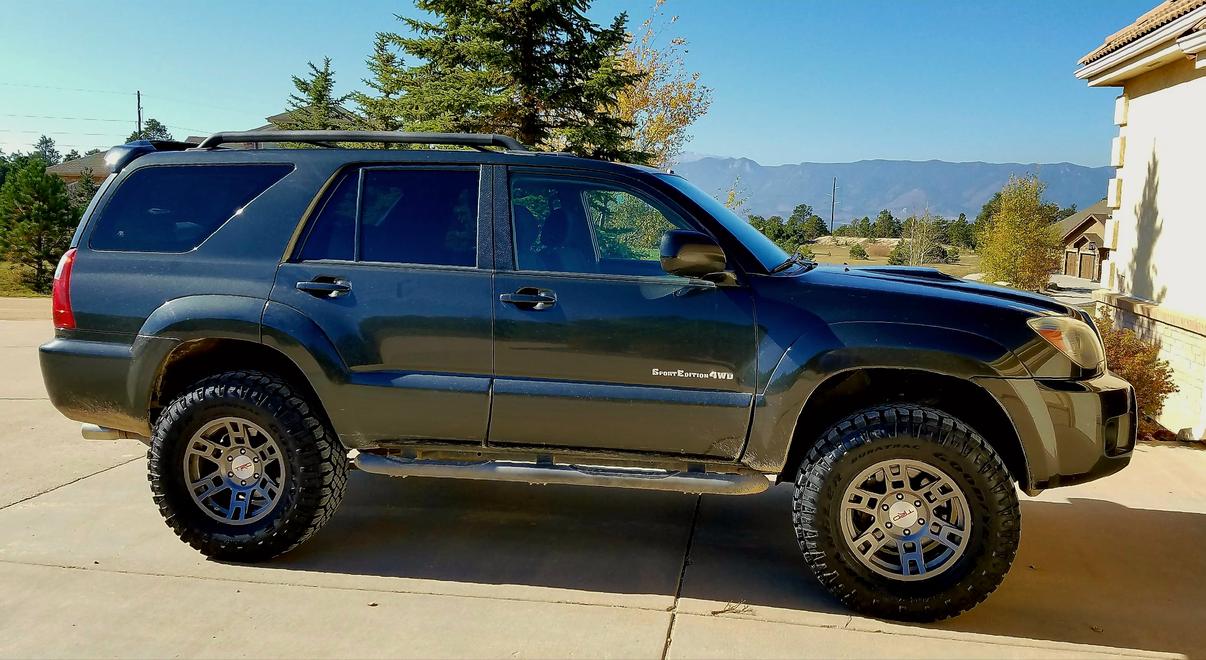

Finally got some new tread, GY Duratracs, 285/70/17! Lifted earlier in the spring w/ 5100's set at 2.5" and moog FJC coils. Next is new UCA's.

How did your window explode? Is it a manufacturer's defect? I've read that changes in environmental temperature can affect it.
Nice T4R!
Nice T4R!
I have a post about it. One of the trunk strut supports popped off the ball joint. It slammed the trunk shut and the strut shot into the window. Such a pain in the ass.
^It’s also a defect of the rear window defroster. Can get too hot/malfunction and cause rear window to explode. Toyota knows about it, got a letter about warranty of rear glass until ~2018 or they will reimburse those affected and had to pay out of pocket to replace.
