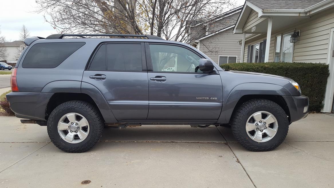

Lift: Front Icon 2.5 long travel, Rear Icon 2.0 with Superflex springs, Total Chaos UCAs
Wheels: VTX off road Rogue 17x8.5 -10 offset
Tires: Falken Wildpeak 265/70/17

More pics please. Side shots? Are you running any spacers?

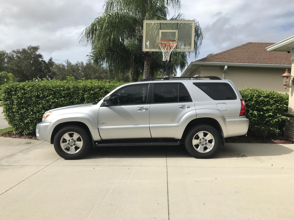

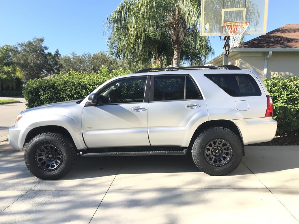

2007 2WD that I just had upgraded with Bilstein 5100s set to 2.5", 1" body lift, and Fuel Vector (gray) 17x9" rims with 285/70R17 Terra Grappler 2 tires
Before and after
