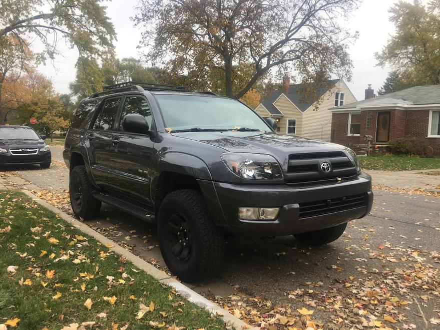

Did my lift (OME/Bilsteins) and got wheels and tires a couple weeks ago
what setting do you have your bilstein's at?
I'm assuming they're 5100's.
and exactly which coils front and back?
oh and what size tires?
thanks for sharing, your truck looks good
Lol thanks.
- Springs are OME 895/884
- Bilsteins are 5100s all around
- Wheels are SCS F5s, 17x8.5
- Tires are Nitto Ridge Grapplers and ended up going with 265/70/17. Was tempted to go with the 285's but I didn't want to deal with a BMC.
Lol thanks.
thanks, i'm thinking of doing the same set up..
but what notch is your front bilsteins set to ? are they maxed out?

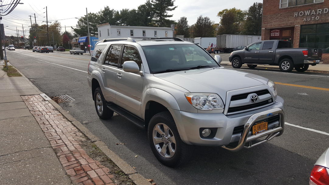

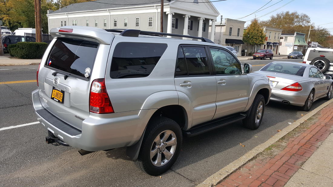

2007 Limited V8 Lift
Just had my Limited lifted. Blistein 5100s all round with front on the lowest perch, wheelers T1/T12 coils giving the lift. Truck looks great and handles far better than before. I'll post up some better side on pics at the weekend.
Reckon I could fit some 265/65 tires on it ok (265/60 standard). Thinking of BF Goodrich or maybe some Goodyear Duratracs.
