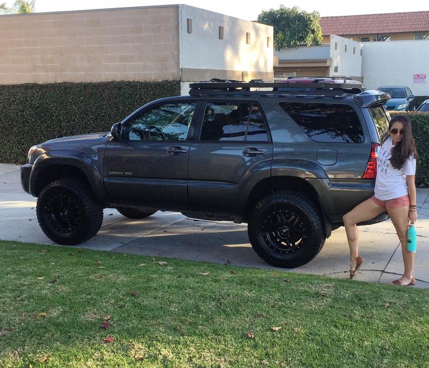

1. Front: Bilstein 5100 top notch/Moog FJ cruiser coils, SPC UCA's, no swaybars
Rear: All pro springs, Procomp es3000 no swaybars.
2. Falken Wildpeak AT3 285/75R17
3. Like the results? Had to trim a lot of fender and body mount to run without rubbing. I would like to upgrade UCA's and ditch the bilsteins for coilovers. Ultimately I can't complain it does good on and offroad.

Your rig looks great!
How does it ride on highway with no swaybars? Would you feel safe on a torn up road or if you had to make an emergency maneuver?

Thank you, it rides fairly well on the highway and all kinds of roads. I have driven this truck cross country but I have also been driving lifted 4x4s without swaybars since I got my 1st truck at 16 so I am very used to the handling characteristics of it. My wife actually daily drives this truck with our 2 kids everyday and feels comfortable with it.

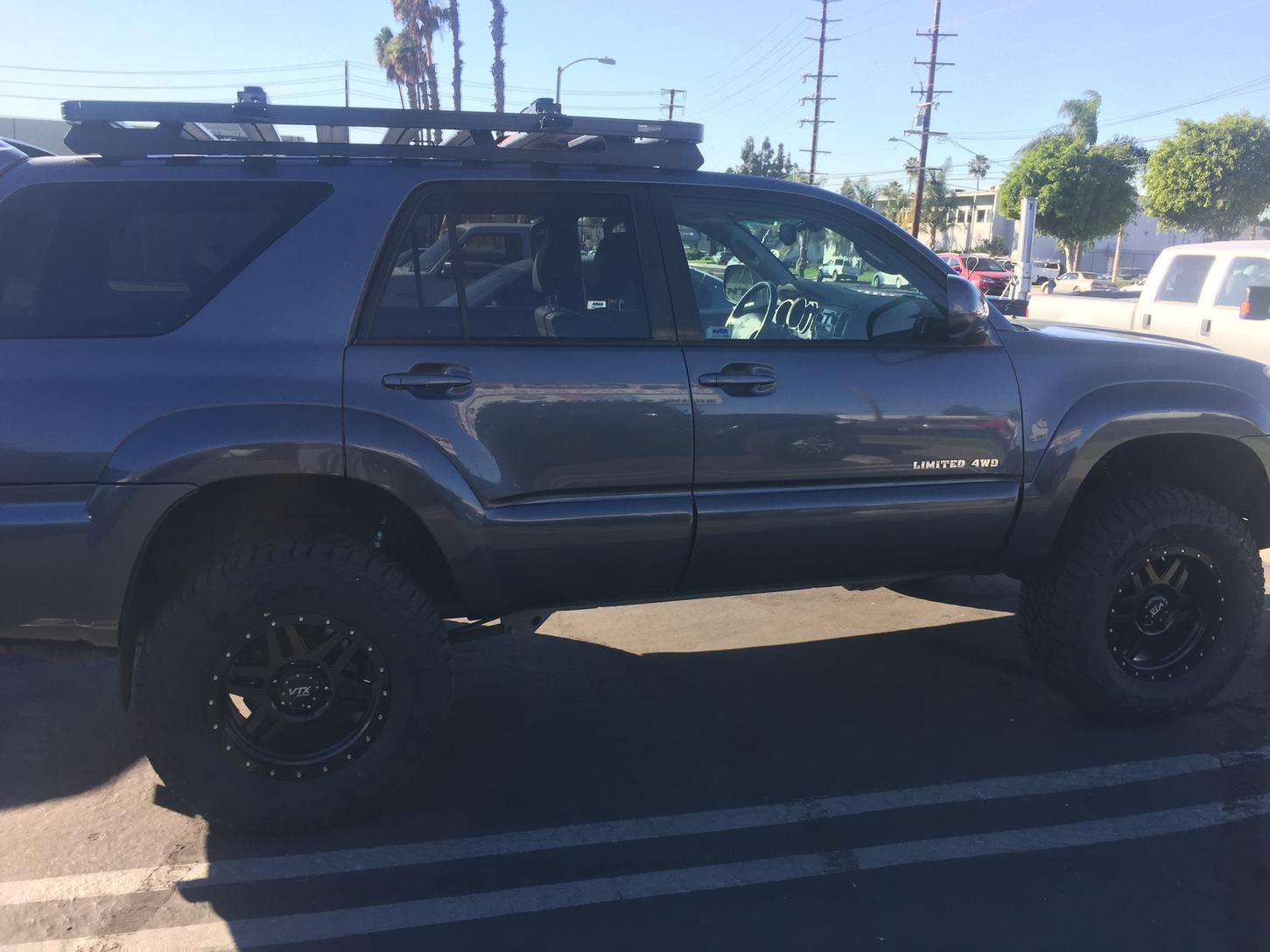

After MONTHS of research and development, Spicoli is finally ready for his debut.
5100s all around, icon 2.5" springs in front, ome 2895 springs in rear, and SPC UCAs.
Falken Wildpeak 285/70/17s and VTX Viper wheels.
Zero complaints. Noticing a huge increase in ride quality. Firmer, sturdier, less nose dive, less boat like, more responsive, my alignment is better than when I started. Loving so far. Haven't taken it offroad yet, so I can report back with an update after that. Didn't take before measurements but with my old sagging stock suspension at 105,000 miles, I easily saw more than 3"s of height change. Only downside with this setup that isn't even a downside because I knew it would probably happen is the rubbing in reverse wheel crank on the inner front fender liners. But pushing those forward looks easy enough from the write ups I've seen.
ALSO, totally got the full size spire (with vtx wheel) to fit in the factory spare location! :girl:

Good looking........4runner ...... :) Just ordered the same tires/size. Supposed to be a great tire.

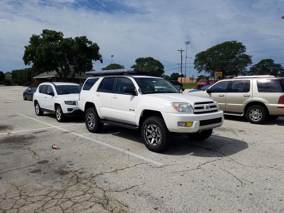

Looks great! Do you by any chance have pics of the sides? I am looking at picking up the same wheels and was hoping to get an idea of what they look like on a 4th Gen T4R. What size BF Goodrich tires are you running & any rubbing issues?
Thanks for the info!
Please see pics attached. Mine is 275/70 r17, with the stock 4th gen wheels it rubbed UCA , thats the main reason i got these TE wheels since they give more room with a larger/smaller? (different) offset, also it rubbed the front wheel well plastic liner, but with pushing it forward its solved.

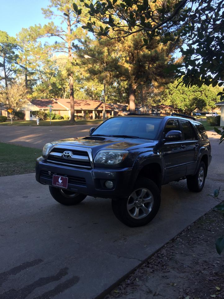

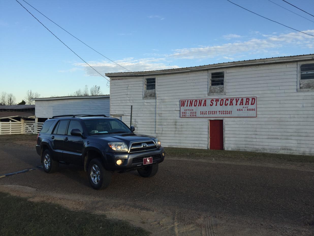

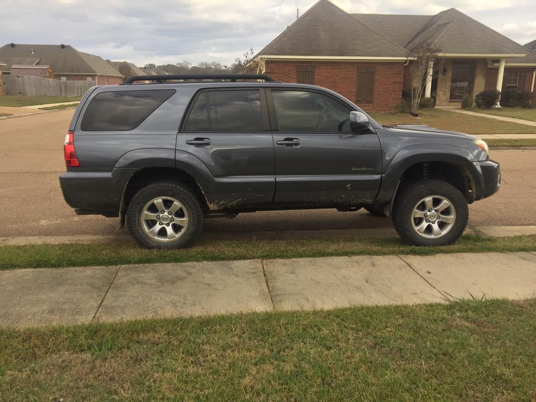

07 sport with 3in toytec coilovers and bistein shocks in the rear, stock springs plan to upgrade in future 265/17 tires. pics not in order, befre the rear shocks there was a noticable "squat" from the x-reas being removed
