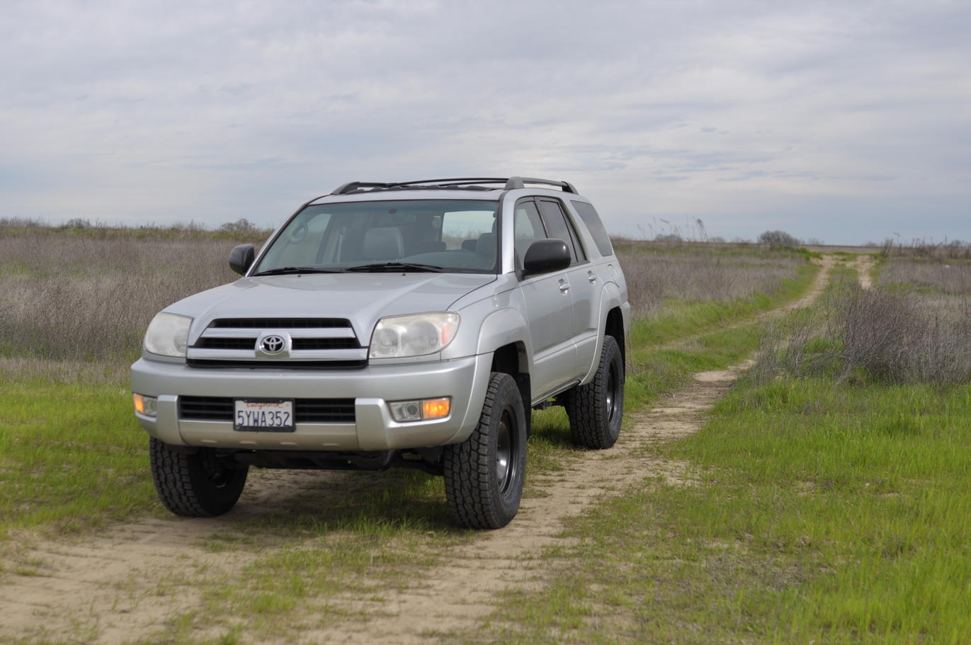

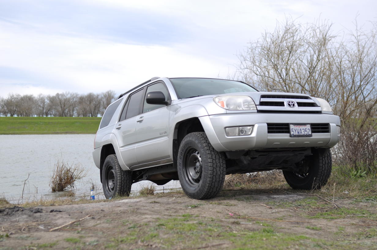

Just installed this weekend, happy with the result.
2.5/1.5
Bilstein 5100s all around
stock coils all around
rear spacers
265/70/17 Toyo AT2
FJ Steelies

Looks like my little twin, i like the stance

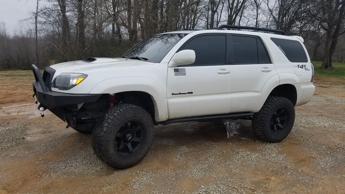

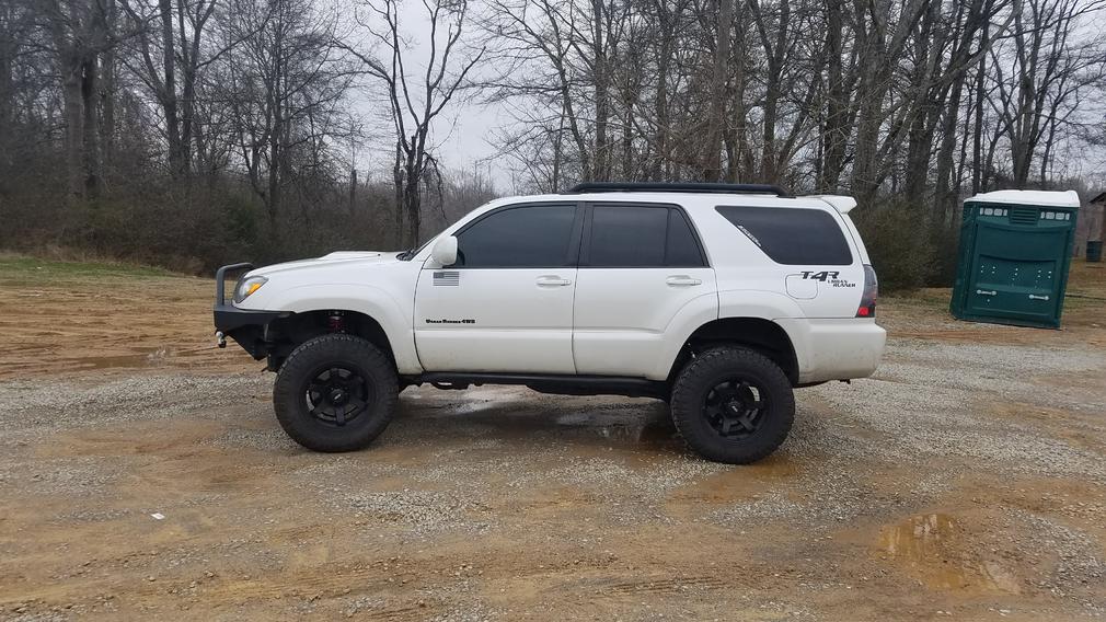

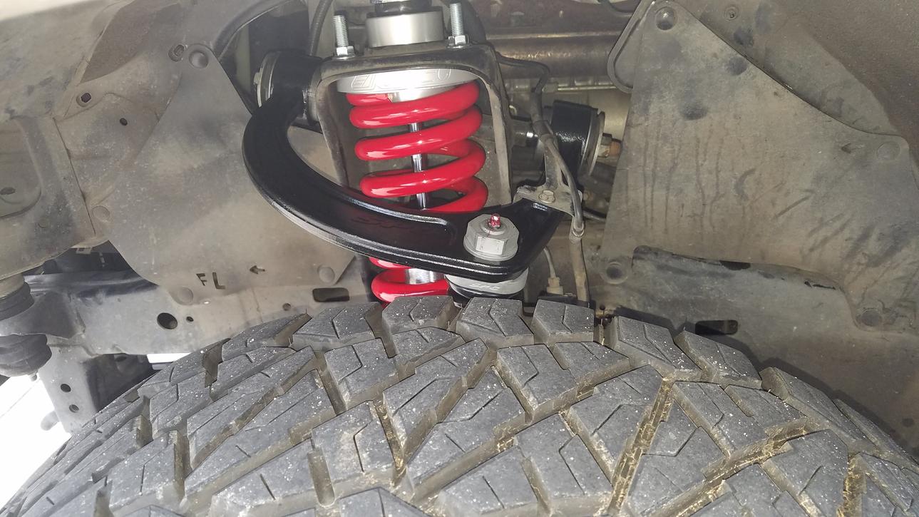

Finally upgraded from the crap spacer lift on the stock XREAS to the Toytec Ultimate and SPC upper control arms! I had forgotten what ride quality was!

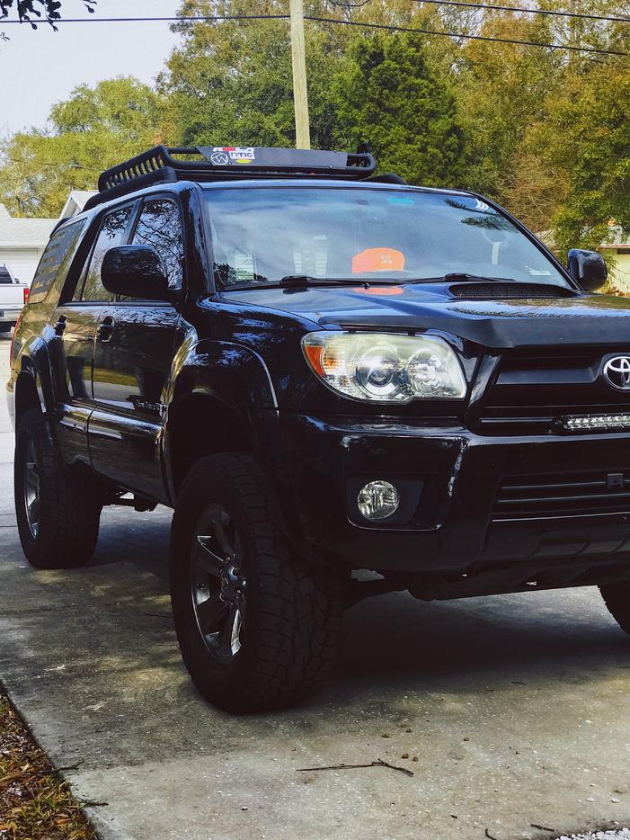

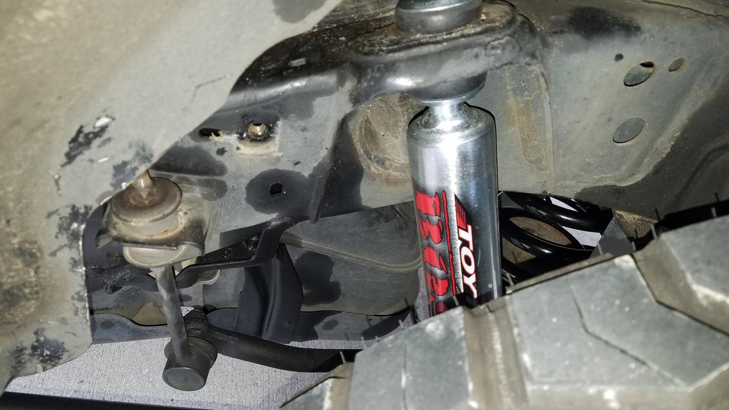

First post, been lurking here for awhile.
-Toytec Ultimate 3" Front 5100 Coilovers
-SPC UCAs
-Superflex Rear Springs
-5100 Rear Shocks
-Fat Pats 1.5" Body Lift (might remove when time comes for tire change down the road)
-Level 8 MK6 17x9 -12 offset wheels
-Falken Wildpeak LT285/75/17 (34s)
Would like a bumper soon but I'll wait until I actually get to start using the truck lol (as you can see, most photos in a driveway, full time work/student life...)
is it a thing now to install coilovers upside down?
Sent from my XT1635-01 using Tapatalk
why did you install them upside down? your front coilovers...
That’s the back.
Edit: Oops, never mind, I thought you were referring to the 3rd last picture with that comment. The “upside down” is normal for me. Everything I’m currently learning is based off of info here and other places with 4runner info. Sorry for the confusion haha
