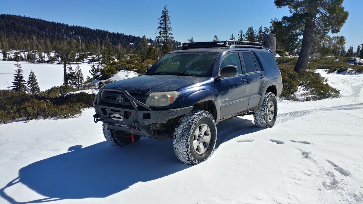

Those are 255/80/17 cooper st maxx tires. It rides well for a truck. My previous vehicle was a Lexus LS430 so I may be a bit used to a plush ride. It’s not too stiff or harsh and I just did a 1,000 mile road trip on it with no complaints other than needing to get uca
If my calculations are correct, your tires at 255/80 are actually taller than 275/70?
255 x. 8 = 204mm
275 x .7 = 192mm
your front wheel well looks a little tight with the wheel stright (maybe its the angle) so the 275's will actually have a little more space but could be a little more of an issue at full turn due to width. I hadn't considered that configuration because I wanted a fatter tire, but they fill the wheel well nicely.

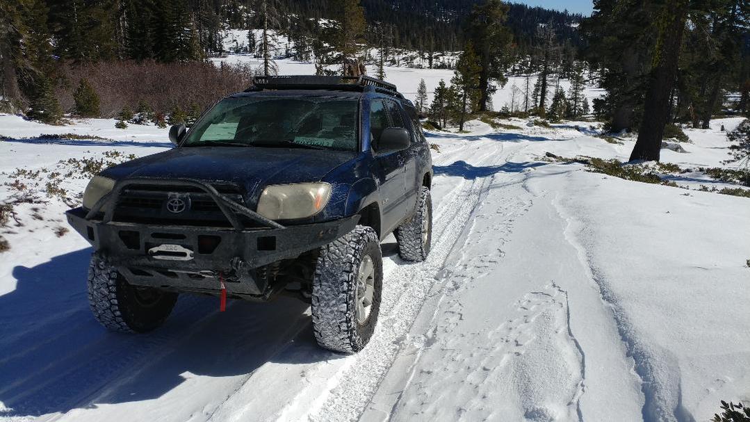

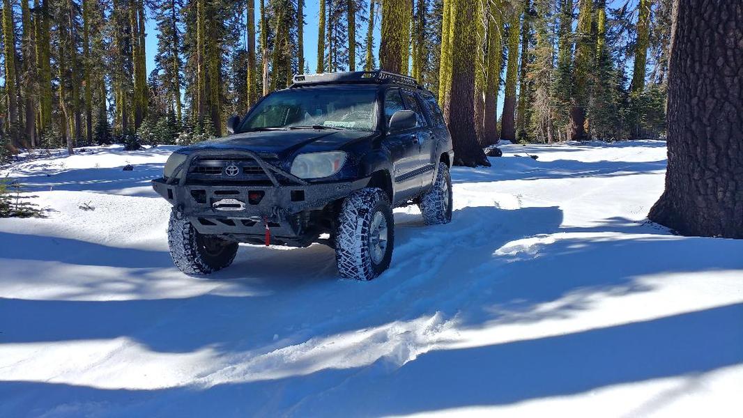

New tires, new bumper, same suspension. Seems like a lot of people are interested in this size and so was I, so I went with it.
Nitto Ridge Grapplers in 285/75/17 and Relentless Summit Bumper.

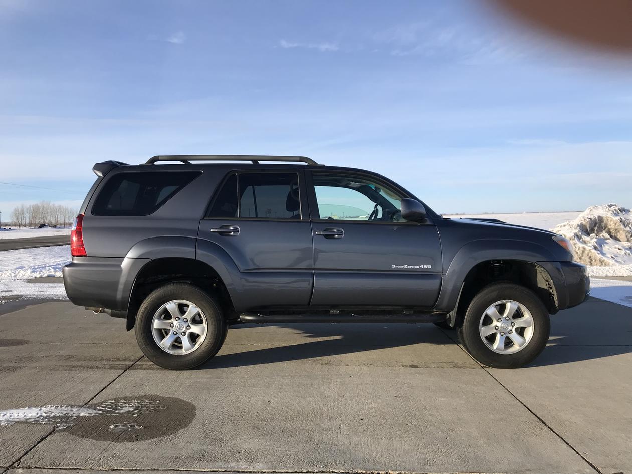

2006 4.7 V8/. Front: 884/nitrocharger sport/1/2in top plate spacer. Rear: OME 895E/nitrocharger sport. Rides great, and wanted to post for those with the V8 who are concerned with the 884’s up front. Tires are stock 265/60/17, next week is payday though!!

I’m going to assume 4x4? Was just wanting to see what mine would look like when I get my fronts in. Also *265/65/17*
Looks good! What tires are on the brain at the moment?
Yes 4x4. As far as tires...most likely 265/70/17. I’m just trying to keep it as clean as possible, until I have another daily driver. I love the KO2, but maybe a little too aggressive and pricey for its needs currently. Hankook dynapro are priced right, and tread life is good I hear. I was also looking at General grabber AT2, as they are a bit more aggressive and price is reasonable.
Dang so my front will be even high, LOL...you have hub to fender measurements front and back?

Nice!! Like that lift. Hey, could u post some pics of the front? Wanna check out that bumper. Planning to buy one soon.
That's my next size tire...34" right? How hard was it to fit them as far as rubbing goes?
Not as hard as I thought at first. I really didn't have to do too much. I even ordered a body lift in anticipation for moving to 305's or 285/75's.
I didn't install it though, because I wanted to do the better thing and I was inspired by some other users running larger sizes without the BL...
Long story short, trim some plastic, hammer the pinch welds (I didn't even hammer them completely flat), and obviously BMC.
The tires don't even come close to the 33.89" like they're supposed to be though, but definitely over 33". But my old 265's didn't come close to 31.6" either....
Anyway, slight rubbing at full flex still so I'll give it a little more work. That plus getting an alignment to crank the caster and leveling the front out a little bit should do the trick.
Sorry if I rambled, hope that helped.

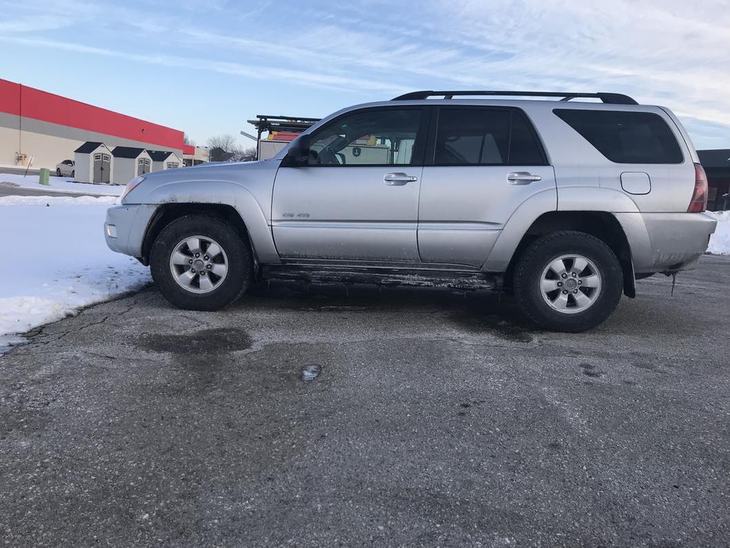

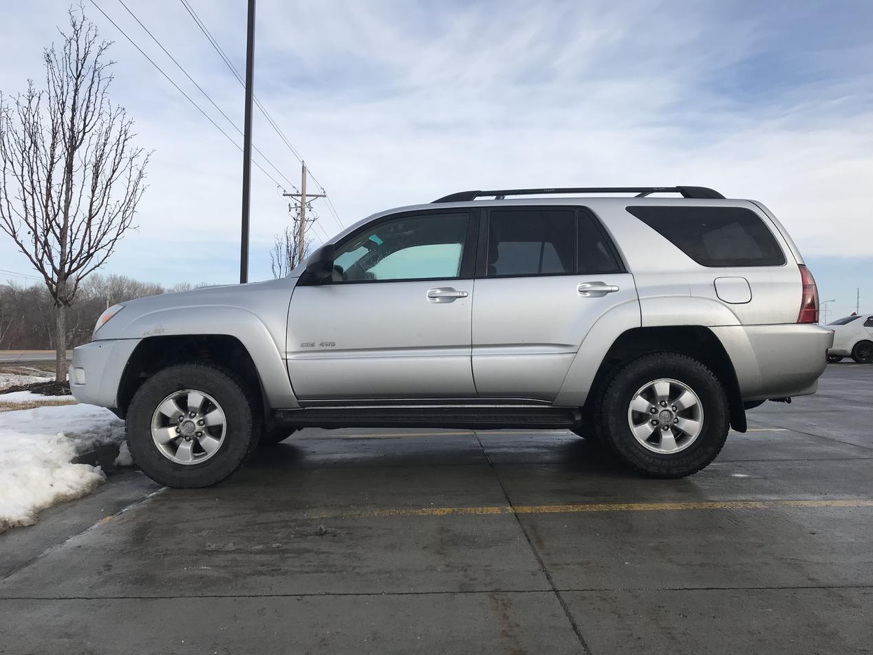

2005 T4R SR5 Rancho Quicklift struts front only
Rancho Quicklift leveling struts front only! Love the results and ride on the softest setting of the 9 point adjustment.
before and after! Sorry for the dirty rig.. Nebraska winters are no joke.
