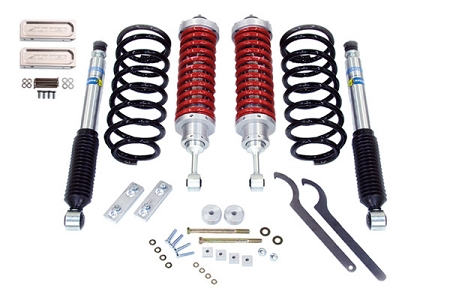

why did you install them upside down? your front coilovers...
Sent from my XT1635-01 using Tapatalk
Because they are "upside down" for 4Runners compared to tacomas
is it a thing now to install coilovers upside down?
5100s get installed "upside down" in the front on Tacomas and 4Runners. Just like factory coilovers and OME coilovers.
Rear 5100s, OME shocks, and factory shocks get installed with the shock shafts on the top as well.

Shock shafts are better protected on the top, but you can run into clearance issues with the axle housing. Twin-tube shocks can take a couple dents to the body, monotube's can't from what I've read.
Maybe mono-tube shocks work better upside down?

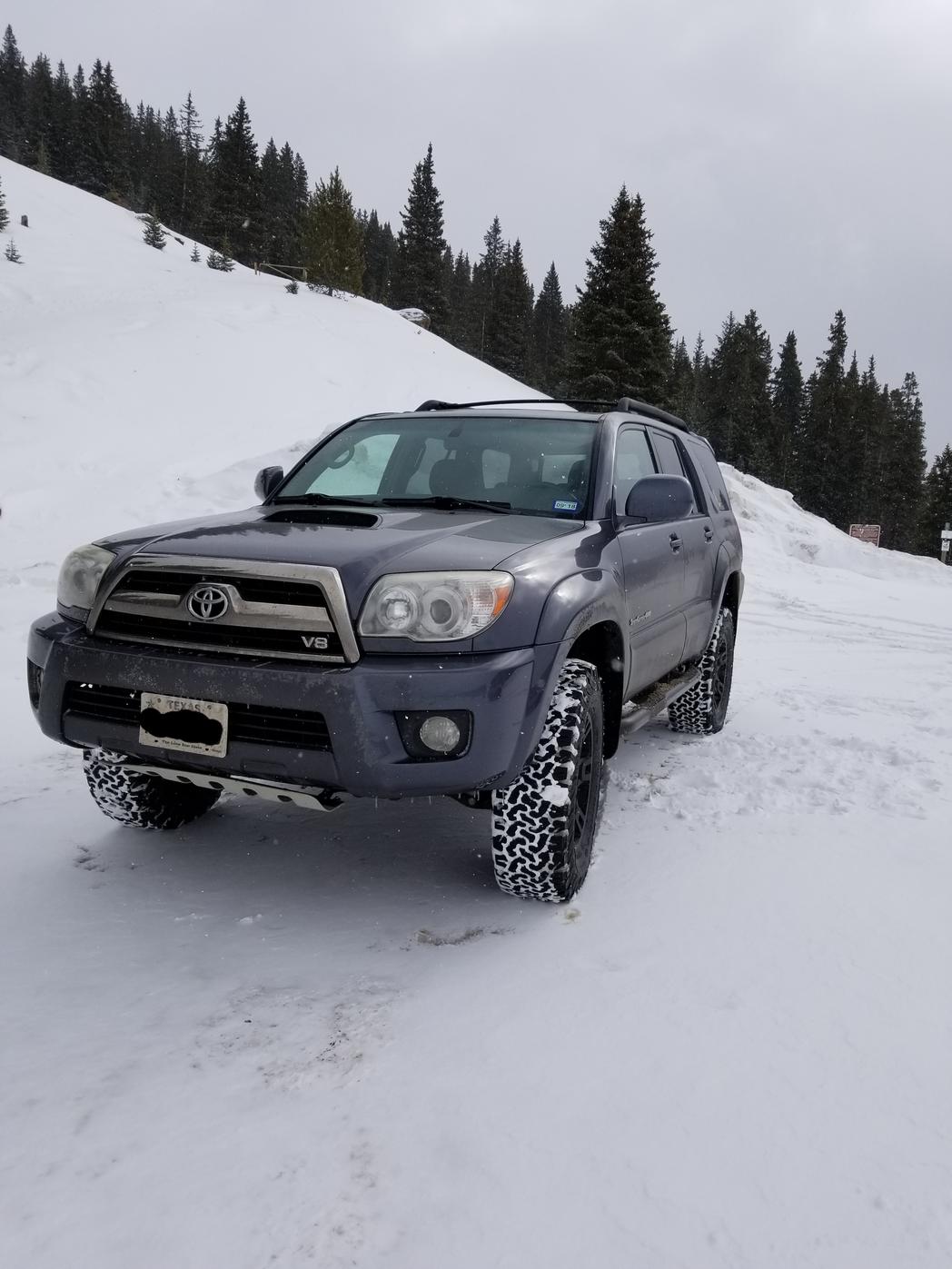

Got a quick question, if I get all bilstein 5100 and set the front 1.75. paired with moog fj springs front and 5th gen rear springs with a 1.5 inch spacer will that level out?
Sorry noobie here. Kinda on a budget here since the 5th gen springs were given to me.
Hey Guys,
I suggest reading the 4th gen suspension page. But with that set up you'll still have front rake and it's not recommended to adjust the shocks when using coils to add lift.

I would say go for that lift setup you just mentioned with 884 and Superflex. That’ll give you a perfect rake in my opinion with a 1”-1.5” coil spacer on rear driver side to compensate for lean. I’m doing the T12 springs in back for a little less rake with 884 up front. Superflex is ~2” and T12 is ~1.5”
thanks for chiming in...I'm still debating which setup and the almost $100 in shipping at wheelersoffroad for T1/T12 and 5100's is a bit of a problem for me.

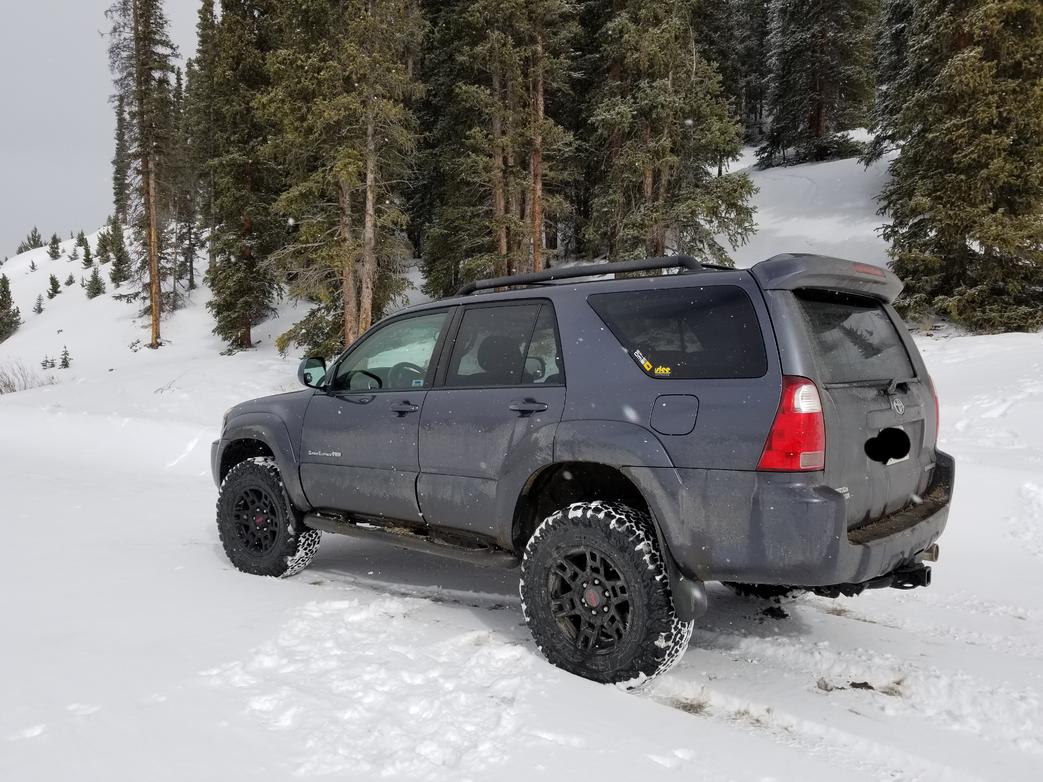

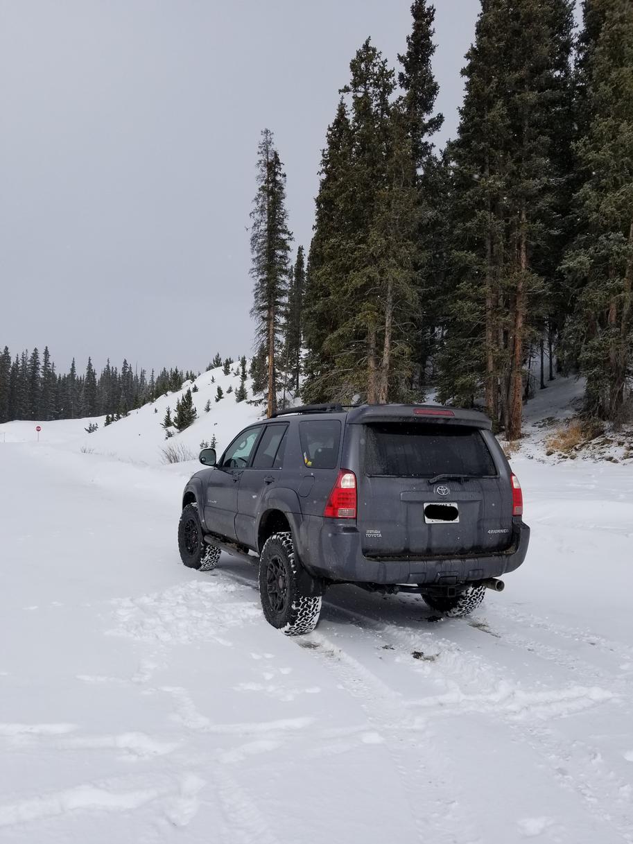

Those are 255/80/17 cooper st maxx tires. It rides well for a truck. My previous vehicle was a Lexus LS430 so I may be a bit used to a plush ride. It’s not too stiff or harsh and I just did a 1,000 mile road trip on it with no complaints other than needing to get uca
