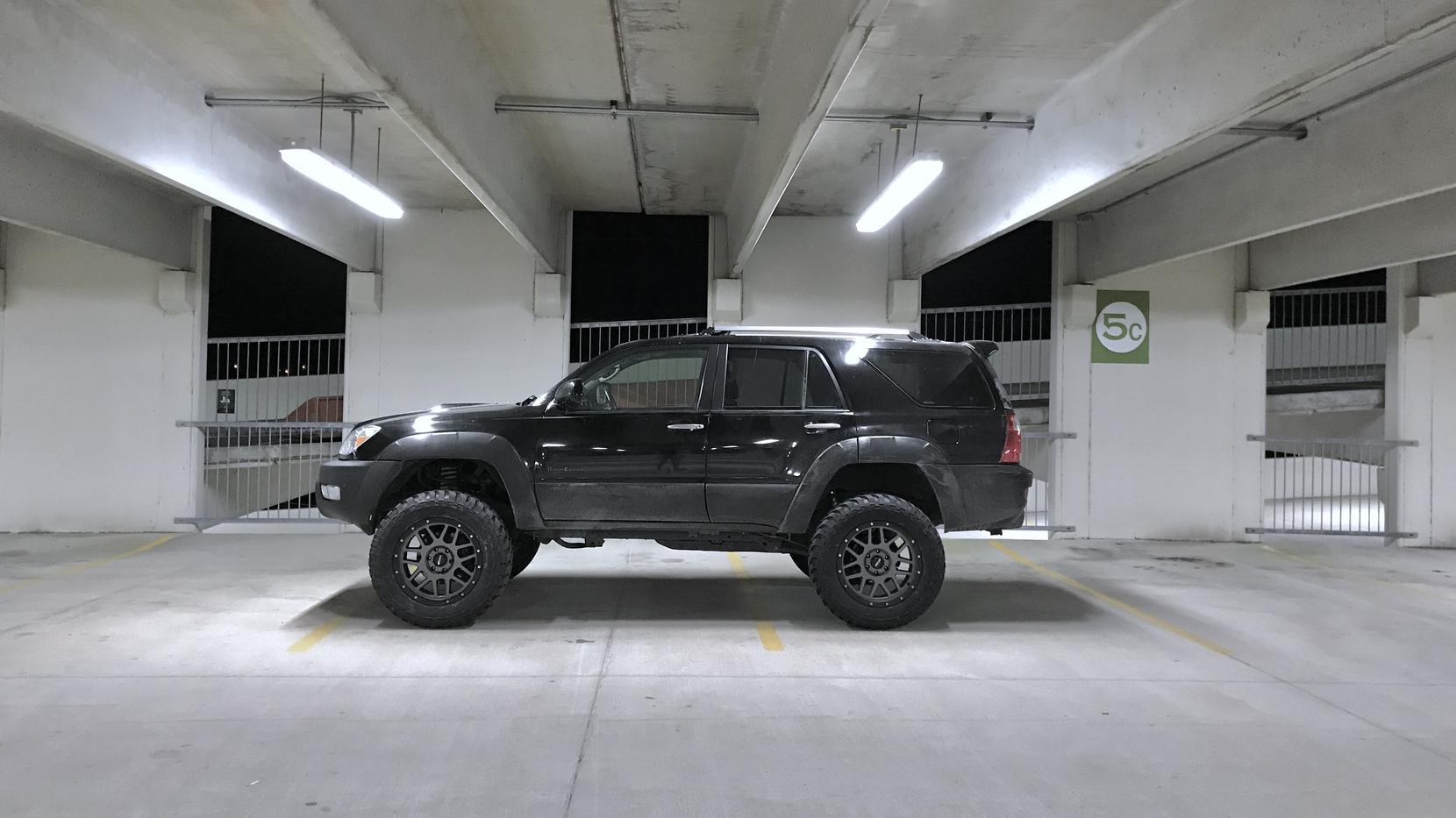

5100s Front set at 1.75, FJ Springs All Around, 1.5 Daystar spacer (rear)
Ride is much better after getting rid of the XREAS and spacer lift. I was unsure about the rear spacer, but I'm glad I kept it.

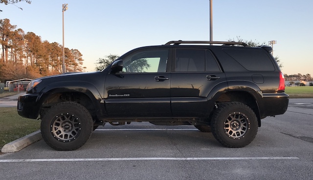

Wheels: 2018 4Runner Trail Edition
Tires: 275/70R17 BFG KO2's
Suspension: Stock Non-XREAS (OME 3" lift waiting to be installed)

Had to take a second look, thought mine was lookin extra clean for a second

The new wheels and tires look great! I am looking to pick up the same wheels in the next couple of weeks for my 04 T4R v6. I was also going to go with the K02’s but wasn’t sure hat size to go with. Have you noticed any rubbing with that size tire?
Honestly, I think 275/70/17 is the prefect fitment with these wheels. I have the tiniest bit of rubbing on the corner of square block part of the front mud flaps. Other than that I don't have anything major. I am thinking when I install the lift it will change the geometry just enough to clear that portion of the flap, if not I'll either shave it the most I can to alleviate the rubbing or just remove the flaps.

Are you running wheel spacers? If not are you rubbing on your ucas?
I’m looking at buying this same exact wheel and tire set up for my wife’s 4runner. She has the ‘16 sr5 wheels and 265/70/17 terra grappler g2s, and they look way to small but I didn’t want to have to add spidertraxx.

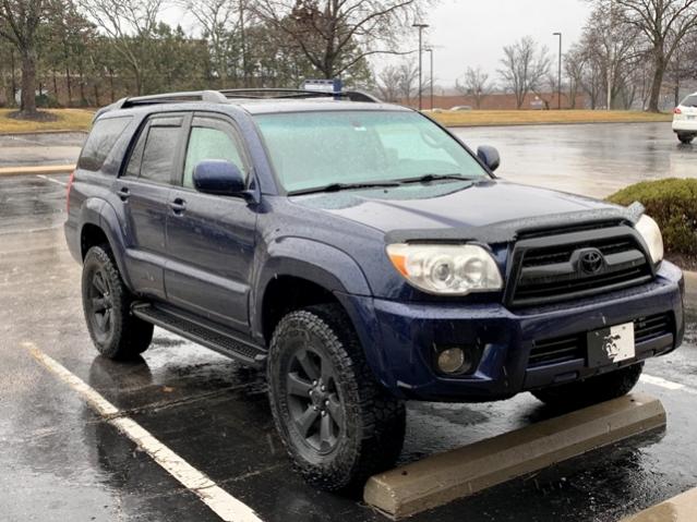

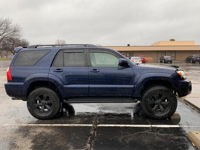

275/70/18 Falken Wildpeak ATW3
Stock '06 Limited wheels
Bilstein 5100's front/rear set at 1.75 with FJ coils
