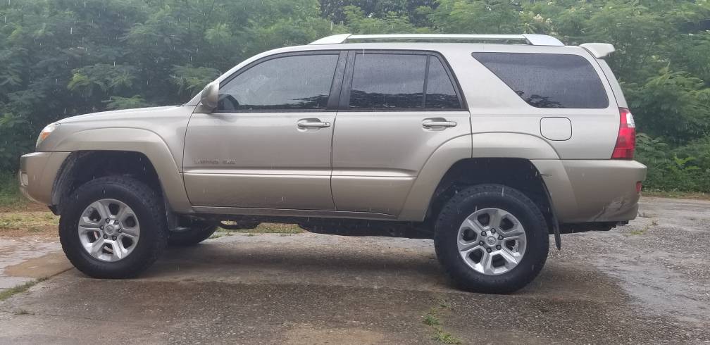

Been a long time coming waiting to put some suspension on my truck, but I'm super happy that I took the time to do this one right.
Setup:
-Toytec Boss (3/2 front/back)
-Total Chaos UCA's
-Falken Wildpeak at3/w in 275/65/18
-Also have 1.5" wheel spacers
FYI 275/70s would not fit with the back spacing of these 5th gen SR5 wheels.
Setup:
-Total Chaos UCA's
Looking Good!
How do you like the ride on your set up? I'm also considering that tire size when I upgrade, seems like a decent compromise in size for daily drive and off road. What load rating are they?
Looking Good!
It rides really well. I don't really get much wandering or anything as the UCA's have some built in caster. As for the toytec coils/struts, they handle better than my stock suspension did (stock was at about 108k miles).
As for the tires, they're 116T rated (I'm 95% sure, can't check right now).
But yeah, it's a nice setup and should work for daily driving and the occasional wheeling. Although after installing it my truck sits taller/is bigger than I really expected it to be, which isn't necessarily a bad thing.
Yeah, I do rub on the front side of the fender liners. I'm gonna either move the entire liner forward this weekend or take a heat gun to it and try to bend it forward a bit.
Cool, thanks for the info. I think for the first time I have a pretty good idea the set up Im going for.
