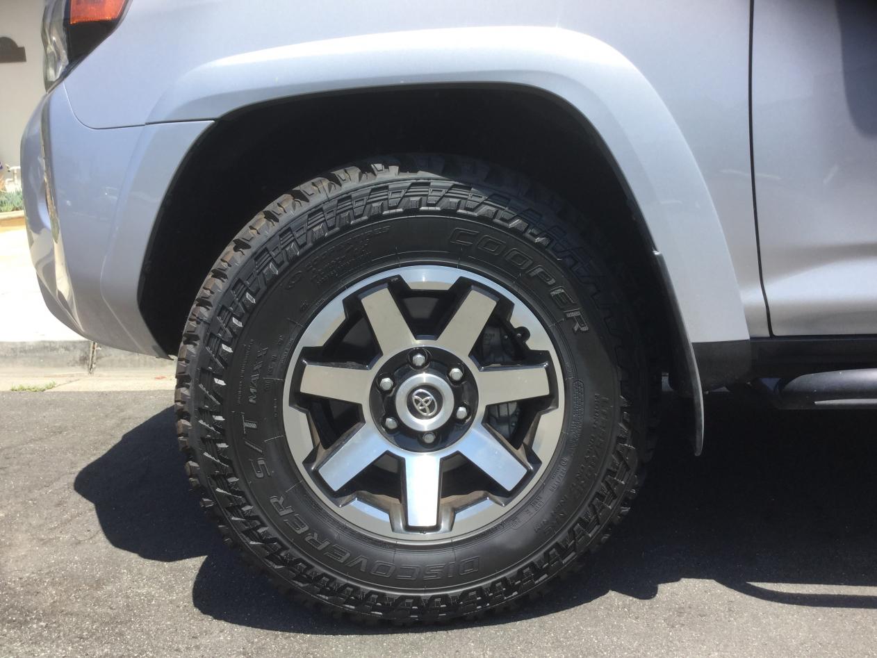

For those interested. I just put Cooper St Maxx 255/80/27 with no lift and there is no rub. Even took it off road on a fire trail to camp and none.
On what wheels?
When I put BFG 255/75-17 KO2's on with a Daystar 2.5"/1.5" lift, it rubbed pretty bad. I ended up having to trim.
I have the black TRD Pro Wheels.
On what wheels?
i have 255/75/17 AT51 kumho with a old man emu low lift and only get a little rub in reverse at full lock - i have 15mm FJ cruiser wheels 17x7.5 et15 i believe
