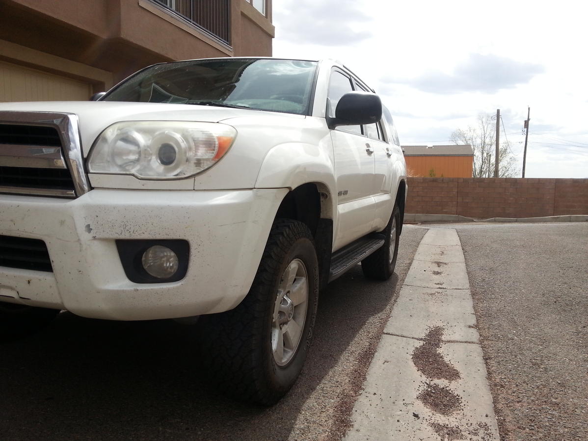

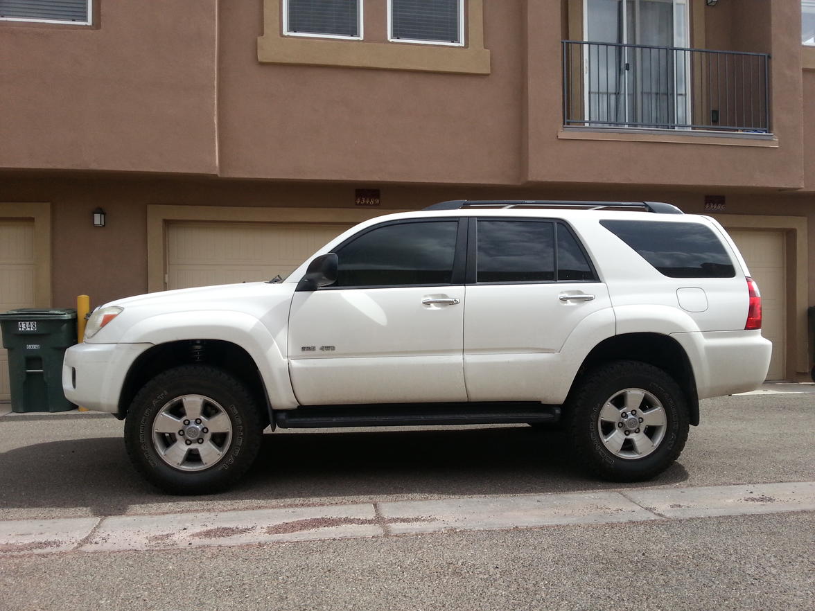

I ran General Grabber A/T2's 265/70/17 for a week after toytec ultimate lift. Too small for me but with stock wheels cleared the UCA, maybe a 1/2" space. Heres some pics with those tires and Toytec Ultimate lift installed.
Not bad, but I agree bigger tires would look better. How do you like the toytec ultimate lift? Ride on street/offroad/handleing? Did you install it or have it done? If you had it done and dont mind me asking, how much did it run you for install?
If you did it, how long did it take you?
Sorry for the question blitz but if im going to go balls deep into this truck at 105k miles I need to know im doing it exactly right. And I appreciate the patience.
No problem, better off doing it right the first time! I've had it about a month now and the ride is awesome, so much better than stock, especially because at 107k my suspension was already sagging pretty bad. Off road its great, I received bilstein 5125 instead of 5100's because at the time there was a shortage on 5100 rears. Actually kinda glad it worked out that way because I get great flex with the 5125's. On the road its a little stiff but not uncomfortably so. I actually had it done since I've never worked on suspensions myself, paid $300 and took the guy and a helper about three hours? I definitely reccomend the Ultimate, for the price you can't beat it!
