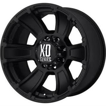

How does everyone feel about these wheels..
17x9 xd series Revolver

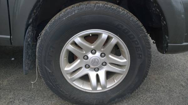

Are the wheels from a 2005 toyota tundra v8, The same offset or backspace as the FJ wheels, where it allows you to fit bigger tires without wheel spacers?
