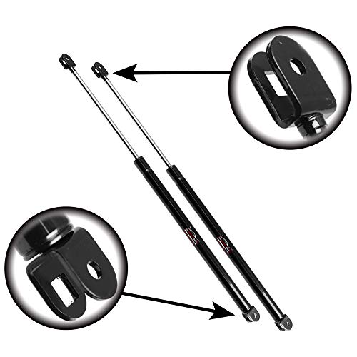

I figured a detailed photo is always helpful to somebody in the future who is replacing the back liftgate supports. Searching this forum I found useful information on getting spacers and washers to fit between the connection brackets. Problem I ran into was the difference in the top ends of OEM and StrongArm. The existing pin is made to seat into a square hole and won't work with the holes in the aftermarket one. And even if I was able to make a square hole in the new support, the bracket metal is thicker so the pin won't quite clear enough to put on a c-clip. Sooooooo....looks Like I've got to find a new bolt/pin of correct length to get through the hole and allow a c-clip.
Yea I can verify the strong arm’s that I got had the square hole and fit fine for me. Looks like they sent you the wrong thing.
Thanks for catching that. I called the company on the shipping slip and they said they know that there is a batch of 4286 Strong Arm lift arms they are having to send back to the manufacturer. I said I still need to buy some and they said don't order from the same Amazon source but places like AutoZone can get them. Just to make sure that the other sources aren't buying them through them at AMS Automotive. At least now I know what to look for if I find more.

Not to beat this to death, but seller wants pictures and more explanation before processing my refund or exchange. This whole third party thing with Amazon is nuts, with 3 layers of distributors and China somewhere at the end. Made this detailed explanation pix. Sigh.
Regarding wrong item that was sent:
Those don’t even look like strong arms.. wtf.. sent you the completely wrong product? Says rhino pac on the package..?? Don’t remember my package looking like that, I think it was a plastic sleeve. I got mine from rock auto though.
Edit: they are definitely trying to play you, AMS is a totally different brand than strong arm. Get your money back and order from rockauto IMO..
2000 TOYOTA 4RUNNER 3.4L V6 Lift Support | RockAuto
Scroll all the way down to the bottom of the list for the strong arms
you're right. I ordered from Amazon, the packing slip list AMS, and some other company called Import Replacement Parts is asking me for photos.
