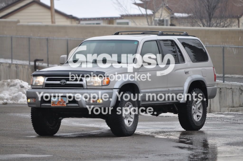

So im kinda new to the forum and i want to ask a few quick questions if you guys dont mind. I was looking at all the 3rd gen lift info and i am a little confused. I love the look of this 4runner its the look i am goign to go for when i lift mine i am just doing a little research befor ei decide to pull the trigger. I am thinking of going the OME way but when i look at the set up that econ did it looked to me like he did the 881 2.5" lift coil for the front and 906 2" lift coil in the rear. Am i reading this right or am i missing something, wouldnt that make the front higher then the back. ???:confused:. could someone please explain. Do i need to do a diff drop for this setup? Also what is the best price around for this setup i found what i beleve to be it on a website for $699 +$100 to build the fronts. Thanks for all your help in advance.
I read the same thing about the 881's, but i don't really think 2.5" is accurate. Many people include a top out spacer with that particular coil, and I think that would be closer to 2.5". I think the 881's are slightly less than 2" once they've settled a bit. I don't have any negative rake. It is just barely raked from back to front. I really like it. In fact, the stance couldn't look better, IMHO. I don't have the diff drop, but I'm watching the CV's like a hawk. There is some debate about this. Toytech told me I wouldn't need it, but some have said that they still do. I don't think I'll end up getting it, but I may replace the boots on my CV"s sometime in the future if there is a problem. www.trdparts4u.com has the lowest price on my particular setup. $716 I believe. However, they are not preassembled, and don't offer the service.

I haven't had a ton of weight in the back yet, but I am certain it will not sag as bad. I've stood on the back, and it didn't sag all that much. Without knowing how much weight you intend on putting in the back, I'd say this will hold up great.
Yeah, econhonda is right about the 881s. With the top spacers, you'll get 2.5-3", but without it ~1.5-2". No spacers and it should sit level with 906s, with spacers it should sit level with 890s.
Get the diff drop, it's only $25. Don't be surprised if your stock CVs leak and tear with or w/o the diff drop though. The stock axles just don't usually like the new angle after so many years of being at stock height.

Tires are treadwright guard dogs - 265/75/16's (retreaded tires). I was very skeptical at first, but after months (yes, months) of research, I was sold. I read countless reviews on Jeep, Dodge, 4X4 forums, and never once found a firsthand story of failure of one of these tires. I read about wheeling expeditions, heavy towing, and daily driving that all saw great performance out of these tires. As we all well may see later in this thread, there are definitely those who won't go near them. That's fine. I will. So far, they balanced great, they ride great, and the price is unbeatable. $427 shipped to my door. I usually am a "you get what you pay for" kind of guy, but I do believe this is one of the rare exceptions.
That said, the lift performs very well on road. I definitely feel more stability over bumps, but it's not as "plush" as I imagined it would be. It's just stirdy. Firm.

They are Load Range D's. I specifically requested Goodyear MTR sidewalls. They are noisier than my old cooper all terrains, but not that bad. They produce a high pitch sound at speed that isn't too noticeable, and not at all distracting or annoying. It is quieter than I was expecting.

I thought I'd post some updated pictures as I have changed a few things around. I ended up giving in and took off the running boards. I like it. The wife does not. I also popped some Hella Optilux Yellow fog lights in when one of my bulbs burned out. Some 1.25" All Pro wheel spacers also found their way on to my 4runner this weekend. What do you think?
