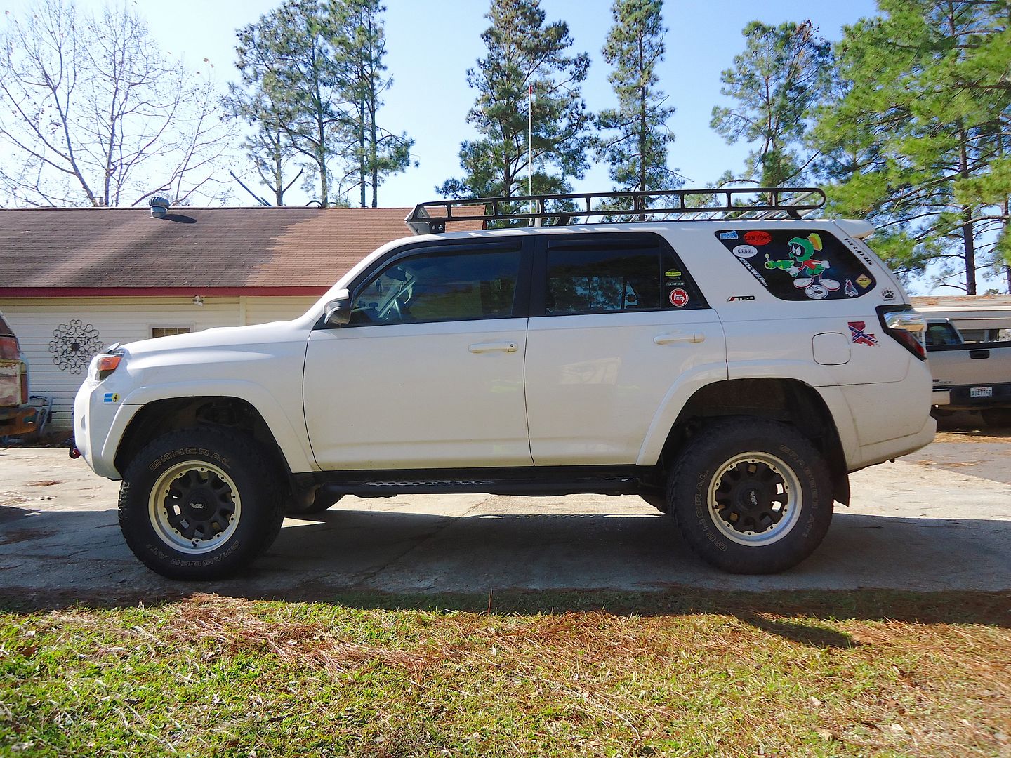

This is mine with 5100's all around. Set @0 with OME 885's in the front to offset the weight of the SSS bumper and winch. Toytec Superflex 2" rears and nothing loaded in the back. So with 883 or 884 in the front and 0 on the setting you should end up with something along these lines. It's taken me a little while to get used to it because I was running level or slightly reverse rake for the first year. No sway bar relocate and I'm nowhere near any real caster in the front because I am still running factory UCA's, but it handles fine. If this looks good to you then you should be fine. Or you might consider running SAW 1.5's in the back to cut down slightly on the rear lift. In hindsight I might have gone with the SAW's, because I really liked the leveled look. This way I feel like I have returned to the factory rake.

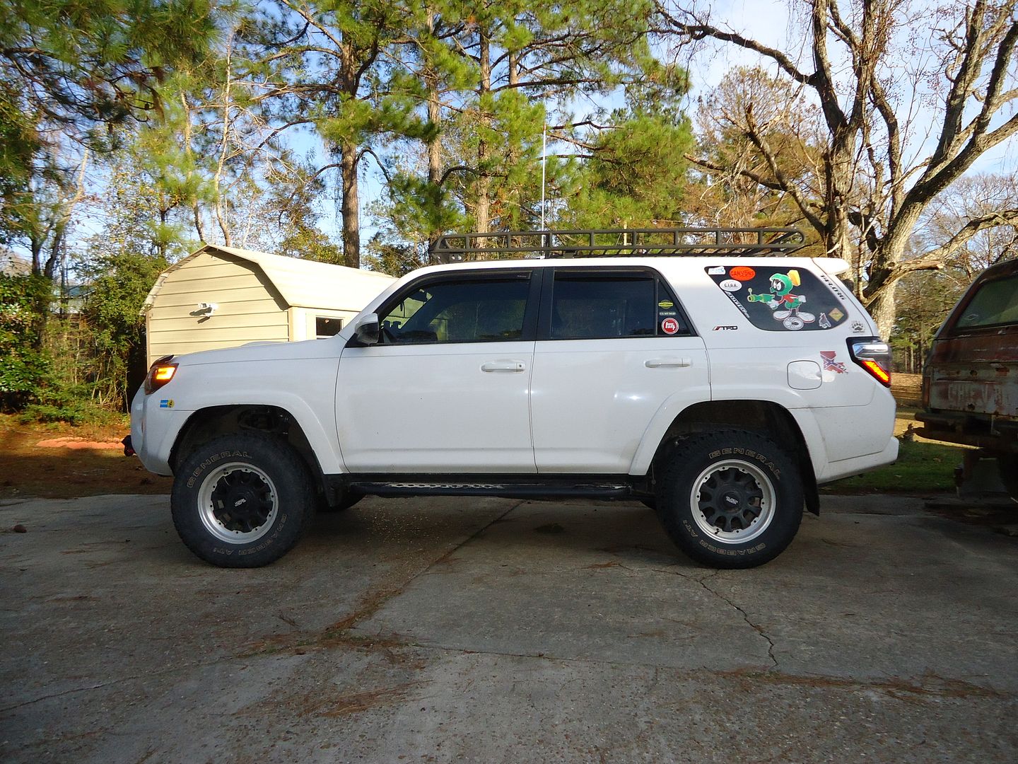

This was OME's in the front with 1.25" spacers on factory rear springs. So I'm guessing the SAW's would be somewhere in the middle.
I am at about 2.5" up front with stock UCA's but i think I'm going to get new ones this summer, it's a little twitchy on the highway. The spring rate on the SAW rear coils is the same as the super flex so that might work better if you only do 2" up front.

You will lose the comforts of a nice factory ride going with OME which is why I saved my pennies and invested in Icon. OME is an expo setup designed to carry lots of weight. I have had OME in my Rav, 3rd gen, and Landcruiser. All were stiff and a little bouncy. Overall a great upgrade but not designed for comfort.
