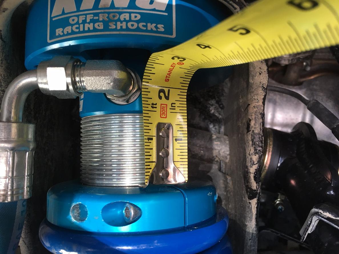

The driver Coilover which I adjusted shows 1 3/4" of thread. Passenger is 1 1/4"
Not able to take detailed measurements at the moment but I can verify that my driver's side coil doesn't even have a full 1.5" of thread showing...guess I am within the acceptable limits?

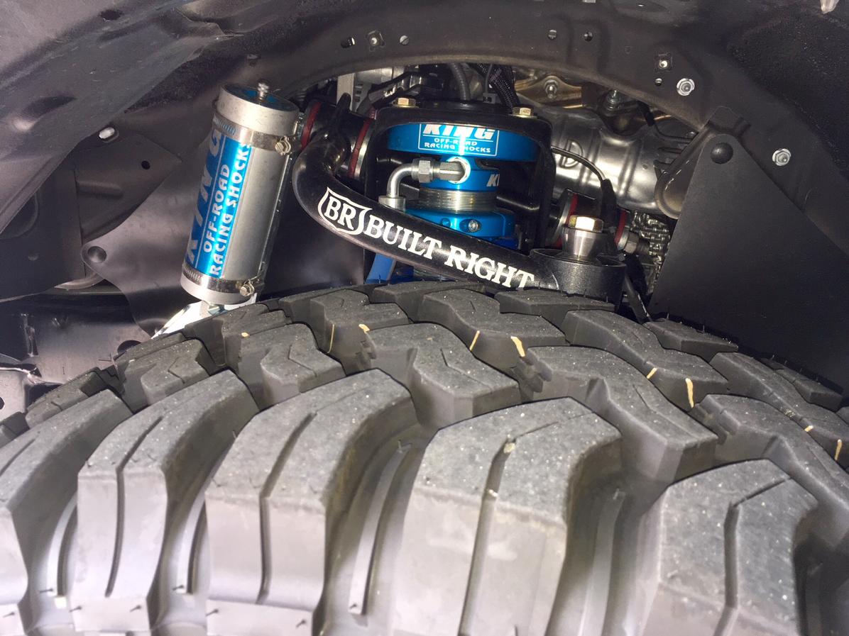

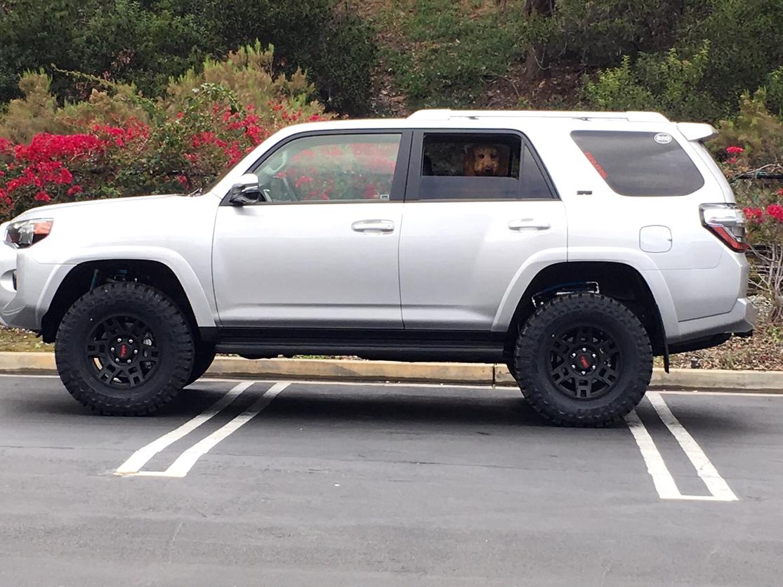

how many threads are showing? also, can you post a side pic of your runner? i'd like to see how much forward rake you have with the rear 2" springs.
This is how she sits now. Post #52 shows the driver side shock threads, looks like 5 or 6.
awesome. thx! just about where i'm at but i'm thinking a couple more turns on each side would be perfect and still give me a slight forward rake.
