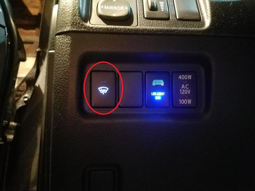

I used a $10 KO switch off and tied into the circled switch for the back light. the only issue is that I had to bevel the side of the push button to prevent it from sticking. 5 minutes with a razor blade saved $20 or more.
Did you link it to the dimmer? Does the push switch hook straight up to the kit?
