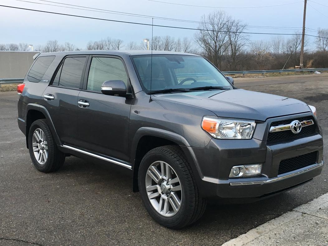

Mild not wild... roof rack delete, factory mud guards, 275/55-20’s, 19mm spacers.

Where did you find those 19mm spacers? The only ones that I've seen have been 1.25" (so around 33mm). Also, can you post a pic of your 4R from front or back, so we can see the stance? I'm looking at getting the same size tires and want to add spacers. I'm curious as to how those 19mm spacers look with those tires. Thanks

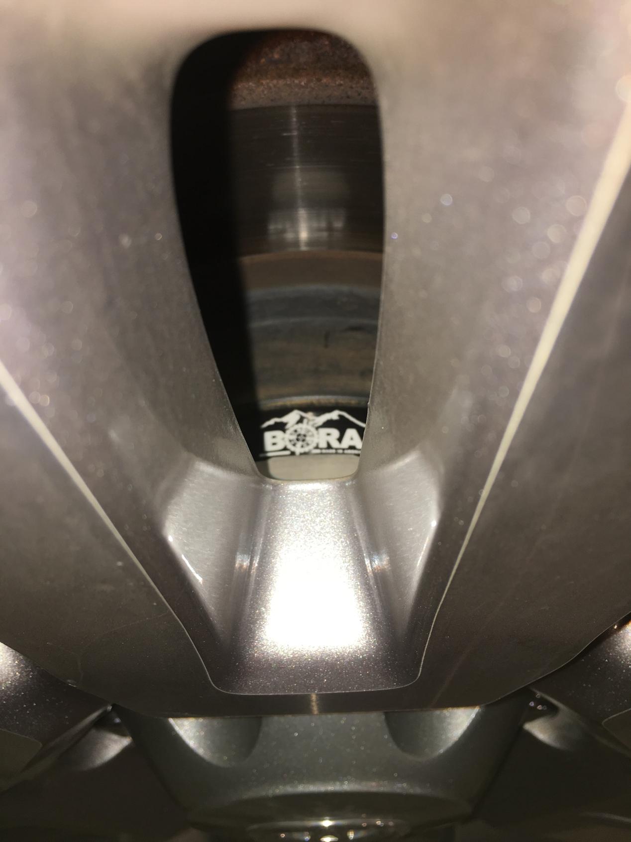

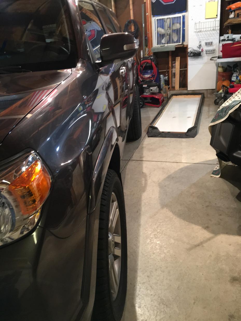

Just getting a little morning coffee before work. I’ll look up where I ordered the spacers from tonight. 19mm is a 3/4” spacer. Mine were anodized black. I know Ichaba makes a 3/4” spacer that’s bare aluminum ( have some on my X-RS ), you have to contact them directly, not listed on their site.

Did you extend your wheel studs ?

That stance looks great. It makes me think that a 1.25" spacer would have the wheels sticking out too far.
Maybe someone with the 1.25" spacer and 275 tires on the Limited wheels can post pics!
Yep, that’s where I got mine. I’m pretty picky about mods on my vehicles after good and bad experiences over the last 35 years or so. Was very satisfied with the fit, finish and results using this brand of 19mm spacer. Track width ( to me ) looks perfect. Debris from tires are still covered by mud guards and wheels inside of fender wells.
Am I reading the description correct. Do you have to buy your own nuts for the spacer to hub?

Every thing you need to install the spacers is included. That being four spacers and twenty four conical nuts to install spacers to hubs. You’ll need to apply locktite to factory studs. I like to use sleeve locker ( the green stuff ) .
