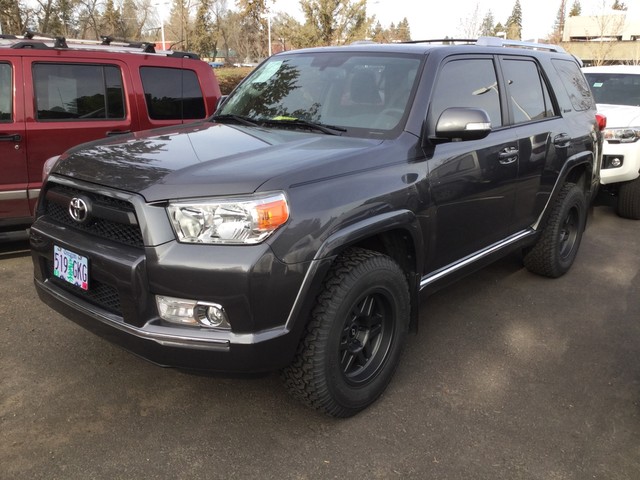

Stock; OPOR Sliders
IMG_2082_zps4yitneqo.jpg~original

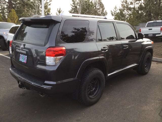

2/1.5 Lift; TE Rims, 275/70/17 KO2; OPOR Sliders
4Runner%20w%20Lift_zpsevpjdsqh.jpg~original
Does the increased backspacing and offsett (yes i know its only 2mm) cause inerference issues with the TRD Trail wheels?
No rubbing, even at pre-lift. Sorry, I don't know about the offset. Also note, these are the older Trail wheels (pre TRD Trail). Don't know if they changed anything. Be aware that there is some variance with alignments so your experience may be slightly different. If there was rubbing, the fender liner mod would fix it if you go with 275/70.

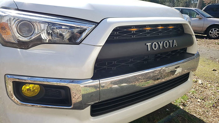

got around to swapping the grille after coming back from hawaii. also installed the raptor amber lights too.
