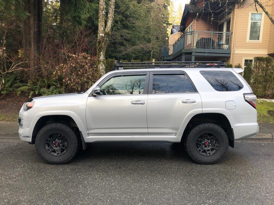

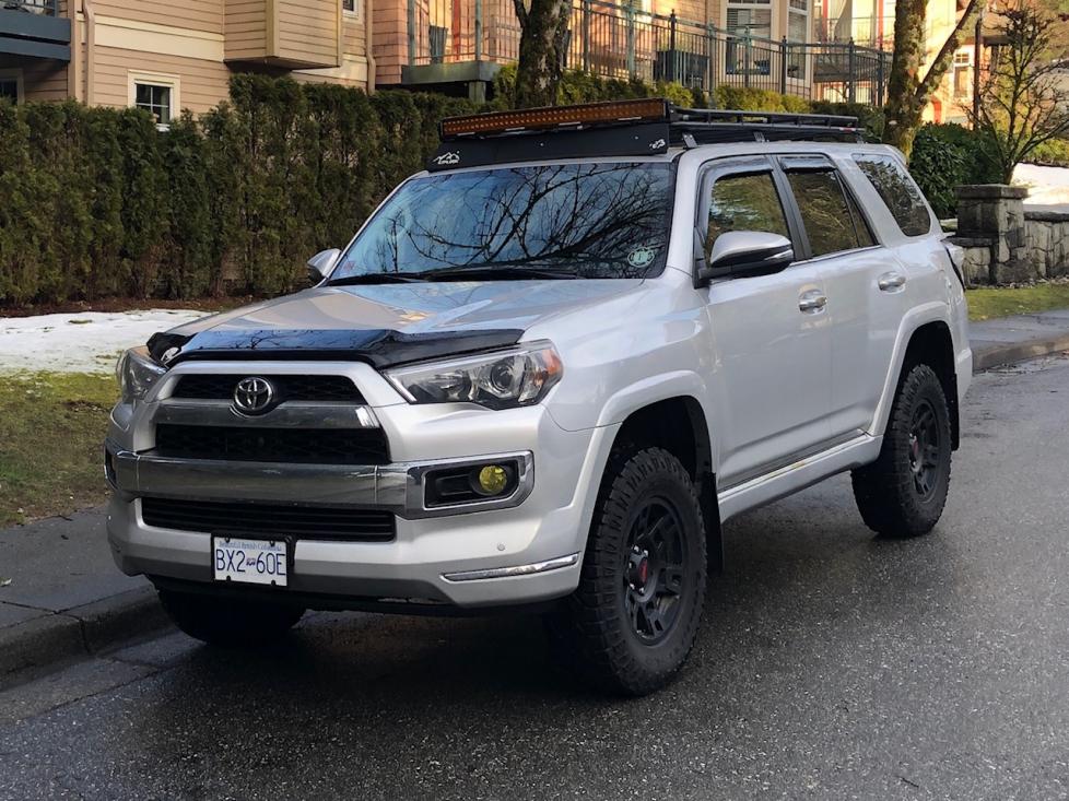

Hey everyone, just picked up my 2015 Limited a week ago and been busy swappping my gear from the trail edition i traded in. So far i have added: daystar 2.5/1.5 lift, trd pro wheels mounted to 265/70/17 duratracs, gobi stealth roof rack with rigid rds light bar, 6” rigid rear spot lights, weathertech floor mats, all lights changed to leds, headlights changed to HIDS, and laminex for the fogs, avs vent visors, toyota bug deflector and removed the running boards. Next up will be getting rid of all the chrome, Just have to make a decision if i go vinyl or plastidip for that.
And for anyone wondering why i traded my trail for a limited it was mainly for the full time 4 wheel drive.

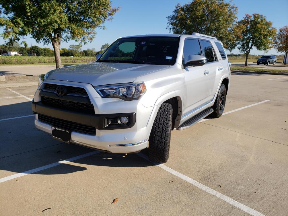

Our 14 LE has the chrome boards and with the rocker panel you only have maybe 2-3 inches to put your toes on and get into the truck. On my 18 LE, I removed the LE rockers and put the trail rockers with the little molding front cap and new mud flaps on with the trail running boards. Much nicer step into the truck and I like how the black offset on the silver truck.

Front End Conversion Complete.

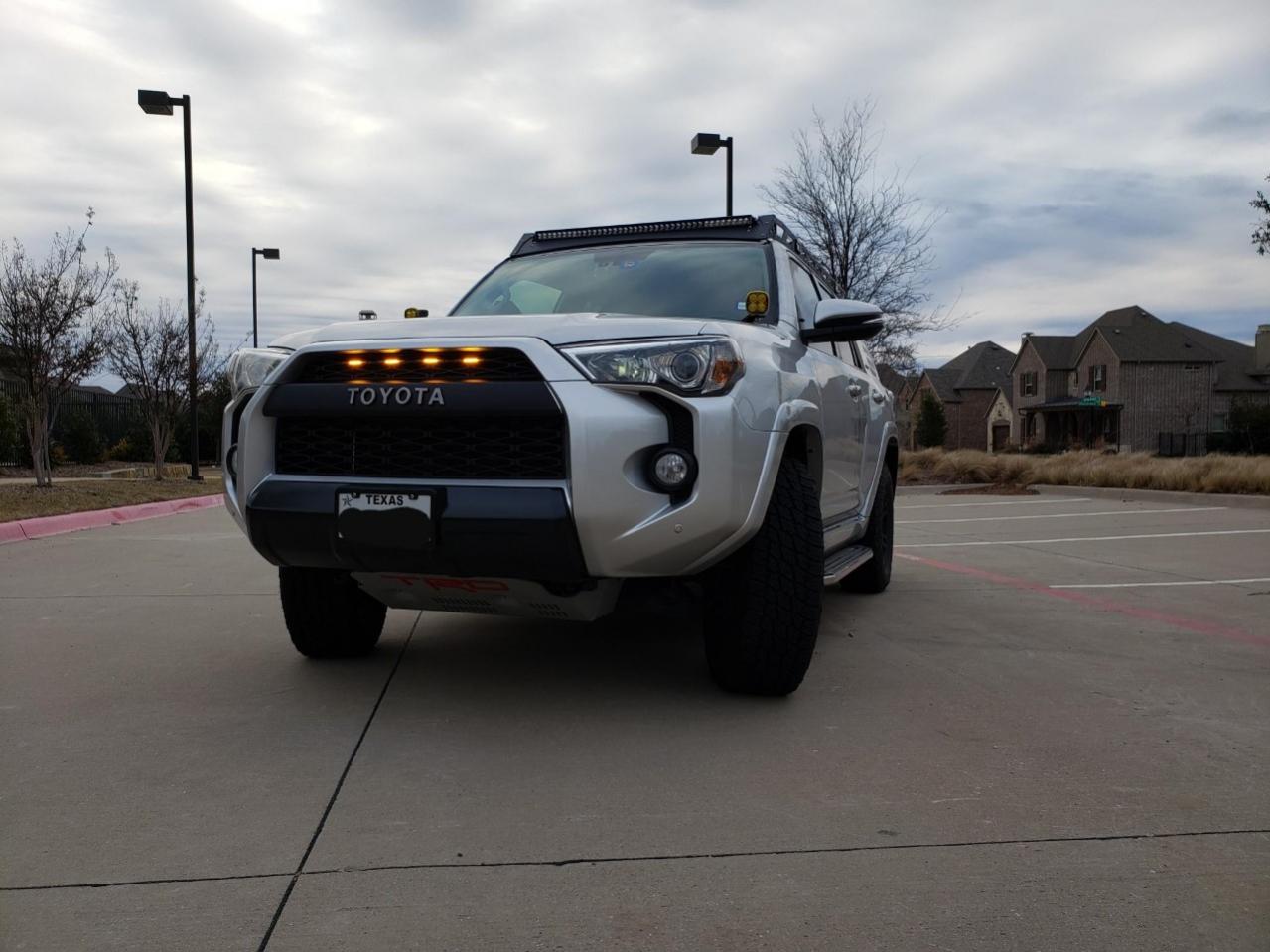

Finished my front bumper Limited to a TRD Pro conversion this past weekend. I'm real happy with the end results. Old to New pictures below.
dktxt4r, wow that looks awesome! I'm just starting the swap myself and have a couple of questions...
Were you able to use the bumper mounting brackets from the LE bumper on the new one?
Where did you get the new bumper? I found an unpainted one on ebay that seems like it would work, but could be sketchy...

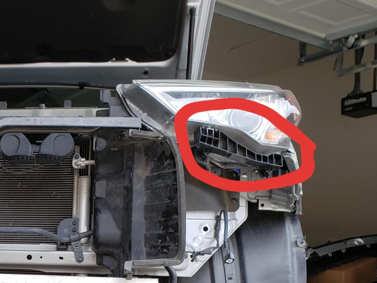

Which bracket are you referring to? There's a plastic piece that runs along the bottom side of the head lamps that don't need to be swapped out. The one's at the bottom front of the head lamps need to be swapped. See photo below circled in red.
There was a forum member selling his trail front bumper because he purchased a full steel aftermarket front end. He gave me all the parts I needed for the front bumper swap. I took it to a local shop to paint and it cost me $480. If you can find a front end with the same paint color, you'll end up saving a lot of money.
I also plastidipped the lower valence in black. I have a C4 fab low pro bumper on order so it will be going on when it arrives.
*EDIT additional info
You're also going to need to swap out several other pieces in the front bumper to do the conversion. You can reference [MENTION=126538]2nd Chance[/MENTION] thread for everything you're going to need for the conversion. His build thread gave me the info and confidence to do this myself.

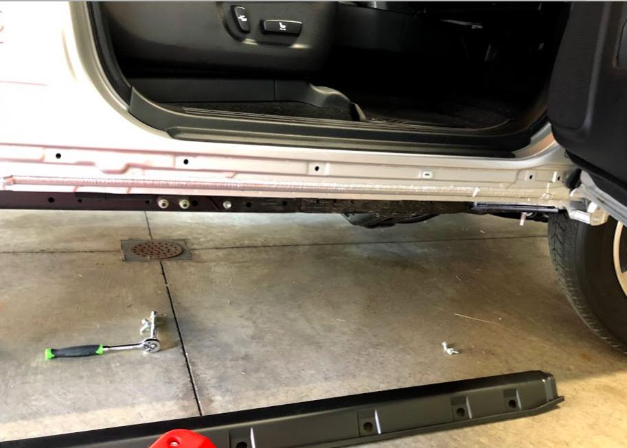

I removed the LE rocker panels and installed the N-Fab Predator Pro steps.
I had no rockers for about 3 months until I was able to cut the rockers. I used Antman's instructions as a guideline.
It didn't look too bad without rockers at all but if you're willing to cut the rockers, I feel like it improves the look a lot.
I documented my process with pictures. Hoping to put that all together and post sooner rather than later if it would help others who are thinking about doing it.

she looks awesome. so what suspension and wheel/tire setup do you have? i'm guessing stock xreas with trd pro/275's?
Stock X-Reas with TRD Pro 265's. Working my way to upgrade the suspension when the funds allow or when x-reas craps out. I would like to lift it a couple inches eventually but haven't researched enough yet on best setup for me.
