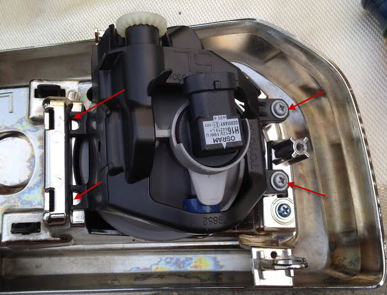

I do not know if they will fit or not, but you can look at my thread on installing Morimoto direct replacement LEDs on my limited back in the day and from the photos it appears the Baja brackets are very similar to the OEM Toyota lights mounting positions. Can also contact Baja and ask.

You're welcome! Also I checked and the OEM part number for the foglights is the same for all models for at least model year 2014. I see you have a 2015, so I would think the Baja kit should fit. If you buy, verify return policy with vendor in case.

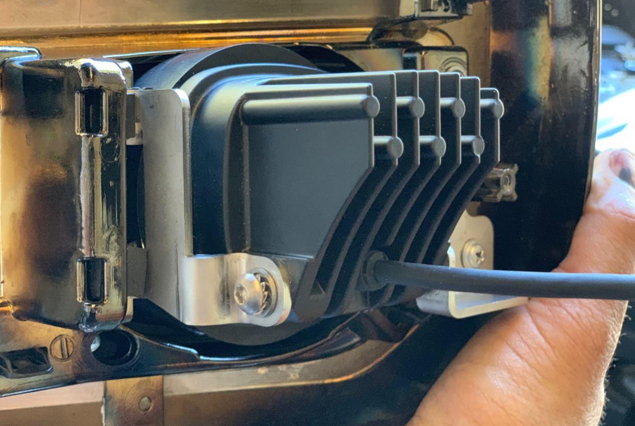

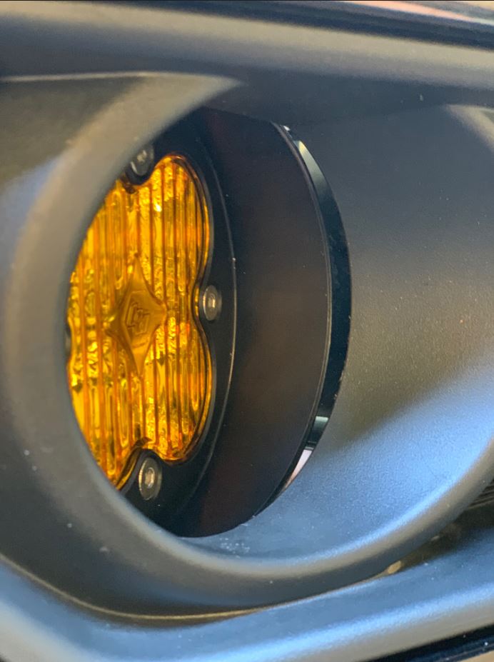

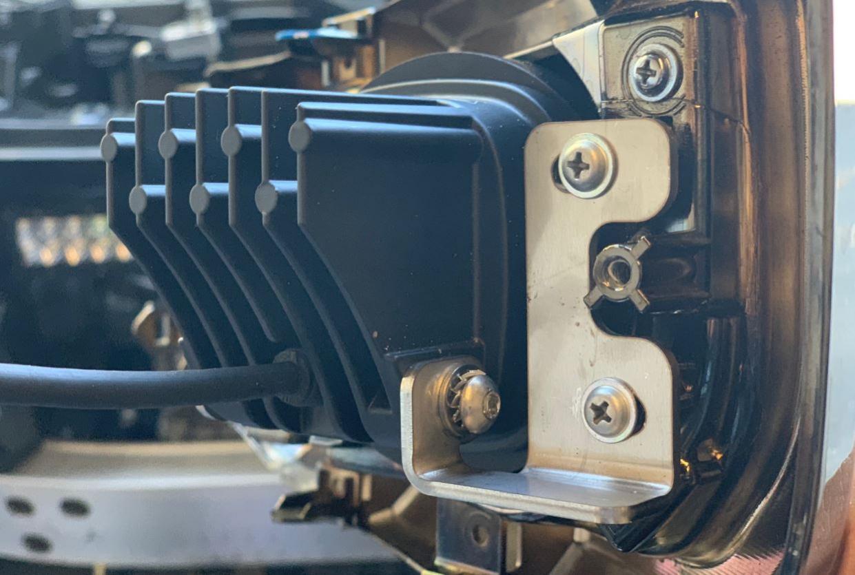

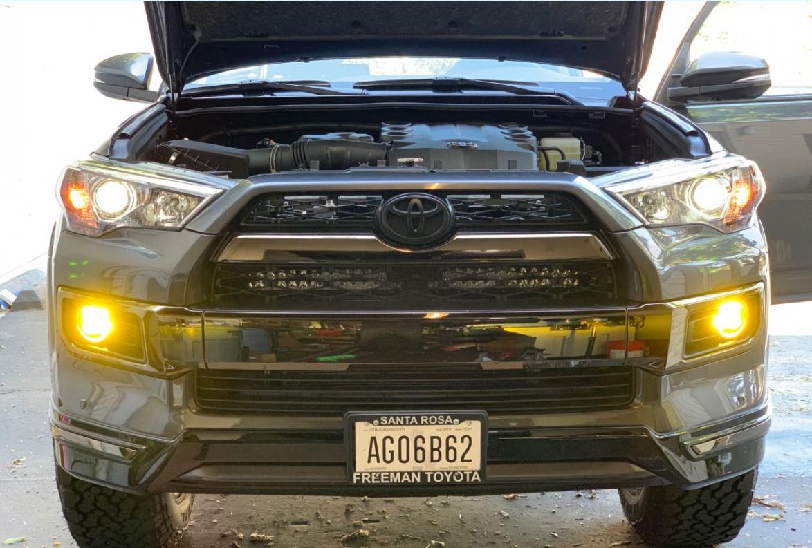

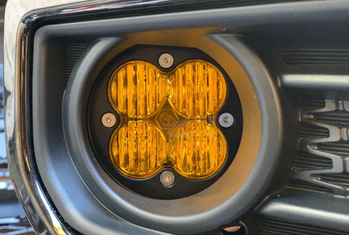

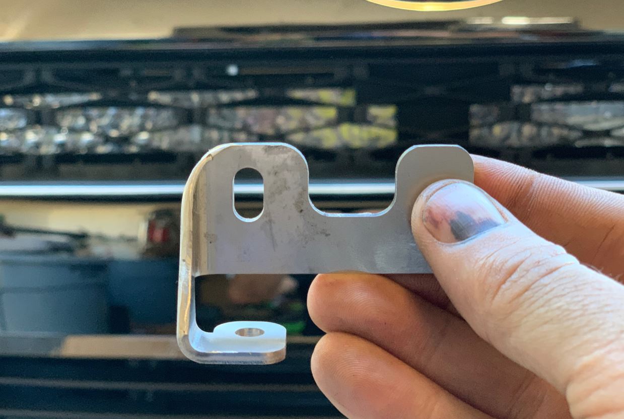

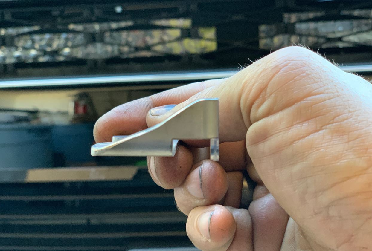

OK, so it turns out they're ALMOST plug and play in the Limited. A flange on the outside bracket interferes with the bumper, so you need to trim one or the other. I chose the bracket. The last two pics show how I cut down the flange. Took all of five minutes each side with a Dremel tool.
They generally look pretty sweet installed, but have the same ugly gap on the inside that they have in the non-Limited fog light pockets.

Yeah, glad to help! They're SO MUCH brighter than stock. Too bright to leave on regularly. I used to semi-forget and leave the fogs on in my 2015 TEP, and that'll literally never happen with these, lol.
I even had LED replacement bulbs in my old Runner that were definitely brighter than the OE bulbs and this is *four times* brighter than that.
I like them a lot.

Totally get it and, honestly, the main reason I wouldn’t leave them on all the time is they’re not legal at this brightness/intensity. They’re crazy piercing. I wanted *BRIGHT* and I got more than I expected. That said, Baja Designs has a new light called the Squadron SAE that’s street legal. Might be worth a look if you really want a set.

I appreciate you posting the pics, good to know they are nearly bolt on ready on the Limiteds! It would be the SAE in amber version that I'd be going with, need them to be street legal, cops are horny for that kind of stuff around here.

My pleasure. It’s a simple little cut to make. I was more disappointed by the crappy cut-and-install-it-yourself padding for the inner bracket. Super chintzy. Yeah, it works, but if I wasn’t so pressed for time I would have come up with a better solution.
Regardless, the ambers look hella dope on the Limited. Nice little tick of color on the tone on tone grey I have going.
