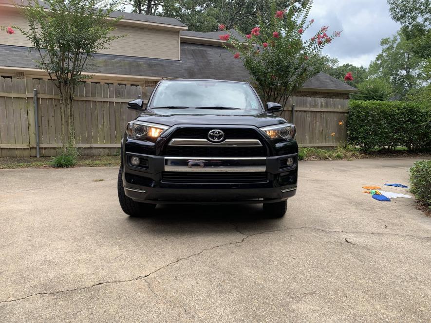

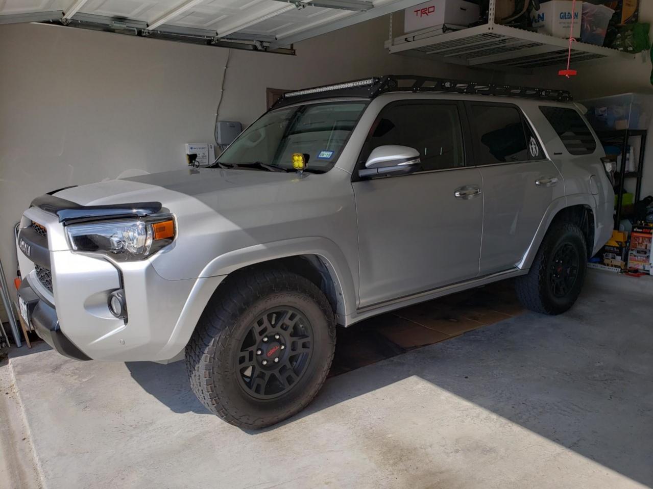

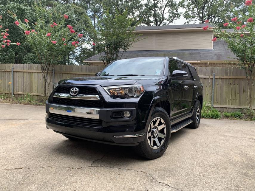

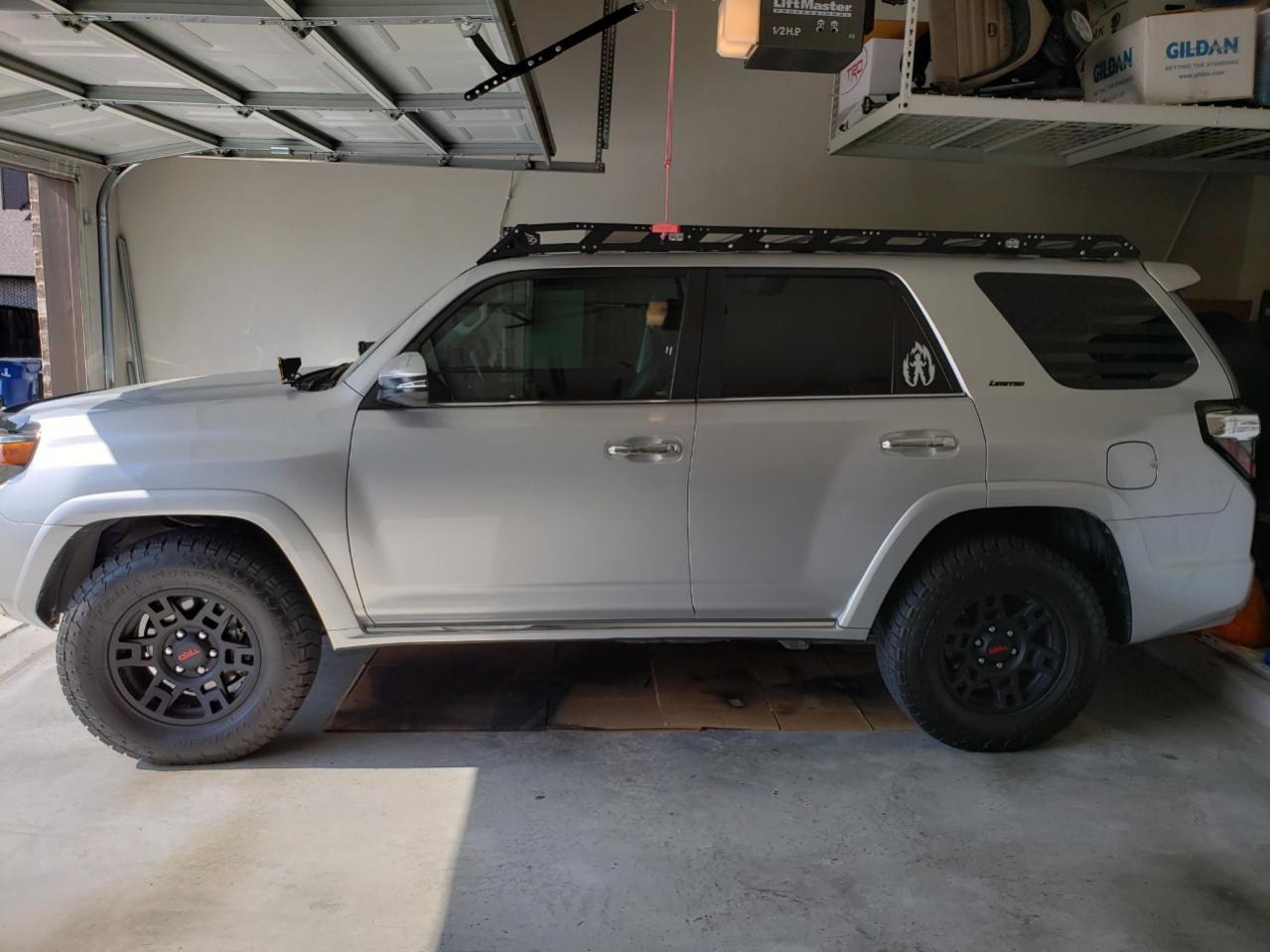

wow that looks great. i'll probably do the same until i get some sr5/trail/pro rockers. those things are like $180 each + shipping.
looks like you did the pro front bumper, did you do the rear too? also what size tires do you have? any lift?
i also plan to do the same to a blizzard pearl as well :happy:
Thanks. I did do the bumper swap. I haven't been able to do the rear bumper yet because I haven't been able to find someone that was selling that lived close enough or was willing to ship. Haven't had any luck with it yet. Tires are just the normal 265/70/17. No lift. Saving up for a lift eventually. I also have a C4 fab low pro bumper with winch just sitting here. Need to find time to install it but hard to find a wrenching partner due to schedule. :cry2:

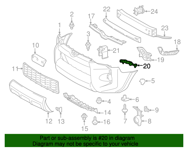

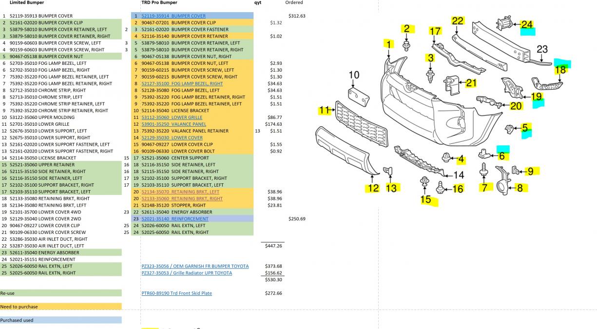

can you confirm the brackets under the lights which need to be swapped are
52134-35070 RETAINING BRKT, LEFT
52133-35060 RETAINING BRKT, RIGHT
thanks :)

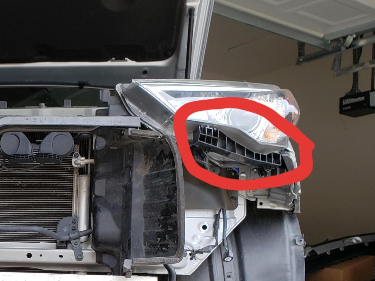

Which bracket are you referring to? There's a plastic piece that runs along the bottom side of the head lamps that don't need to be swapped out. The one's at the bottom front of the head lamps need to be swapped. See photo below circled in red.
There was a forum member selling his trail front bumper because he purchased a full steel aftermarket front end. He gave me all the parts I needed for the front bumper swap. I took it to a local shop to paint and it cost me $480. If you can find a front end with the same paint color, you'll end up saving a lot of money.

the bracket for the right seems correct. oddly, the bracket 52133-35070 on the left does not exist. perhaps you have a typo? i've added the links for comparison.
when i look it up .. these are what i find :)
It should be 52133-35070 retaining bracket left and 52133-35060 for retaining bracket right.
Must be a typo then. Sorry about that. That was the part number that was given to me. Fortunately for me, I didn't have to purchase it since it was included when I bought the front bumper.
thanks. here's my list of parts. some transfer over, some i got used and some i'll have to get new. i'll post a final copy once i actually get a truck :)

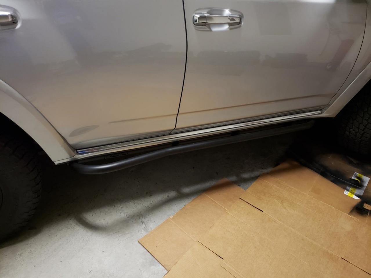

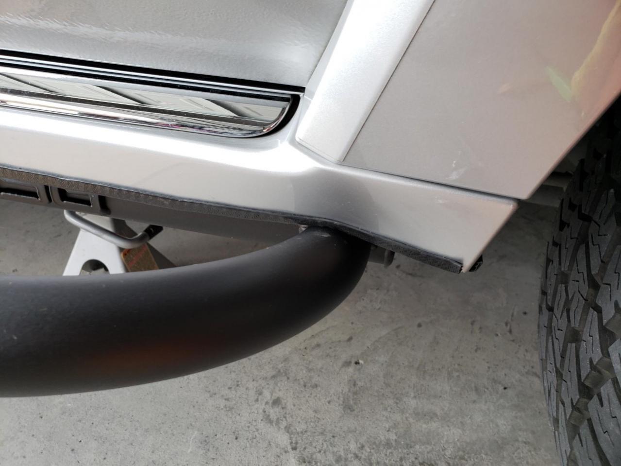

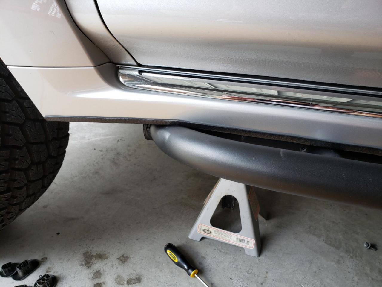

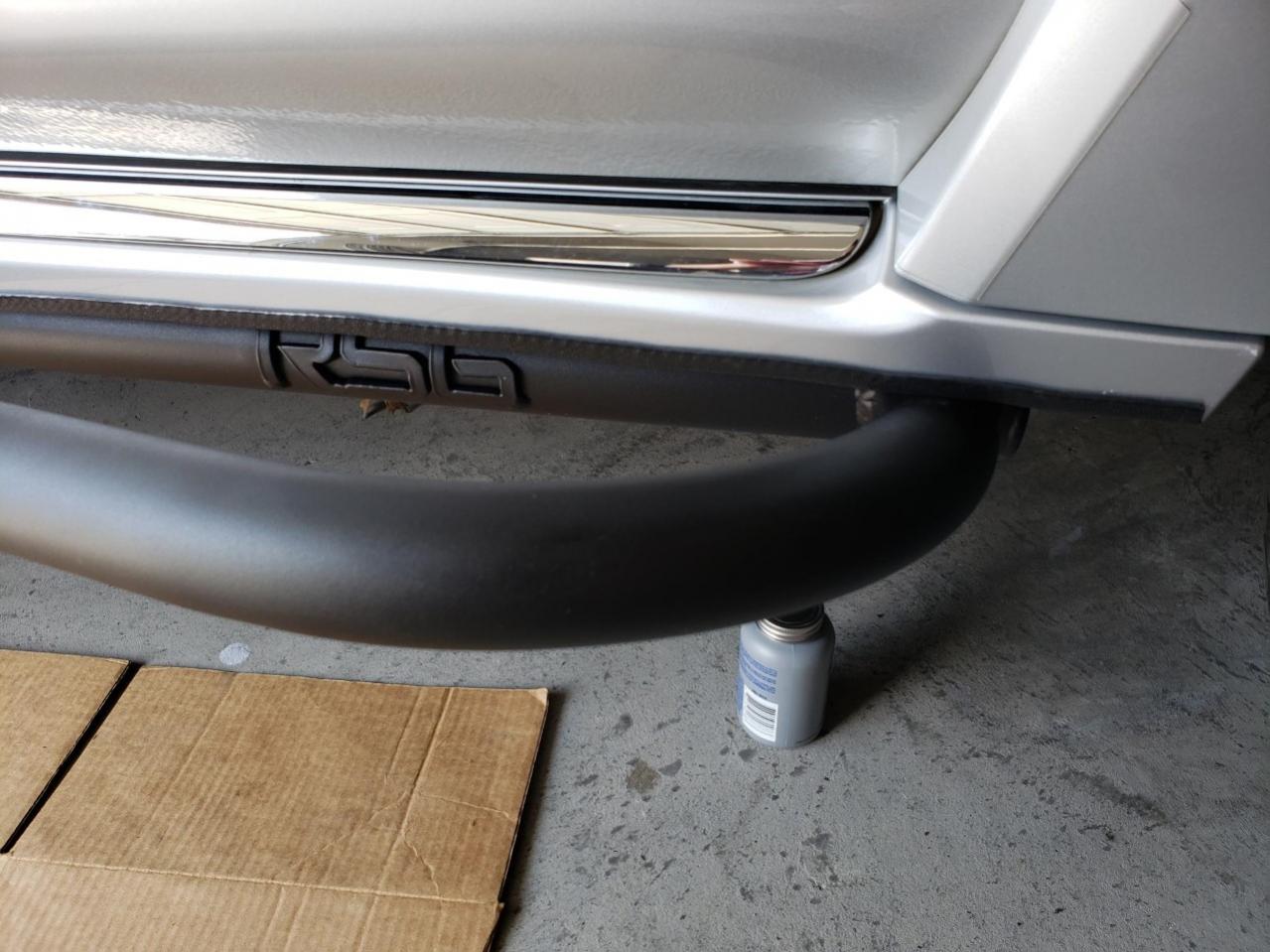

Finally had time to put on the RSG rock sliders on my Limited. It took half the day to get this done. The Antman mod Limited rocker panel cut had to be re-cut higher due to the angled slider making contact with the bottom and pushing up.

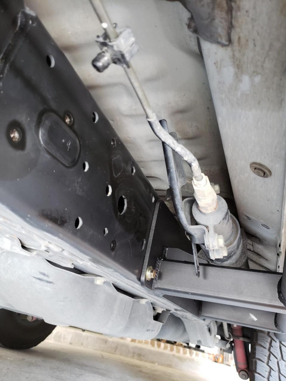

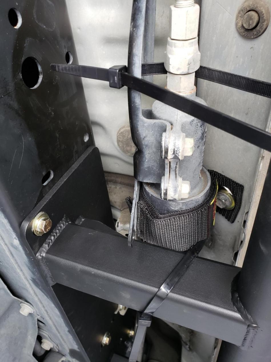

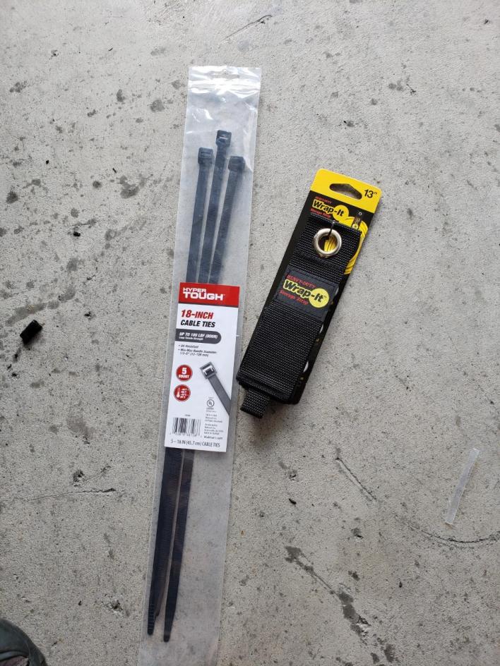

So then I had to trim the rocker panel, re-install, and find creative ways to tie the X-REAS system to prevent movement. I used a velcro strap with grommet and zip ties to create counter pressure on the system and to prevent the lines from rubbing on the gussets of the slider plate and arms. I'm still unsure if this is going to be secure enough. Anyone have any suggestions on how best to secure the X-REAS?

It looks very stable not sure I would be concerned.
You could also find a local shop that could bend new lines for you so you could mount it back to the frame. However you would most likely need to have them create a bracket.
