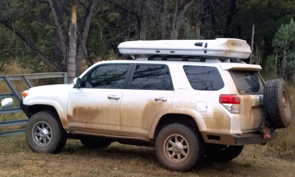

Full Budbuilt skids, bumpout slliders, front and rear bumpers. Close to GVW; offroad 90% of the time now. Reliable and ~17 MPG at 5,000+ feet; but the darn thing won't float. Side2.jpg

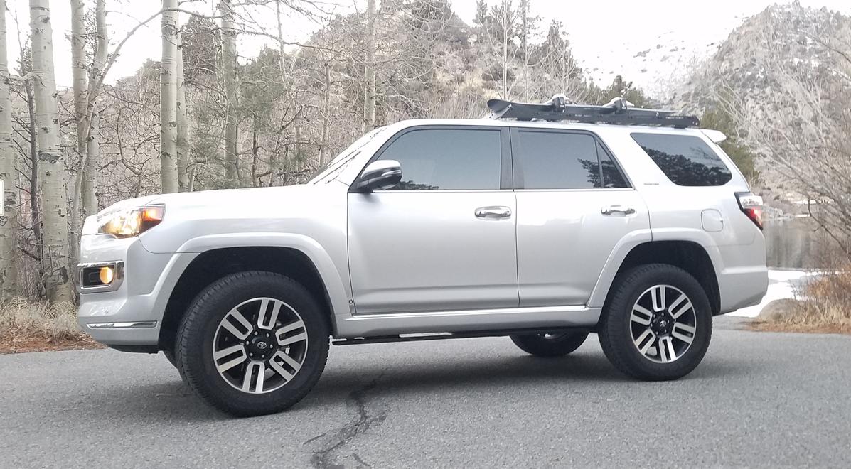

Here's our 2014 LE
XREAS removed, replaced with Sonoran Steel 3 inch lift, 275/60/20 Yokohama Geolander A/T G015, Spidertrax 1.25 waiting to be installed
I considered a spacer lift, decided to bite the bullet and just switch it all out now.
