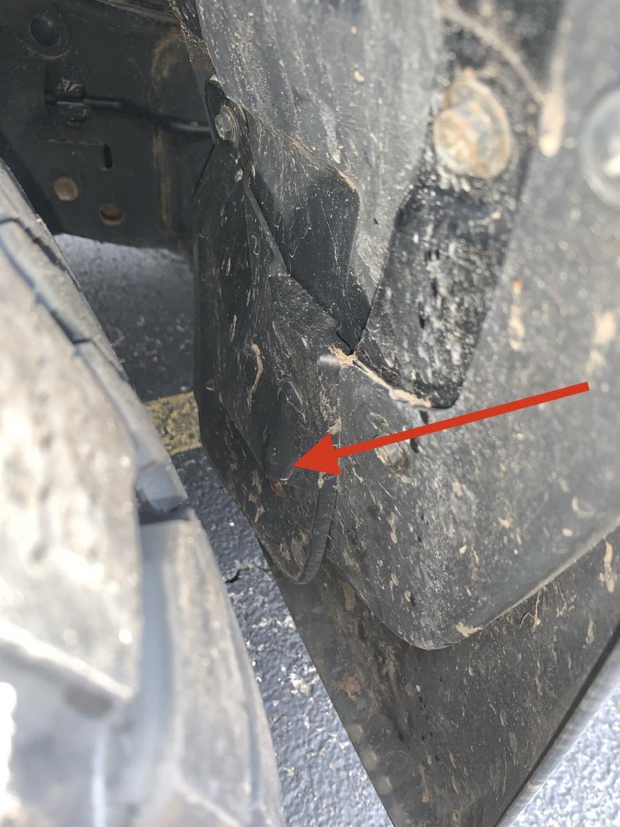

I had 275 55 20 duratracs installed yesterday and have a slight rub reversing in full lock on this plastic tab. What should I try first?
3 options:
1. use a heatgun and melt it down a bit--you wont be able to push it in very far
2. remove that bit
3. get an alignment with more caster
3 options:
2. remove that bit
Thanks. I had a 1inch cornfed installed and aligned prior to getting the tires. Prior to asking the shop to try and get more caster, would you try the heat gun first?
