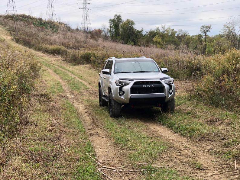

I got new wheels, tires and a lift :-)
Wheels - Oem TRD pro
Tires - Nitto Ridge Grapplers 285/70/17 Load C
Lift - TRD pro Bilsteins and Cornfed spacers 2/1.5
I've been accumulating parts over the past 6 months and got the final pieces in last week.
Tackled this today. Not that tough of a job. I did it myself and it would have been a bit easier with a helper during some steps.
I did the Chinese TRD grill (lights still to do) and I'm not thrilled with the fitment. Granted...it's like a quarter of the cost. Going to try and work it a bit more tomorrow with a heat gun.
You can see on one of the pics how much lower the limited bumper sits compared to the trail/TRD. There is some trimming you need to do, but it's not difficult just a little time consuming.
Also went with the RCI filler plate. I'm happy with the results (once I fiddle with the TRD bar more).

After accumulating all the parts it took me about 6 hours from start to finish by myself to remove and install my bumper. With another person it would have sped things up a bit. I really like how it turned out.
