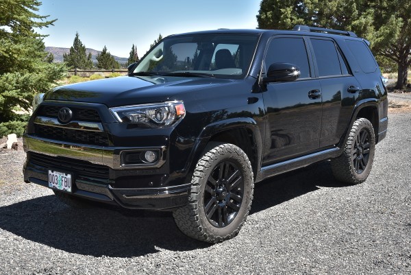

Hello! Just wanted to contribute to the thread. For those thinking about the TRD Grill & garnish, do it! Here's the current state of my MGM Limited. Yellow fog light bulbs, chrome delete (vinyl wrap) + TRD Grill and Garnish.

I'll be following your progress as a fellow Oregonian with a nightshade. I haven't seen too many mods for them yet.
I want to add the trd grill as you did but qith the 2020 it has a.small black box in the bottom garnish do you know what is it called and wpuld I still b able to do the conversion
