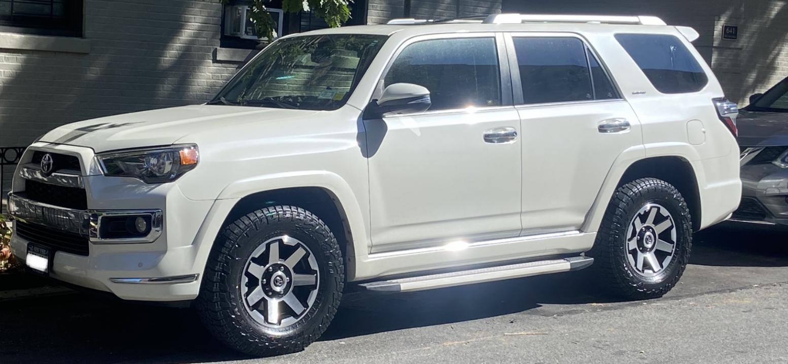

Yep I got a set of 5 take off ORP wheels from Facebook marketplace and 5 new Falken Wildpeaks for only 3-4 hundred more than it would have cost to replace 4 x 20” Yokohama oem tires. I did re use my oem tire pressure monitors so that saved a few bucks for now.

YEs best thing Ive done to the truck to date. I run 17s for AT, MT and Snows. Its cheaper, you have better choice in brands and frankly I dont like the 20s for much of anything.
You can see it in my sig, old pic missing most of the my mods, but zoom in to see the caps and trim panel and you get the idea.

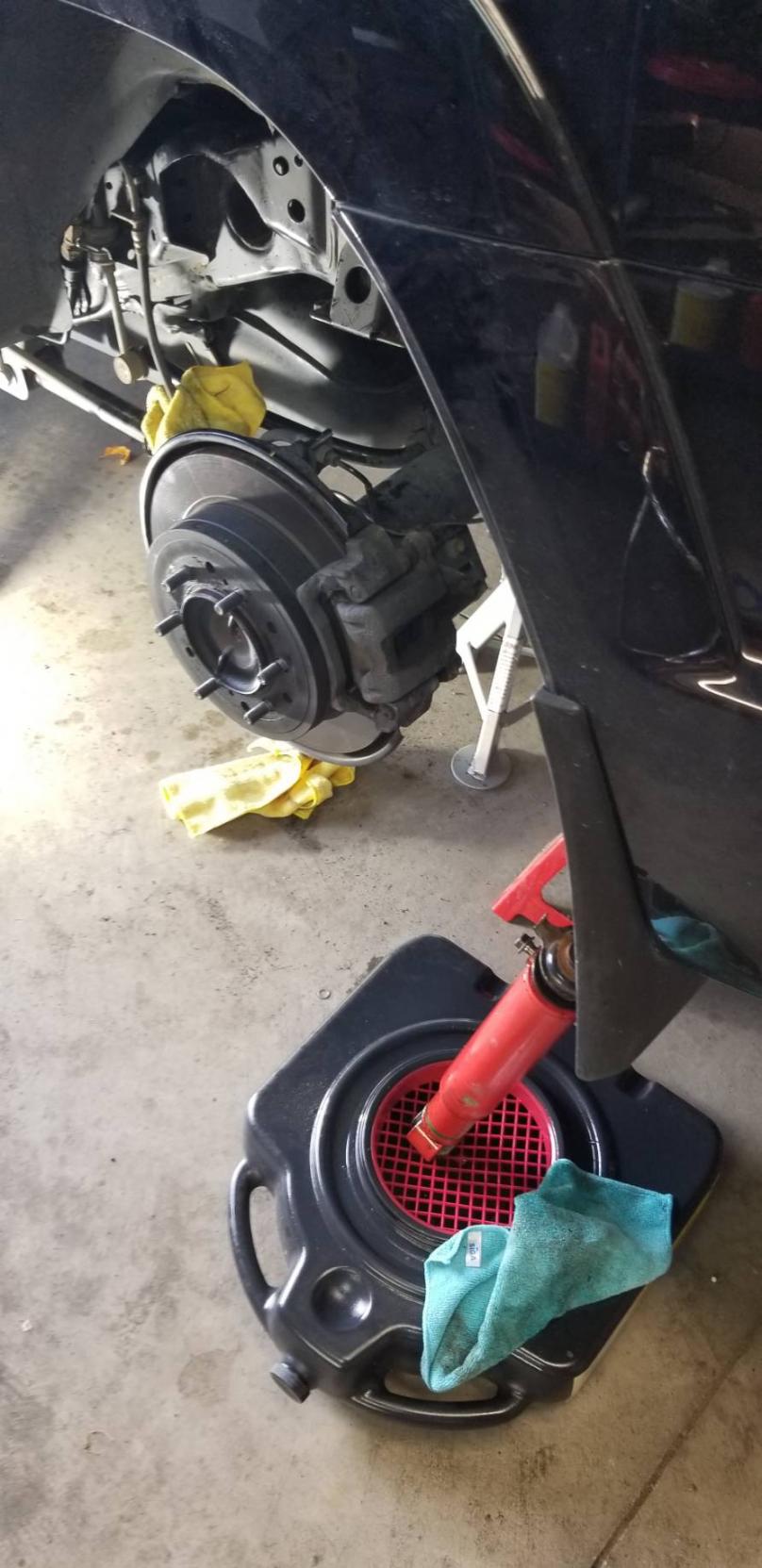

ya when my XREAS needs replacing I don't think I will put in another XREAS. I actually tried to remove it during the parts shortage of spring 2021. tried a few more specialized shops and not a single one of maybe 5 places I called would take my business. no parts and no people available at the time. my first XREAS lasted almost 160k miles though, so I might be waiting a while lol
The connector fittings even with a decent flare nut wrench get really rusty, its tough to remove in one piece. The fastest is use bolt cutters, a rag and a bucket. Once you snip alittle oil comes out, then the hard lines come out in sections, its easier to do than you think. The pressure of the oil coming out isnt to bad. I just put a rag over it and the mess was minimal if any. If you are able to install a new set of shocks, you can easily remove the XREAS.

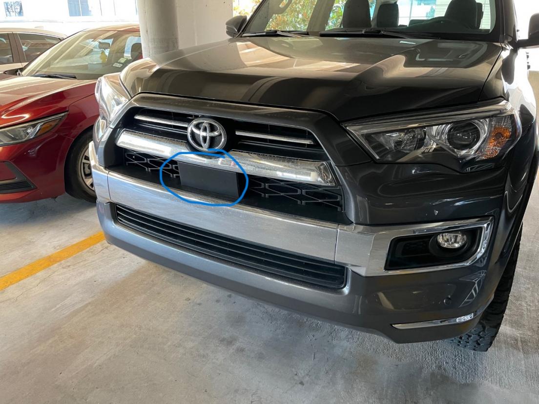

Does anybody know what this piece is on the front grill? I don't see it on any other limiteds. Is it removable? Is it something they only put on the 2021s?
