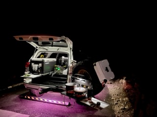

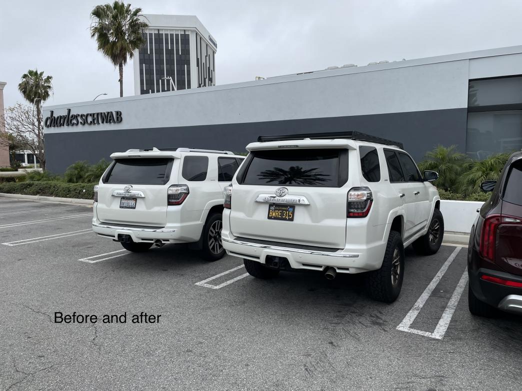

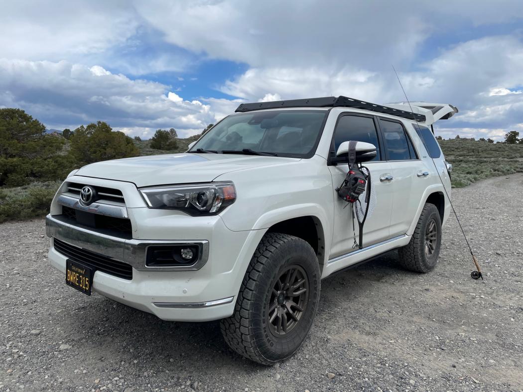

Thanks rockymountaint4r for the redirect to this thread.
Trolled this forum for 2 years. Lots of help. Here’s my build result for those who may find it helpful. Cheers.
Interior
Touch Screen protector
• Brand: WONDERFULHZ 2020+
• From: Amazon
• My Rating: 10/10
• Would I buy again? Yes
Center Console tray
• Brand: JKCOVER
• From: Amazon
• My Rating: 6/10
• Would I buy again? Meh. Prob not.
• Notes: not a fan of not being able to close the console unless the tray is pushed forward. It slides back a lot and is annoying
LED INTERIOR Bulbs
• Brand: AUTOGINE 16 piece LED 6000K
• From: Amazon
• My Rating: 8/10
• Notes: YouTube various install videos before you do this. Then it’s easy. Bright, might be too much for some. Did not install in vanity.
Cell phone holder cup mount
• Brand: CTYBB cup holder cradle
• From: Amazon
• My Rating: 7/10
• Would I buy again? Yes, a tad wobbly tho

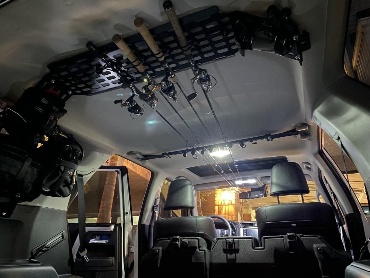

Molle panel and upper Molle
• Brand: Tac1
• From: Tac1
• My Rating: 5/10
• Would I buy again? Prob not, different brand yes, prob would have done rago
• Notes: not the best fit as far as angles. had to bend each bracket 20 more degrees, that’s not easy. Also switched out the 1/4 fasteners for M6s, why mix types in a truck that is metric? Rattles. But. I really like the roof Molle for fishing rods. So. Meets my needs. Fasteners droop, and rattle. I’m an engineer and have ocd. This drives me nuts.
Front camera and rear override
• Brand: Anytime
• From: Anytime
• My Rating: 8/10
Notes: about a 5hr job if you are anal. Wanderlost overland on YouTube helped research. Put center low. Good fit.
Exterior
Tint - Front windows
• Brand: 3M 20%
• From: some guy down the street
• My Rating: 8/10 (decent match)
Roof rack
• Brand: Prinsu, full length no drill
• From: Prinsu
• My Rating: 8/10
• Would I buy again? A rack? Yes. This one? On the fence
• Notes: modified mounting for no silicone. Search no drill no silicone thread for details. I Very much like the prinsu profile vs others. 2” cross bars better for my needs than some others which are 3” a few taps were short, and one of the large fender washers rusted in 1 year. In socal.
Suspension/ Tires / Wheels / Drivetrain
Throttle Response Aftermarket
• Brand: Pedal Commander
• From: Amazon
• My Rating: 10/10
• Comments: city 2 setting. Game changer
Suspension
• Brand: Bilstein 6112/5160 @ 2.75”/2.0” height + SPC UCAs
• From: Bilstein and OME, via 88Rotors in LA
• My Rating: 10/10
• Would I buy again? Yes!
• Comments: Really like the balance of city/off-road. Was XREAS which honestly was not bad. Super plush on washboards.
Tires and Wheels
• Brand: Icon vector 6, Toyo AT3 P285/70R17
• From: Icon, Toyo via 88Rotors in LA
• My Rating: 10/10
• Comments: quiet, combo same weight as stock. Required fender liner mod, mud flap delete, and for me a BMC. I think I could have pushed the caster forward and avoided a BMC but, now any idiot can do an alignment without worry.

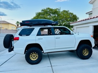

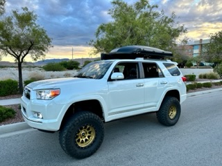

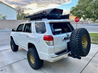

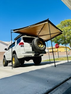

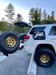

Here’s my 2013 Limited, 35” Toyo MT, 6” Fabtech lift w/Dirt Logic, Eaton E-Lockers, 488 Gearing and a ton of overland gear ️

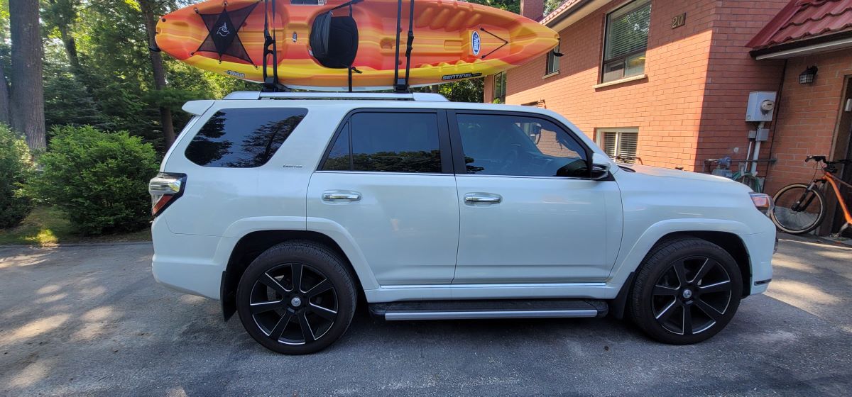

I went the other direction. So far 22", crossbars with kayak holders, interior matts, some of the fake carbon fiber covers on door handles, and centre console, wireless car play, front and rear dashcam:
