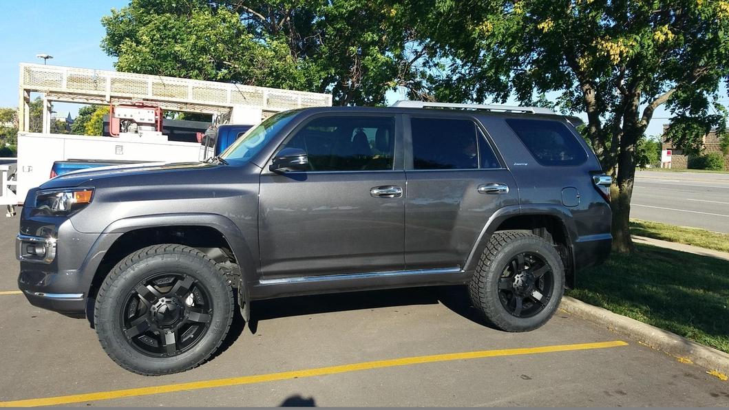

Cronfed 1.5 x 2. Spider trac spacers. Wild peek 275x20s on stock rims. I had to do a small amount of fender trimming but everything fits and I believe looks great. Just wanted to post for anyone else searching stock 20's or tire size for the leveling kit as I did a month or so ago.

Nice looking LE! How much fender trimming did you have to do? After I had the spidertrax installed, the tires rubbed left and right while going forward and back. After I did the heat gun mod on the front fender lining, it solved the rubbing when going forward but still get rubbing on both directions when backing up.. think it's the plastic piece the mudguards attach to. Not yet ready to trim that piece off just yet!

I get just a small amount of rub in reverse either direction just as you. It's not enough for me to keep cutting, since this is the wife's ride and we will absolutely do no off roading I can live with it. I think I will let the tires wear out the hit spots and call it a day. I was most worried about the tread grabbing a plastic piece and causing a big mess, but with the trimming and clearance I see it should not be a problem.

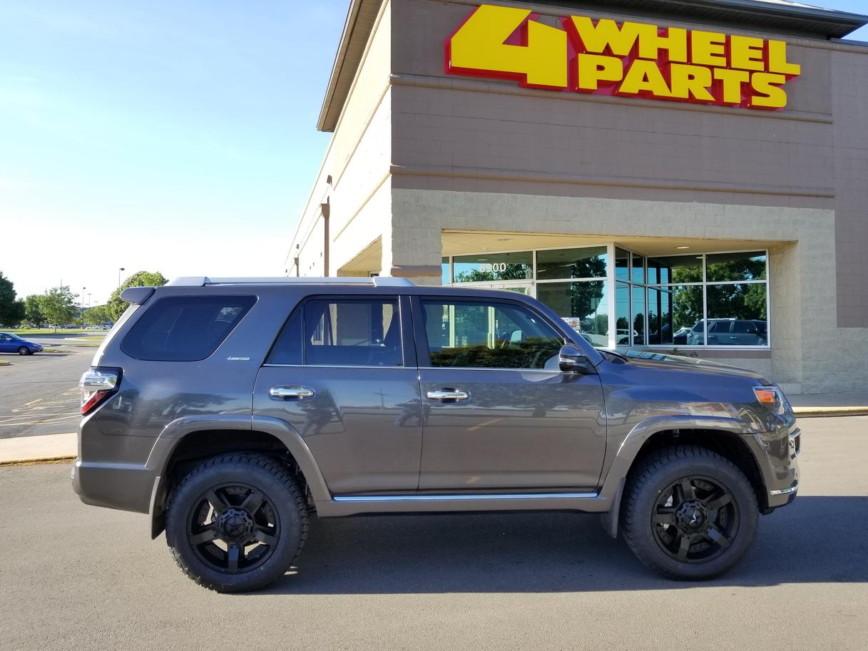

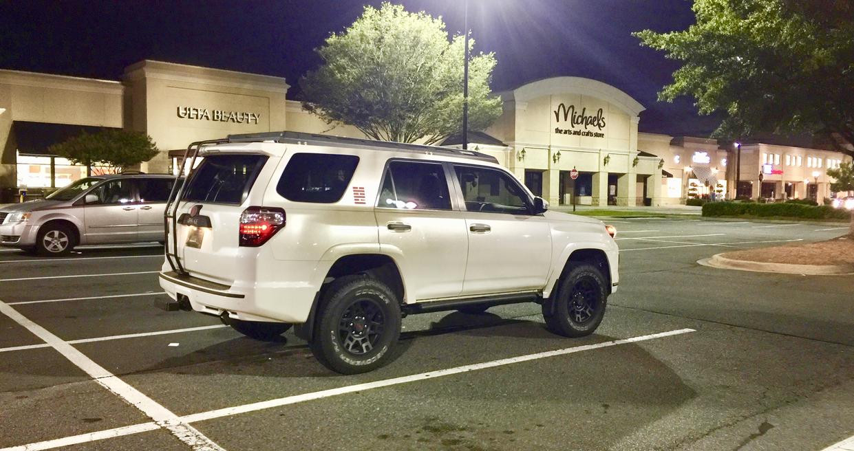

Had a 2.5" Daystar lift, 20" Rockstar 2, 275X60R20 TERRA Grappler2. The front isnt leveled with the rear, its bugging me a bit, but oh well.

Doesn't look too bad from the pictures. You will be happy when you are loaded with camping gear and people.

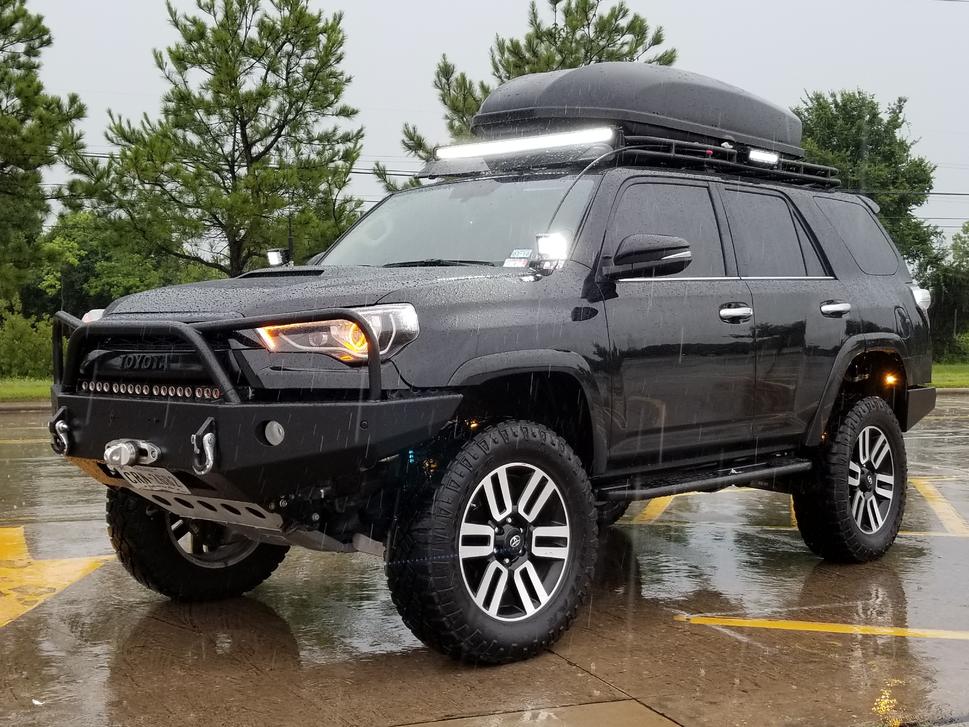

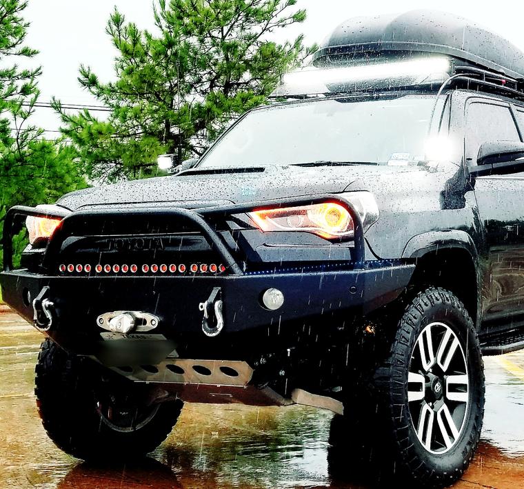

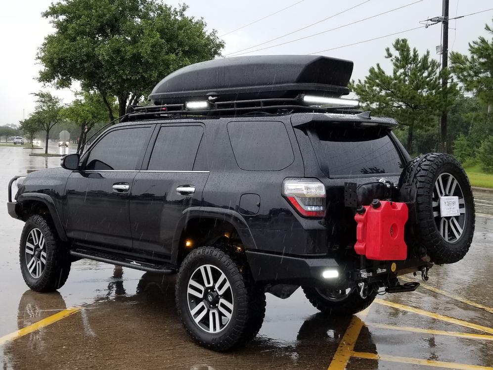

Trying out the Skybox 21

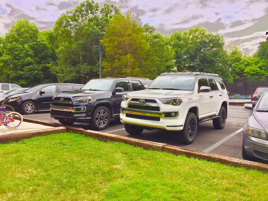

Put some Cooper Zeon LTZ 275/55R20's on today with 20x9 0 offset wheels. What a difference. Everyone was right on about it being more planted on the road, not to mention it looks like a truck now.
Put a 2.5/1.5 leveling kit on a few weeks back and am super happy exactly the way it sits. Of course I wanted to go bigger and more aggressive as we always do but even with this setup I get a slight rub on the mudflap with the wheels full lock in reverse. No complaints though.
