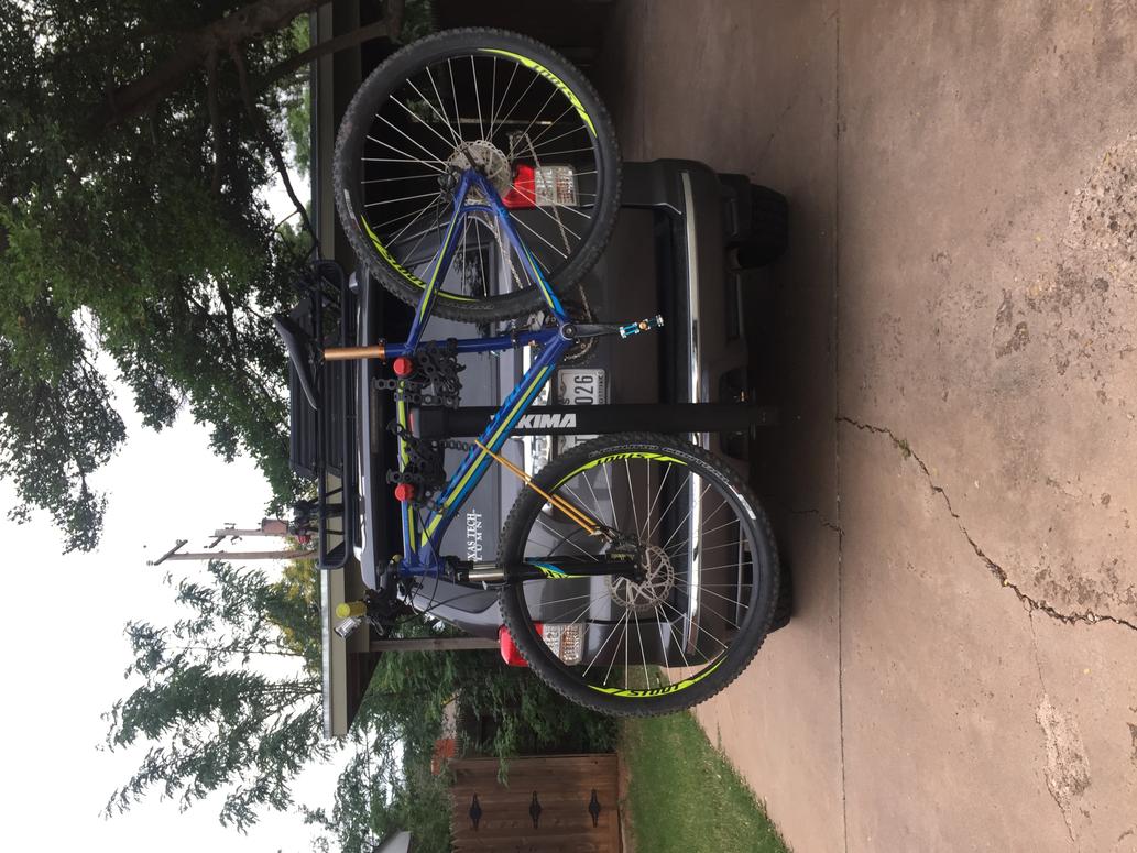

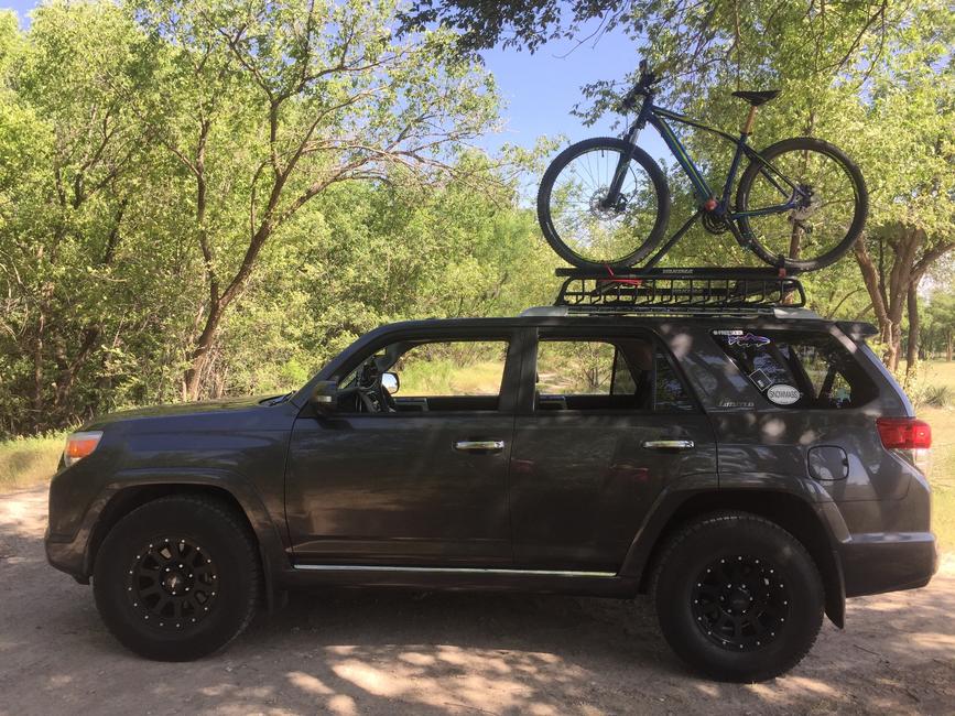

I'm digging all the mods you guys have posted. I purchased my 12 LE about two months ago and I've been gathering ideas on what to do with mine. I got rid of the 20's and put some 17's on. I also removed the running boards. I'm doing the Daystar 2.5/1.5 install soon since the XREAS is fine. I had the Yakima Megawarrior with ski racks so I threw it on there and just recently ordered the double down 4 Yakima as well.
