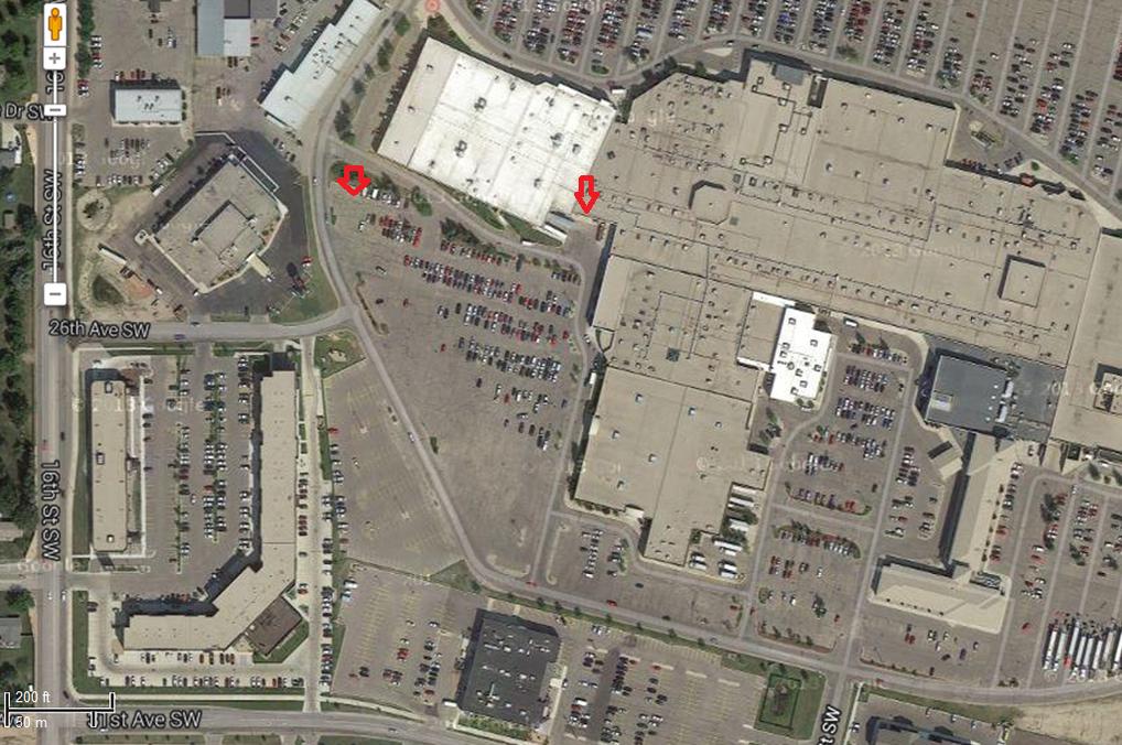

the warden has a compustar prime series 2-way 9000 remote starton her 12 DC Tacoma. havent had any issues with it, has about 500-1000k ft actual range with obstructions like buildings. with her situation, she had to remote start it inside the store back door (metal) and its about 500 ft. and it would start.
only issue i have is the remote fob cant keep time, but that is the only issue.
i have made a picture of inside the mall back door of where she worked and the distance to where she parked marked by the red arrows.
