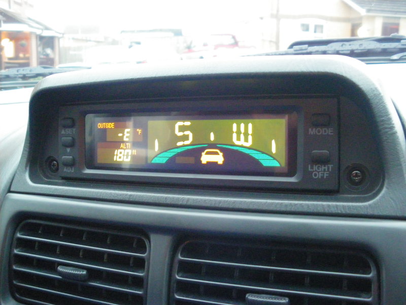

It has Inclinometer/Altimeter/Temp/Compass
Seller wants $140. Is it worth?
Just like whats in the picture.

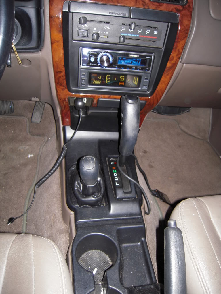

This is how it would look in a 4runner.
It has 5 wires
1 = Ignition
2 = Illumination
3 = ground
4 and 5 = temp sensor. That's it.
I dig it, but I wish there was a better place to mount it. All the way down there is way out of your field of vision, so that really limits its usefulness.

Just a thought - since I've read that the Subaru field monitor is closely related to the one installed in JDM Hilux Surfs, has anyone tried comparing the size/shape of the display? Maybe you could combine them, which would put the Fahrenheit Subaru unit up high.
Are you interested in an auto dimming rear view mirror with compass, thermometer and the outside sensor? I can locate these fairly easily. I got mine for $70.
Forester unit is same as the hilux surf. The bezel is whats different.
