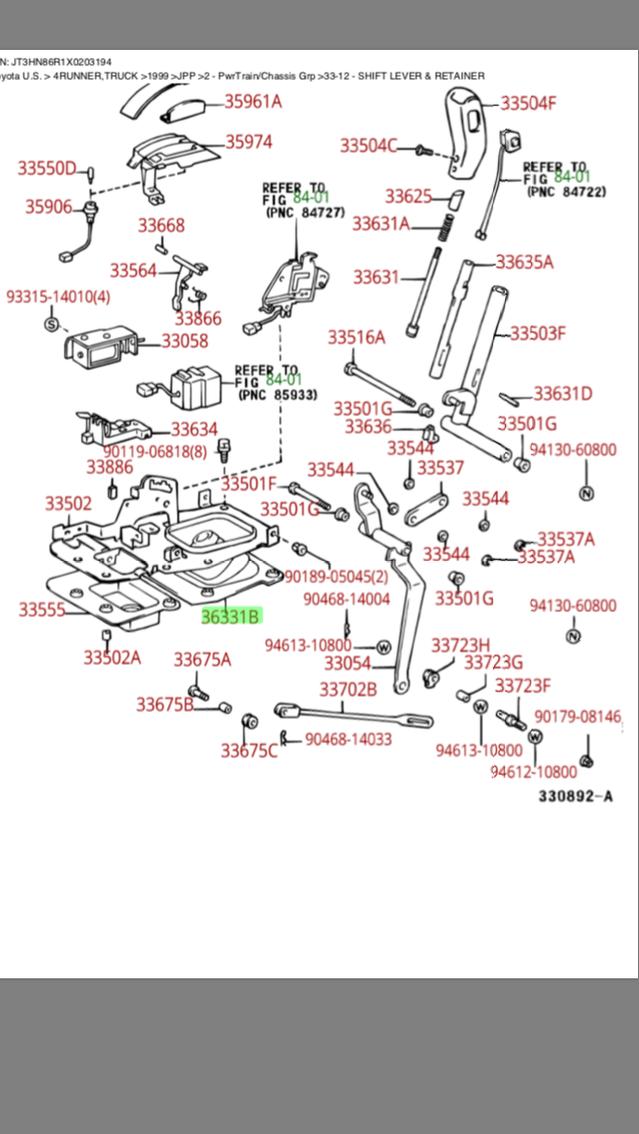

Automatic transmission 4wd. I'm trying to find and order this part online, but I'm having trouble locating it. It sits between the shift lever assembly and the body. The one I'm trying to replace is torn. I've checked the diagrams in the FSM (http://tacoma.site40.net/4Runner_96-02_Repair&Wiring/techinfo.toyota.com/ileaf/02toyrm/02toypdf/02rmsour/2002/024runne/at/atua340f/comp.pdf) with no luck. When I do a search for boot the only things that come up are the transfer case boot (part# 36331-35010) and the transfer shift lever boot on the front console upper panel.
Could it be the "Shift hole cover"?
I have been looking for this part for days to no avail...this however was not the right answer for me. In particular the boot I was looking for was the rubber one, not the one ON the transfer case, and not that faux leather inside the cab. The rubber one that goes in the hole, looks like an accordion. Here is a parts diagram for further help for anyone else.

Im trying to follow along here, I think that the OP back in 2014 was looking for the rubber boot that actually goes on the shift lever??
Im actually looking for the rubber boot that "looks like an accordion" as well for the transfer case shift lever. Did you have any luck in finding that?
So I think I'm looking for the 33555 part, which is discontinued. It's ripped, and needs replacing. What do y'all do for parts that are d/c'd? Thanks!
I know this is an old thread.., but the auto shifter dust boot is #33555-35160 and is yet available.
