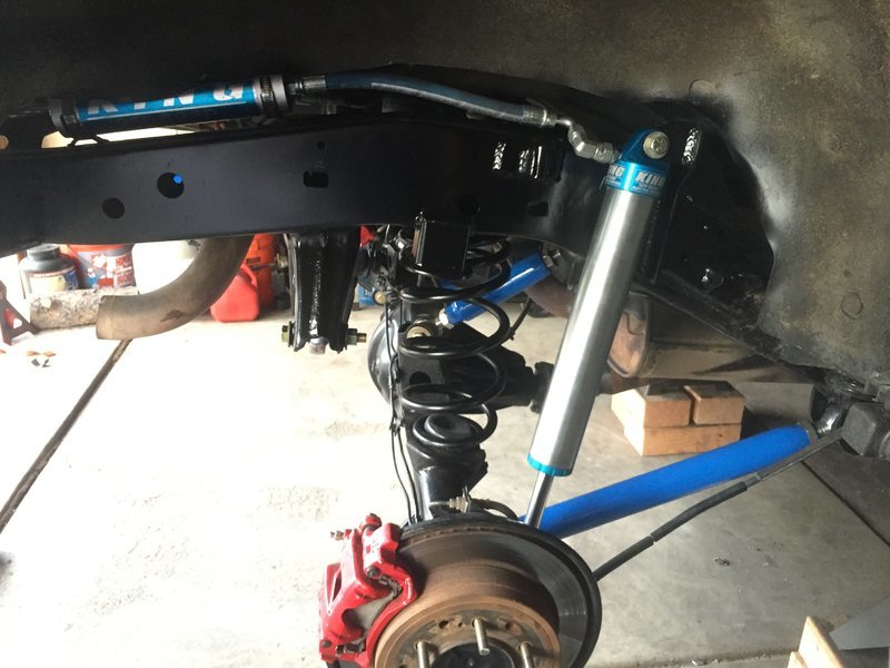

How are you liking the bypasses? Have you played around with adjusting them or were they good out of the box from Filthy Motorsports? I bet you still have a ton of room in the wheel well with the aftermarket wheels and wheel spacers even with the bypass tubes and remote reservoir?

Bypasses have been great. I have adjusted the tubes a bit, both compression and rebound.
With the 2" spacers on the rear it makes good amount of room for the tubes, but i had mine clocked to be indexed this way because originally i had planned for the mount to be different. Once we got in there and cut it made more sense to make it mount this way. If i were to go it again i would index the tubes differently.
Personally i use all of my 10" stroke and i dont see how or where i could get more travel either way if i had gone 12". So me personally i think its a waste.

Yeah I've read your threads, cool stuff. Would you still have room in there if you raised your shock up an inch or two more? They would need to go outboard a bit to clear the wheel well. Your 12" shock is the biggest that can still have the threaded over top cap option so you are shorter by 1" than any other bypass or 3" shock. I'm debating between your short 12" smoothie, a 1" longer 2.5" bypass shock, or a 3" smoothie. And 10" or 12" on the last 2 options, I'm sure you like your 12" of travel but a 10" would be easy to fit and would I really miss that 2" of travel at the shock?(my dumb emotional side that fuels my mods says yes I would miss it).
I know they are all overkill because even my standard length RR 2.5" rears are "fine" but more travel over the rocks would be nice.

Yeah, I think I could have gone up another inch if I had angled the shock tabs , but then I was running into contact with the rest of the mount on the shock body, but yes if you fanangled with the mounts a bit more could be achieved. The lower mounts are where the magi happens though to get the 12's in there, without dropping them from stock (I don't recall how much further down they are than stock) you are not going to get full compression.
I think there was a guy on 120 that did 12's with the post and stock lower mount as well, but the problem is with longer shocks you are flexing them more side to side and post mounts don't like that, I personally wouldn't run a 12 with a post. Yes I know people do it, but post break easy and often if you are hard on them.
As far as missing the 2", IDK, hard to say but, but if you are doing a full custom job and all new lower mounts, might as well do 12's. I think Sam did a hybrid of a new upper mount and using the stock lower mount with shock tabs welded on.
3" shock would also be super overkill and would likely result in a rougher ride.
I would imagine they could valve it any way I wanted, though it may be a little tricky to get it correct on the first try without a baseline in the 3" series for our trucks. I would talk to them first before I order but a guy with a GX470 has them on instagram.
