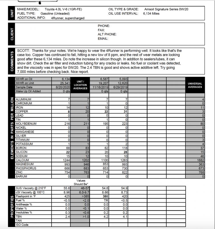

Second Blackstone Oil Analysis with Magnuson S/C 19K miles
Hi folks,
Happy Thanksgiving. We had a few decent weather days 2 weeks back and I swapped out my oil (Amsoil Sig Series 0w-20) in the driveway.
I'm not going to post any update experiences to my S/C as nothing has changed from my previous posts. It's not yet cold enough to see if I will still get a few seepage leaks/drips from the spring clamp on the coolant pump. I've swapped out the other resi clamps and upper radiator coolant clamp and I'm seeing zero drips/seepage. Still zero regrets.
Please find attached my second Blackstone oil analysis. So far....things are looking great.
S/C Blackstone Report 3. 25K plus miles
Hope everyone is doing well.
I recently sent out my third sample to Blackstone for analysis and posting the results.
With regards to how I feel about the S/C...still the same from my previous posts. I'm still very satisfied with the purchase and performance.
I changed tires over to Cooper AT34S at around 24K miles and observed a slight increase in MPG. I'm now averaging between 16.7-17.1 MPG with mixed driving. I still do not have to go over 3400RPMs to get moving. That seems to be the sweet spot in the power band. With the Contis I dropped down to the mid 15s MPG.
Interesting about the comment on the silicone and having me check my air filter. I switched over to K&N at 15K miles on 9/2019. I'm going to switch back to OEM air filter.
The truck is running great. Zero issues. With anything.

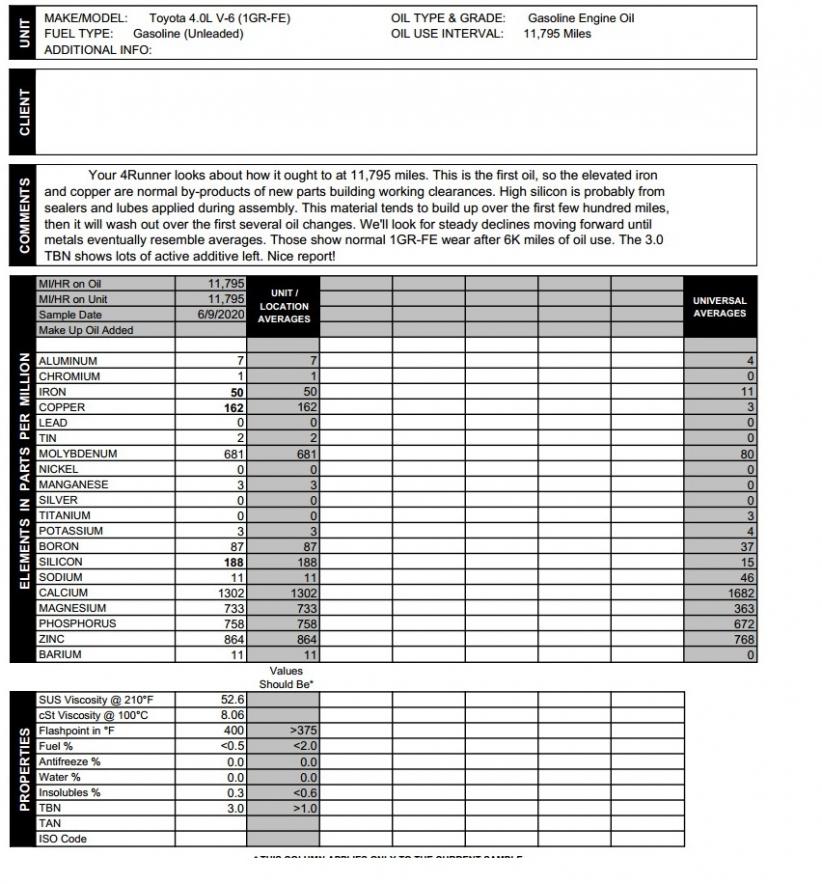

here is mine
I installed S/C end of March 2019, here is my first oil report
