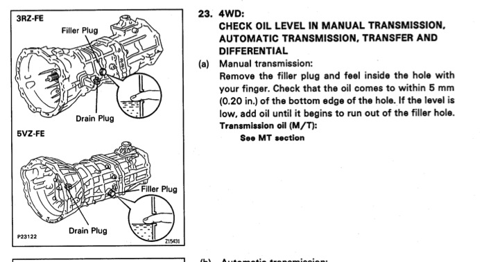

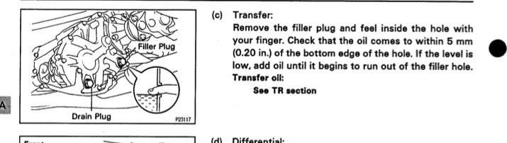

These are from a '96 Tacoma, but should be the same.

Is this a misprint or is the drain plug for the 5VZ transmission higher than the fill plug :suspicious: That's going to be one PITA drain and fill procedure...
Yeah, the Toyota drawings aren't very good, compared to the clear, sharp, perfectly processed and reproduced photos in the VW service manuals.
I think it's trying to show that it's on the bottom, but I don't remember from my own 4Runner since I've only had to change the gear oil once, about one year ago. Also, my truck sits about 150 feet away and it's nighttime and I've already taken a bath.
have you looked under the vehicle yet? I changed my transfer case and they were pretty basic to find the drain and fill plug. I used a 15/16ths and the only two bolts that fit that were the drain and fill. haven't done transmission, and am interested.
128865d1409469693-manual-xmsn-transfer-case-plugs-screen-shot-2014-08-31-12.19.08-am.jpg
Not a miss print it's on the far side. The illustration does a bad job at showing it though. It's a pretty straight forward task to do all the gear oil swaps I just did mine about 3k ago.
