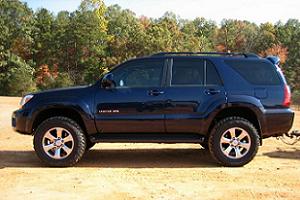

Just posting a small pic so I can get it on the main page :)
Wow that truck looks fantastic! You crazy people are slowly selling me on the 4th gens. I didn't like them AT ALL before I joined this forum! :bigok:
Nice truck
Great combination of lift and tires. Where did you get the spidertrax spacers and what was the cost? I assume the front and rear are lifted the same amount?
