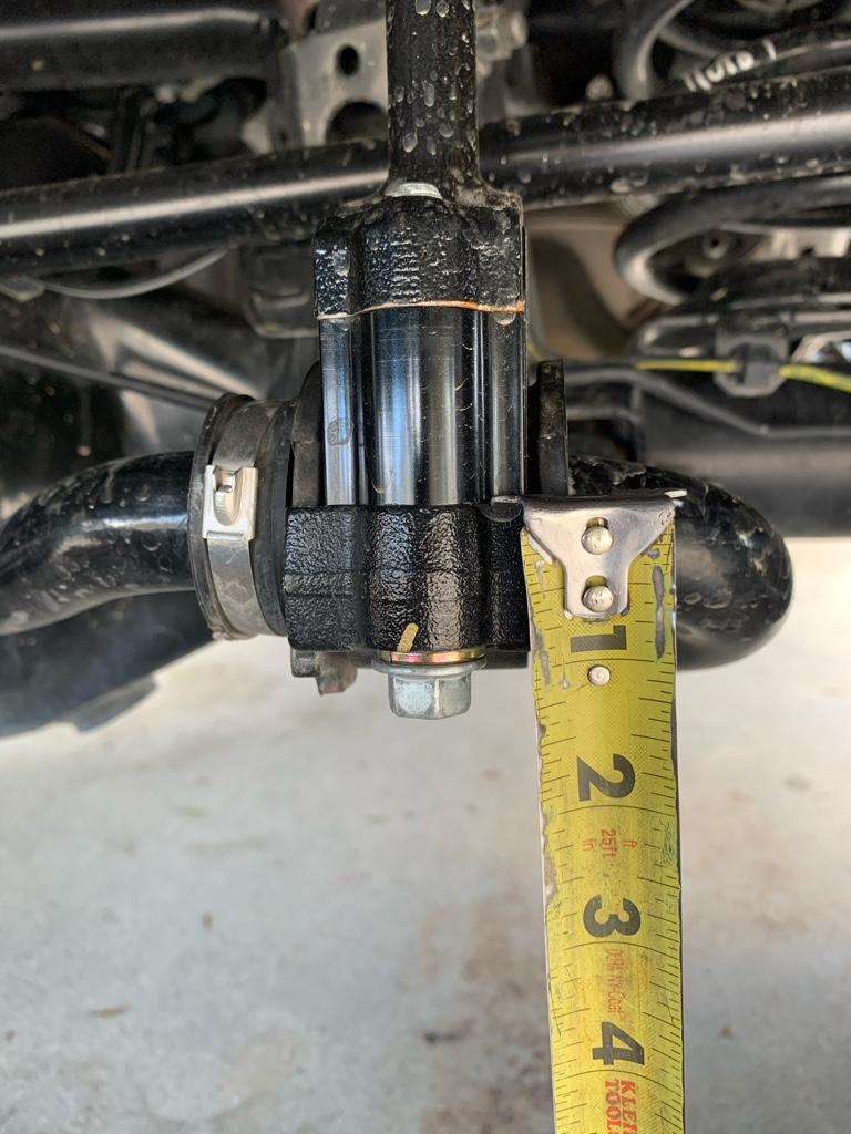

Here’s another thing to check before you install the blocks. I have discovered that Toyota has variances in the cap that bolts on under the sway bar. If it is 7/8” thick then you are fine with the hardware we provided. If it’s thinner (11/16”) then you will need to get a thick washer to put under the lock washer we provided. These variances that I discovered are all over the board. Yesterday I did a 2019 ( manufacturing date 2018 ) and it came with the 11/16” bottom cap. I’ve come across 2015 and 2016 manufactured 4Runners and they have the 7/8” thick bottom cap. The kdss drop blocks are a perfect fit in the 2010-2020 but the bottom cap having variances creates the issue with needing a 80mm long bolt or 70mm bolt. Of course you can buy new bolts for it. Which I hate for you to have to do. But we will be providing more washers for here on out.

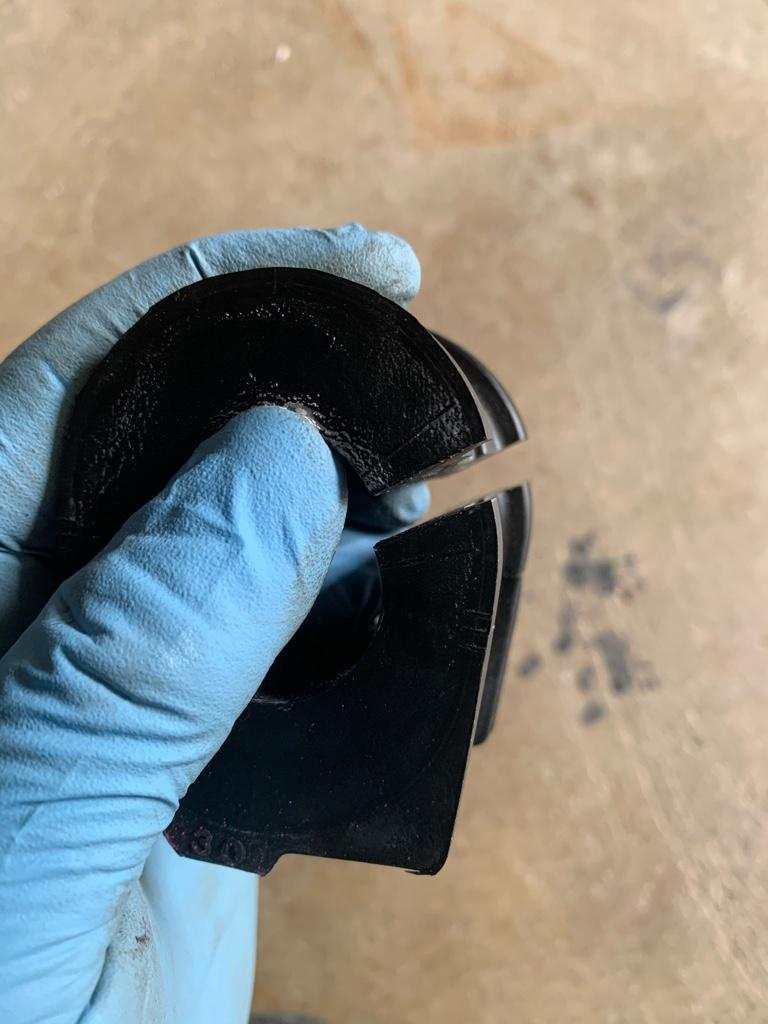

Glad you posted this. My bushing was gone. The clamp that holds it on is there but the bushing isn't. And the clamp is not adjustable to I guess I have to cut it off and put on a clamp that has a screw down clamp?
No you can actually take The bushing part off the sway bar. You just gotta drop the sway bar get it on the ground. There’s a seam you split open. That clamp / strap holding it there stays there.

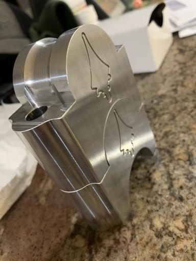

I cut the new batch a little different. Specs are the same. Just the top part I had a form cut tool made. So instead of a slot of top, it’s formed to really key into the end link.
