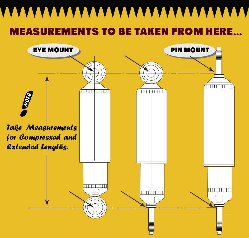

And last where are you taking the measurements from ? Kings kdss shock for the rear is 24.5” and doesn’t make contact.
The standard way. From the base of the pin to the center of the lower eye for rear shocks in this case.
