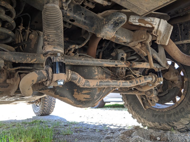

Maximize your KDSS + extended travel shocks
You may be right I'm not certain part# is 48818-60080
Yea, I got mine in from Amazon, definitely for the non-KDSS swaybar. I think I can return it and get the right one.
Got my blocks in a few days ago. Might install this weekend or wait until next.

Dom figured out how to deactivate KDSS via a switch. He'll be ready soon to go into production. He has some info on his website
Hi, What exactly is "his" website address please. ...Went thru all the post here and this is the first one I read that says he has a website, thanks.
Do these help with the KDSS lean after lifting at all? Or is the lean only cased by the lift its self? I cant wait for that on/off switch to get released.
It's seems to me that most of the lean is from the front. All I can say is . If and when it dies And I can't get it repaired for cheap... KDSS is getting disconnected and I'll figure out the way to turn off the kdss light.
But as of right now... With only 43k on the clock. Ill enjoy the mods Dom is making for us...
I believe those who have removed it just pulled about the dash and pulled bulb for the KDSS light.
