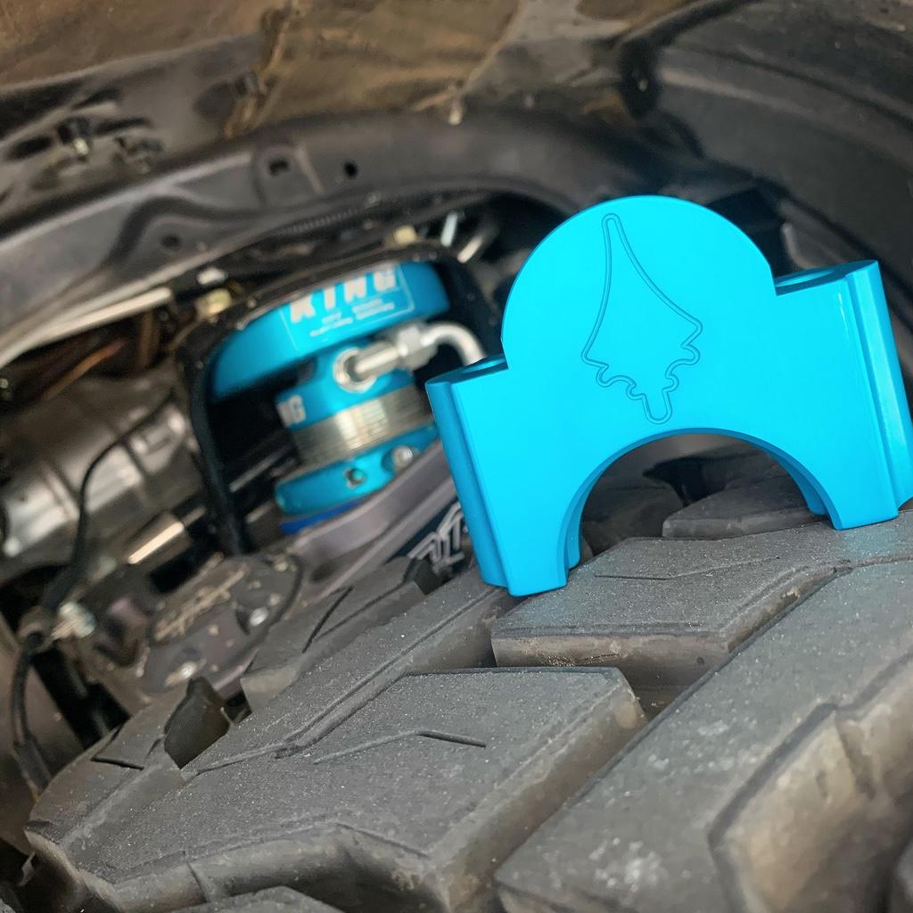

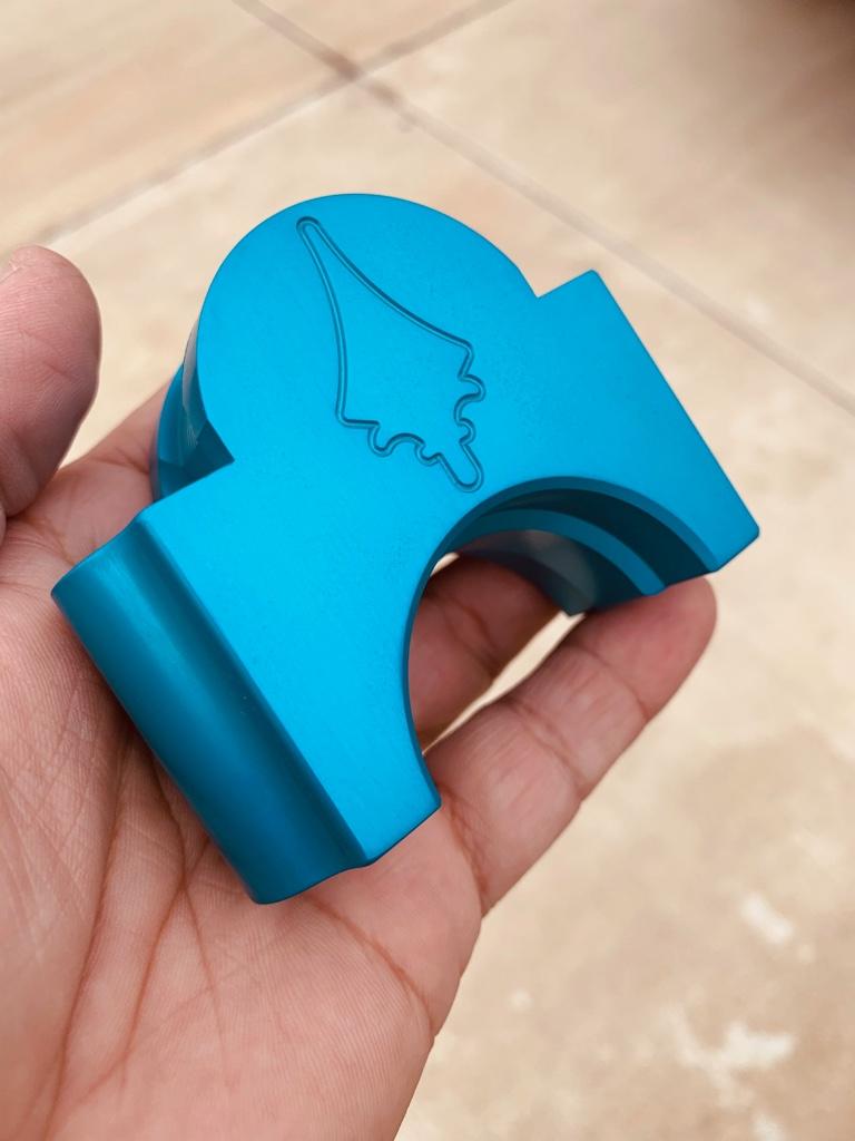

I’m working on a stage 2 that will allow for up to a 29” shock full extended. For now it’s safe at 26” with stock track bar. If you use my track bar ( not released yet) you can do 27”.
Also 2nd rum of these just went to anodizing. Should be ready by next week.
