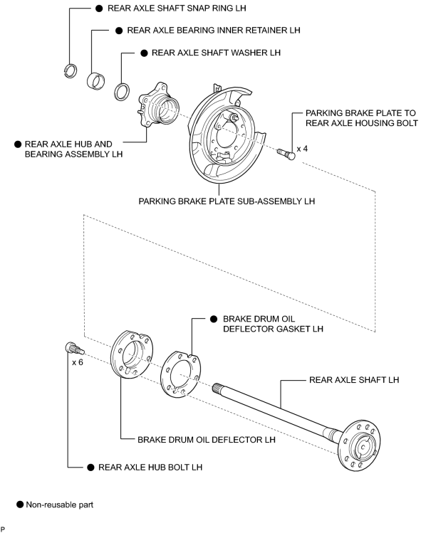

The rear wheel bearings are a sealed non serviceable assembly on our trucks.
Looks like a PITA to change. It's held on to the axle housing with 4 bolts and the axle shaft itself which is an interference fit with a snap ring and retainer has to be removed first to change it out. They aren't cheap either at $300 or more per bearing assembly.
Looks like this.....
